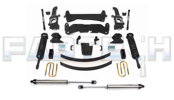

    FABTECH
    http://www.fabtechmotorsports.com/
    Basic Kit - with strut spacer
    Part Number: K7019
    Performance kit with Dirt Logic 2.5 Coil overs & shocks
    Part Number: K7020DB
    FABTECH Installation instructions: http://www.fabtechmotorsports.com/pdfs/instructions/Fabtech-install_FT26026i.pdf

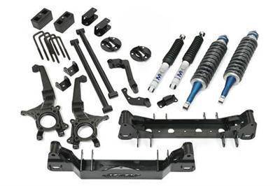

    Pro Comp
    http://www.procompusa.com
    Basic kit with strut spacer lift
    Part number: K5080B
    -trying to locate accurate parts picture-
    Performance kit with Pro comp MX2.75 Coil over with MX-6 rear shocks
    Part number: K5073BMX
    Pro Comp Installation instructions:
    http://www.procompusa.com/downloads/PDFs/is/57096B.pdf

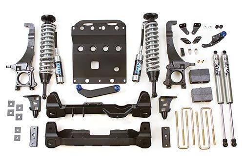

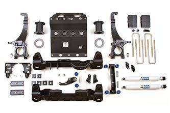

    BDS
    http://bds-suspension.com/
    Basic Kit with strut spacer lift
    Part number: 815H
    Performance kit with w/ Fox 2.5" coil-over remote reservoir shocks and Fox rear shocks
    BDS installation instructions:
    http://bds-suspension.com/instructions/028601.pdf

    • All kits require cutting of the front crossmember and welding in filler plates if the truck is 4WD. Pro Comp and BDS require additional welding of steering stops, Fabtech does not.
    • Depending on your tire size, a cab mount chop may be required.
    Which basic kit is better?
    • All of the basic drop bracket lifts serve the same purpose, there are no known issues as far as I know with any of the kits quality or design.
    • The deciding factor for most people is pricing, and free shipping availability.
    Main differences in the basic kits:
    • BDS only includes rear lift blocks. Fabtech and Pro Comp include AALs (add a leafs) and Blocks.
    • BDS has a slightly larger front differential skid plate.
    • Fabtech requires less welding or no welding if your a prerunner
    Which performance kit is better? Same differences apply as the basic kits with rear suspension, welding and skid plates.
    • BDS is the only company to offer a popular "name brand" performance coil over other then their own branded product. Fox racing remote reservoir coil overs and rear shocks (non-reservoir) with their performance kit
    • Fabtech and Procomp coil overs are a major improvement over strut spacers with stock components but fall short in performance compared to the Fox's. They are still a viable option for coil overs for an "out of the box option" instead of a custom built alternative or going with the BDS performance kit.
