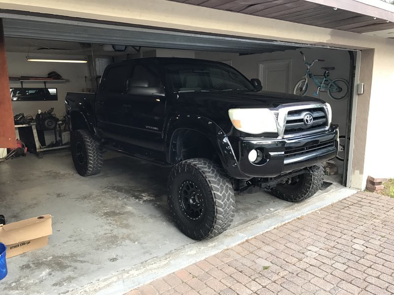

    IMG_0777.jpg Question i want to replace my front lower ball joint and sway bar Stabilizer Links . But OEM is not available and was wondering what you guys where using with your lifts . I can't afford LCA way out of my Budget and Pro Comp has been good to me by keeping my OEM parts working good . But I think is time to change I have 160k on bushings and Ball Joints .
    Any suggestions on keeping OEM or Moog?

    Replace the entire LCA with something like Dorman or Moog. You get bushings and ball joints, less the intense labor. They will save you money in the long run. Cost to purchase and replace ball joints and bushings is insane.
