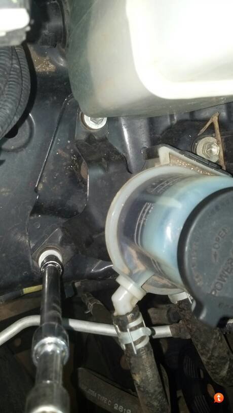

    well here's my first write up, i fabricated a plate bumper and it worked the first few times i had it on, but after i painted it i put a hole in my high pressure Air conditioner line near the condenser.
    Tools you'll need​
    • 2 Flat-head screw driver
    • ratchet
    • 10mm socket
    • 12mm socket
    • 14mm socket
    • A few Extensions

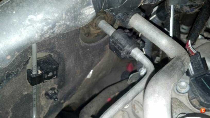

    find the plastic coupling that goes to the firewall

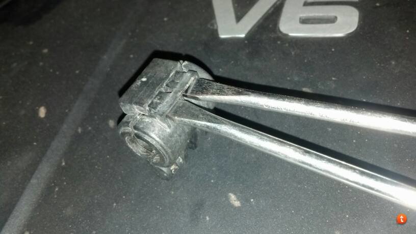

    use two flat-head screwdrivers to open the coupling so you can detach the line like so

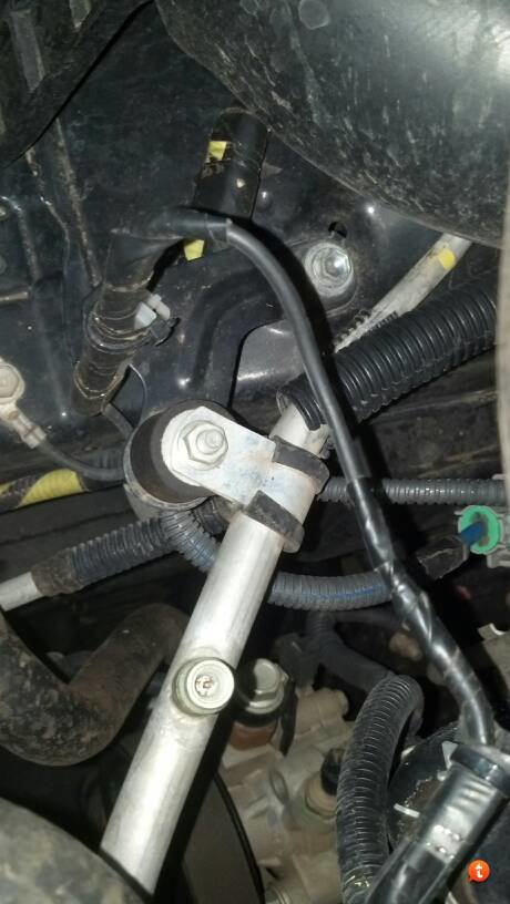

    remove the (10mm) bolt that attaches the line to the condenser
    remove the stabilizer bracket (10mm) to free the line

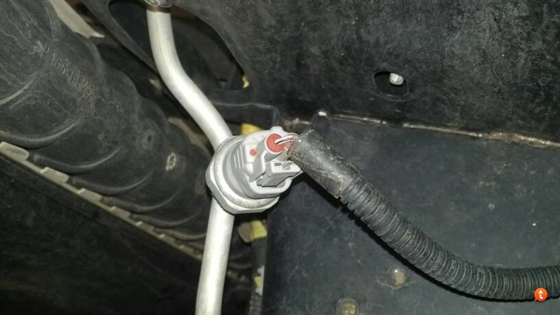

    remove a sensor on the line
    disconnect the two plugs near the engine oil dipstick
    remove the low pressure stabilizer bracket
    lastly remove the mounting bolts for the power steering reservoir (10mm) and air intake tube (12mm).

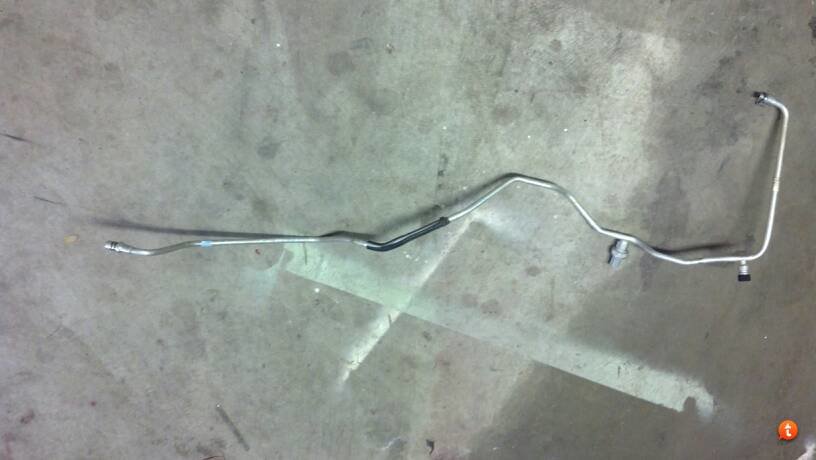

    now all you gotta do is fanangle the little pain the butt line out of your truck.
    then tada

    I think it ac discharge hose, I got lucky I found one new on eBay for 15 bucks but they're like 80 at local auto parts just unscrewed and screwed back on
