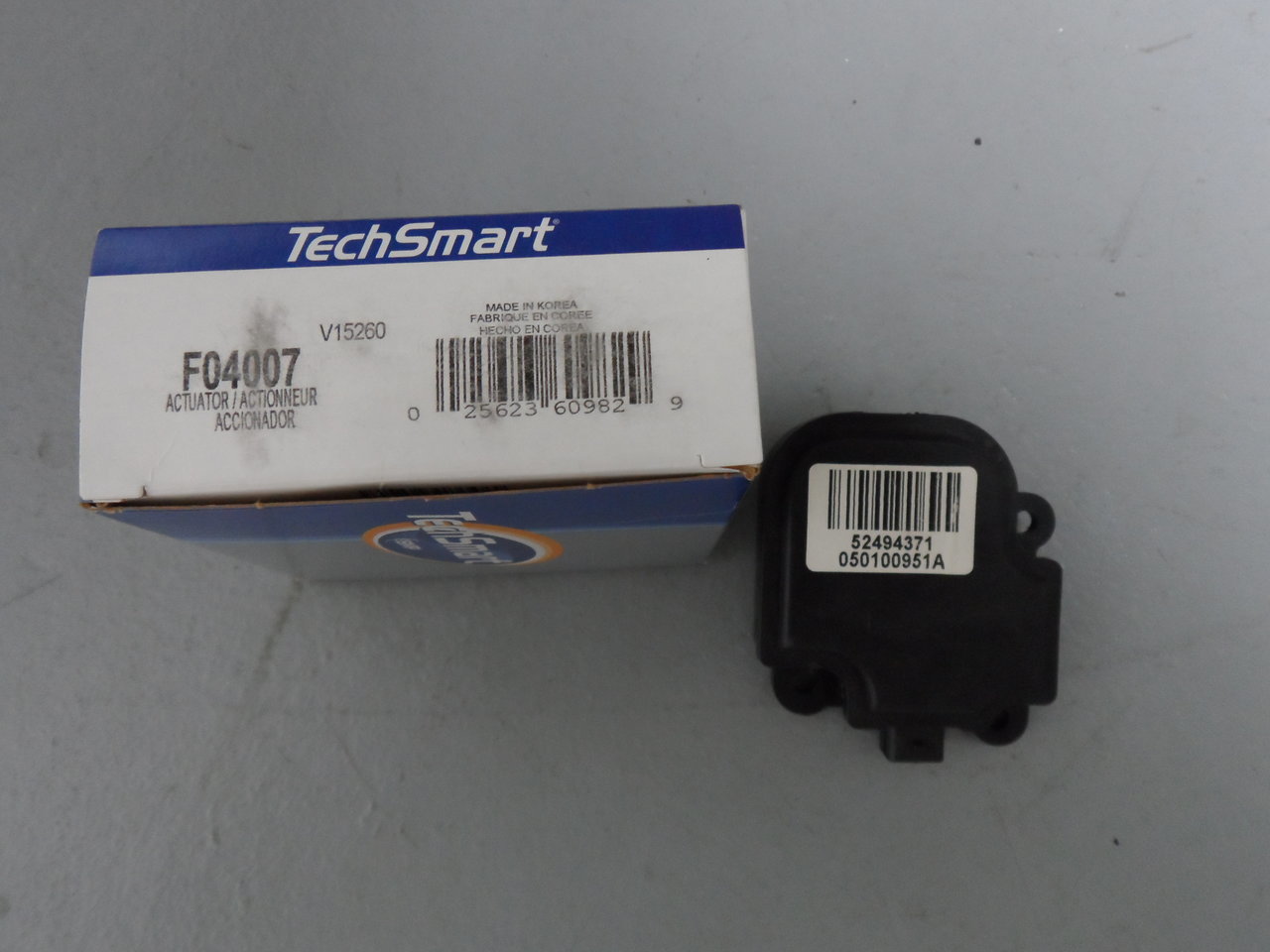

    Sounds like you need to replace this:
    RexsTaco likes this.

    What's the name of that part? Is it just "actuator"?
  6. Oct 11, 2017 at 5:52 PM
    2015 TRD Sport
    2015 TRD Sport Well-Known Member
    Apr 15, 2013
    #102139
    748
    South Carolina
    2021 TRD Pro
    Yeah it's the actuator for the fresh air damper.. I got this online a few years ago for a 2010 I had, was $35, not sure what the price for them are now.. dealer wanted around $115. This part had the same part # sticker on it as the OEM one.

    No problem.. You'll need a 5.5mm socket to replace it too

    Take note: There are three of those servomotors on the system. See the diagram below. The one you need for the recirc control is the Air Inlet Control Servomotor. You will need to remove the glove compartment to get at it.

    There's only two bolts on the servo right? I can barely get back there to tell, but I can see two of them.

    2 bolst behind the glove box... takes like30 min tops.. I just did min last month on my 06
    texred73[OP] likes this.

    ordered mine from Advance auto parts

    its only the one that goes out... the tapping noise is the door opening and closing due to servo being stripped

    They are all built the same. Any one of them could go out.
