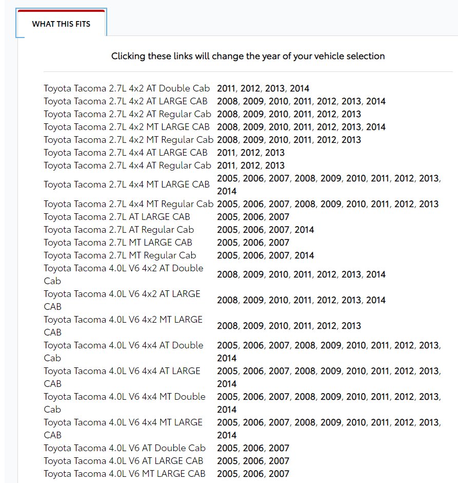

    And here's a pic of the models it says it fits.

    Here's what I found when searching for images of part # PT278-34050-CB.
    That to me looks *completely* different from the other roof rack that has the side rails and the swing away cross bars. This looks like it can install by itself.

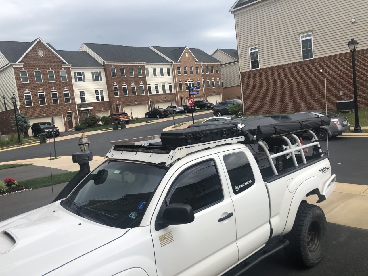

    If you just want a roof light bar, then just get the brackets for one.
    All access cabs require drilling into the roof for install. Otherwise, they just clamp on. IMO, they look like hammered dog shit.
    I believe Prinsu makes an AC rack, still requires drilling.

  17. Jun 12, 2020 at 10:25 AM
    #17
    fatfurious2
    Jun 28, 2014
    #132884
    49,775
    David
    Ashburn, VA
    2010 TRD OR Access Cab
    Yes it does. 12 holes. But it looks so good
