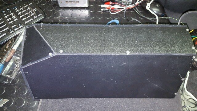

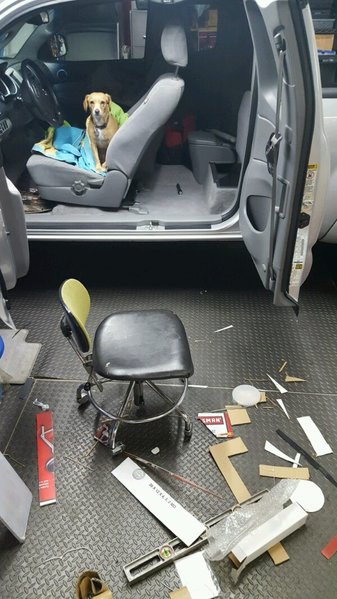

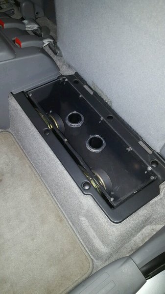

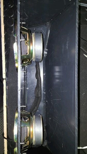

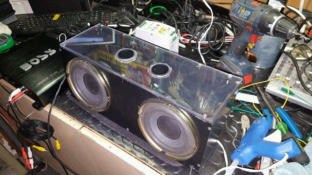

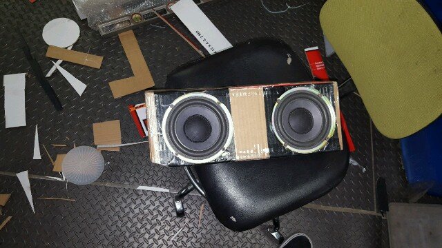

    Wanted more bass with minimal space loss. Box is small but works great. (2) 4" Bose oem speakers. .25" ABS and polycarbonate box. Made mock up in card board. Used as pattern. Forward sound carries thru storage area carpet and vents fire upwards. Only permanent mod I made was cutting out inner storage bin plastic to make room and allow sound to travel thru factory holes in the metal behind the carpet. 20160101_203621-640x360.jpg 20160101_203451-600x1067.jpg 20160101_203554-480x853.jpg 20160102_180553-640x360.jpg 20160102_165947-480x853.jpg20160102_170007-640x360.jpg 20160102_213004-480x853.jpg
