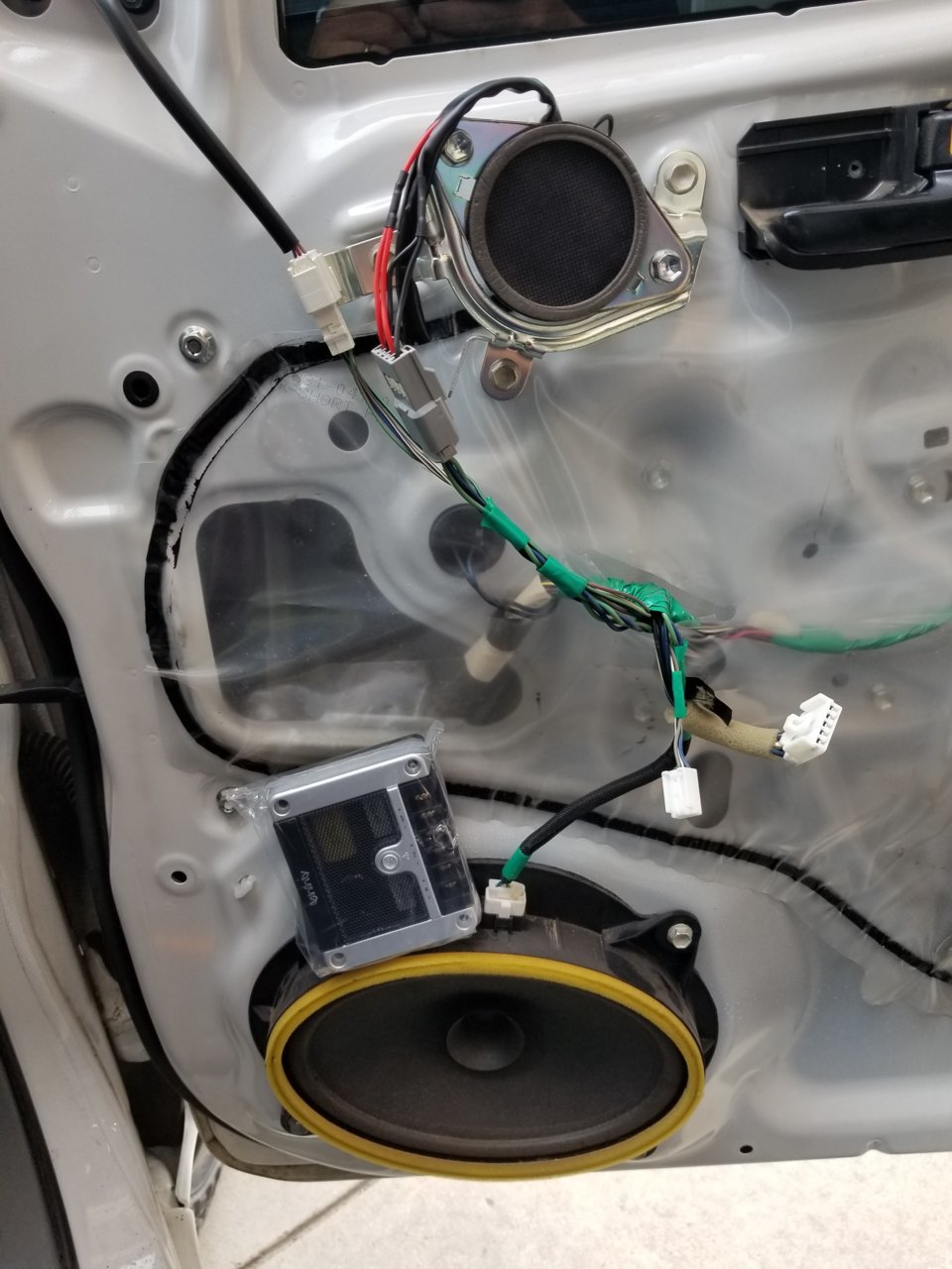

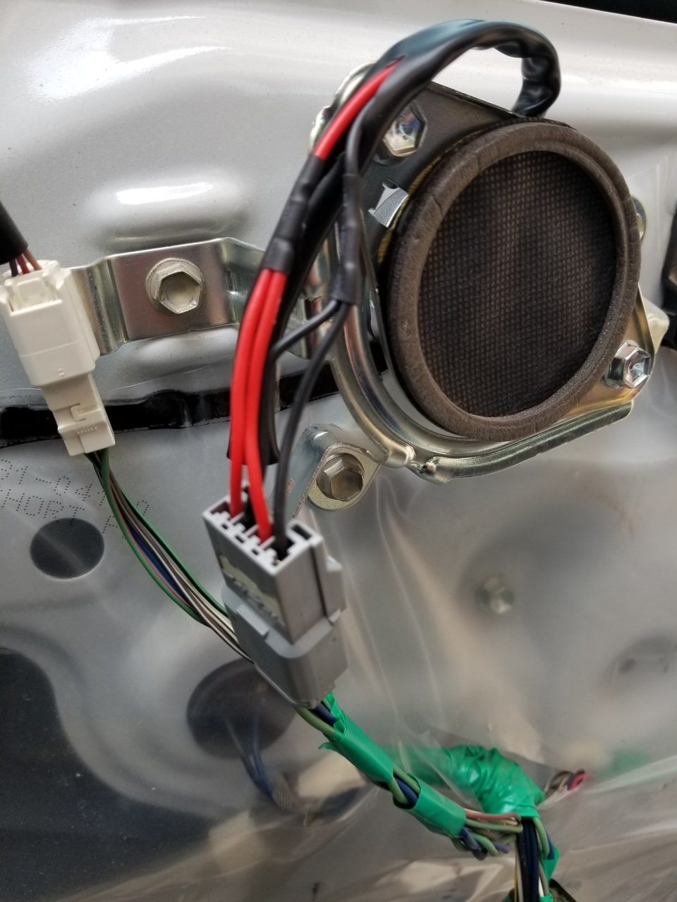

    Answered some of my questions...
    If you unplug the tweeter, woofer does indeed go out too. Cut back the wire sheathing. I believe all that needs to happen is connection of the like colored wires, then I can use woofer wiring to send to xover.
    I have the wrong speaker adapters anyway so have to wait for the right ones as I don't feel like making my own. Might be room next to woofer after it's adapted to 6.5" or thinking maybe below and behind door handle.

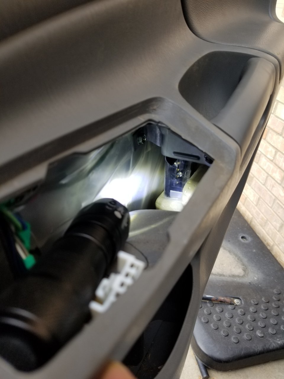

    Like in here maybe?

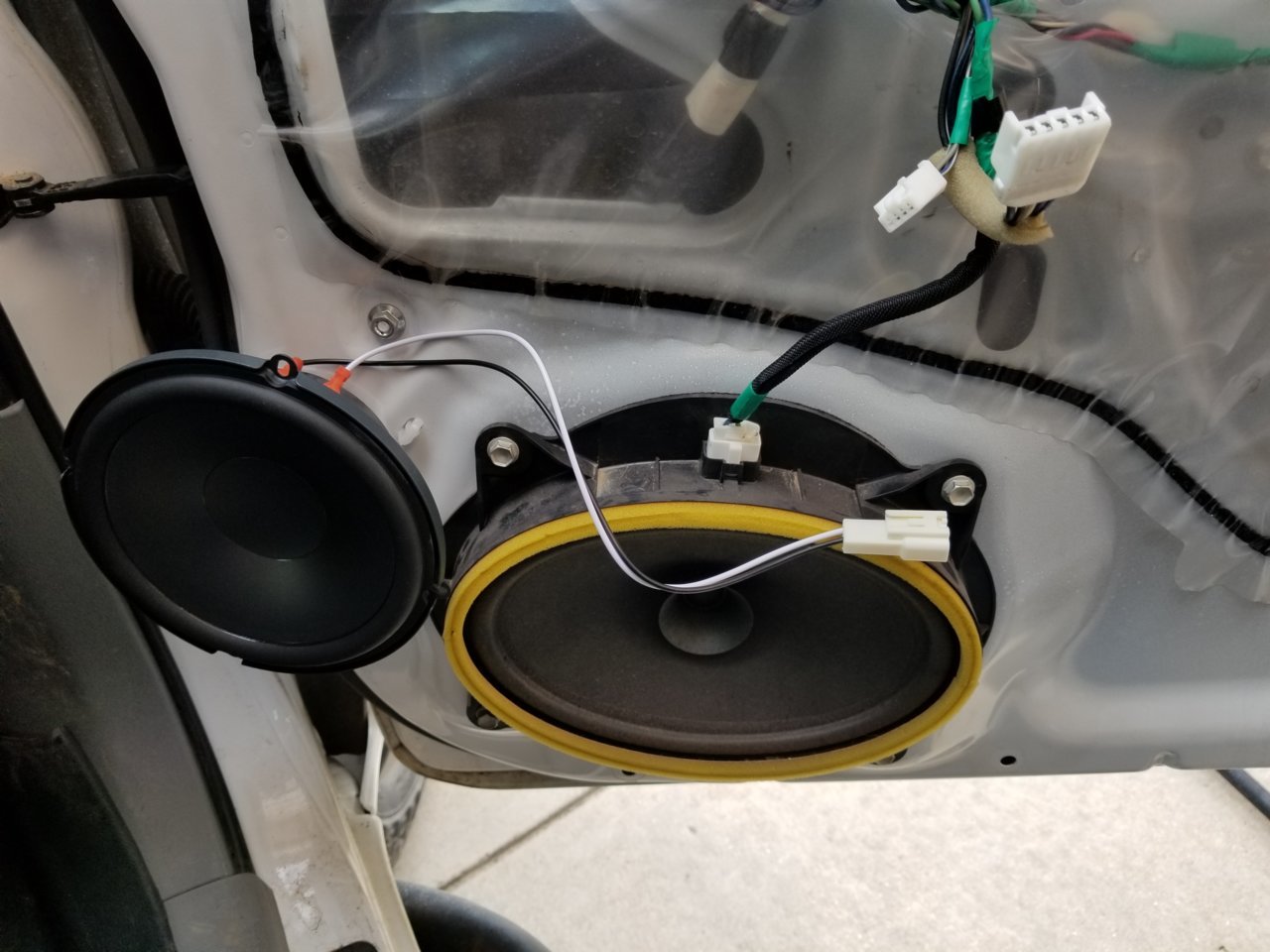

    As proof of concept, I tried unplugging stock woofer and plugging in new one.
    Obviously new woofer is getting the full signal like this and it sounds like it's struggling with the high frequencies but there wasn't really a depreciable loss of volume so I'm optimistic about running these without an amp. We'll see.

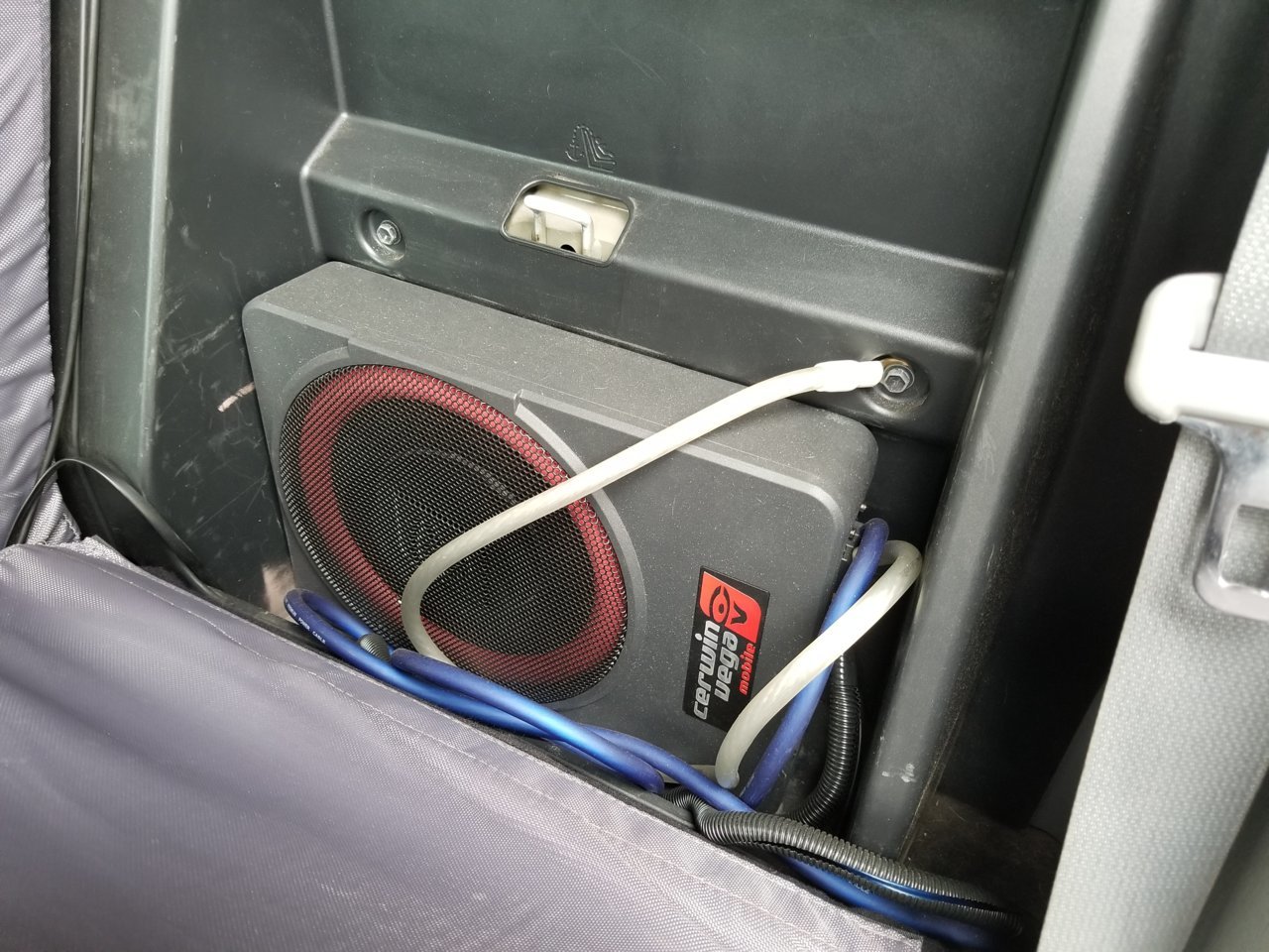

    I also didn't mention that I put this little bugger in some time ago and it provides plenty of bass for my tastes.

    Looks like this might could work....
