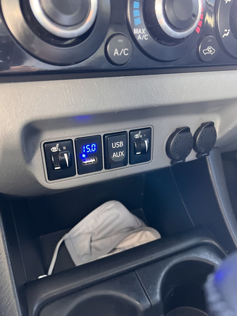

    $yoda$
    $yoda$ Well-Known Member
    Jun 11, 2019
    #296087
    1,948
    Tom
    2007 Tacoma 4.0
    2.5 inch lift, 285/75r16s, upgraded stereo system, Magnuson mp90 supercharger system.
    It’s what my 95 has been at it it’s whole life. Same with my daughters Pontiac the wives focus and fusion. I’m no master Mechanic or anything like that don’t even to be any kind of mechanic but I’ve worked on my own stuff a long time and pretty much what everything I’ve ever worked on charges at. If it’s not snowing then I get off I’ll get out the meter and post a pic of the taco but it won’t be the first time and it charges at 14.5 to. I’m not trying to be difficult or anything just a little confused.

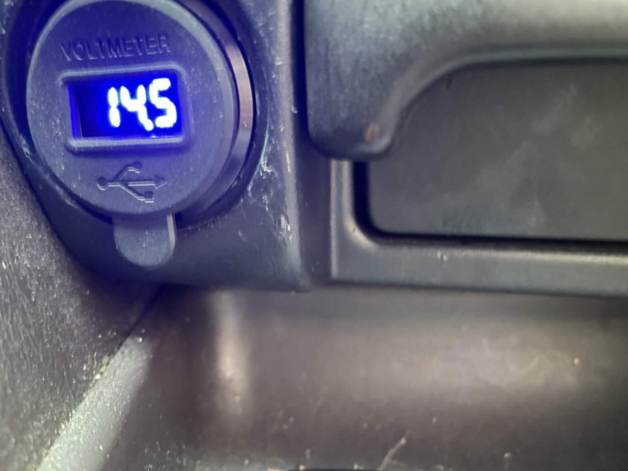

  18. Dec 30, 2021 at 7:45 AM
    #18
    $yoda$
    Jun 11, 2019
    #296087
    1,948
    Tom
    2007 Tacoma 4.0
    That 14.5 was after I had driven to work and was at idol in the parking lot.
  19. Dec 30, 2021 at 7:55 AM
    #19
    SR-71A
    SR-71A Define "Well-Known Member"
    Jun 1, 2018
    #255145
    7,803
    Zack
    Southern Maine
    2012 DCSB, TX Baja Edition. Barcelona Red
    255/85/R16 Falken Wildpeak MTs, Mobtown sliders, ARB bar, SOS front skid, Icon RXT leafs, extended & adjustable Kings, JBA UCAs, OVS wedge RTT, dual AGM batteries, Gen2 xrc9.5 winch, CB, GMRS, S1 ditch lights...
    I wouldn't trust the "voltmeter" on that little USB outlet thing very much :thumbsup:

  20. Dec 30, 2021 at 8:03 AM
    #20
    ZMan2k2
    ZMan2k2 “Hold my beer and watch this!”
    Aug 28, 2011
    #62491
    1,833
    Richard
    ‘Berta
    06 Rad Red DCLB SR5, ‘25 SS Red Sport Prem. (on order)
    Take a multimeter, set it to DC, and when the truck is warm, check the voltage on the battery.
