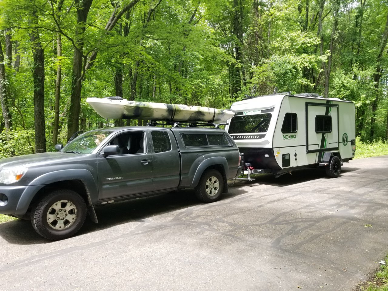

    We were pulling the 16.8 with a 2009 SR5 and it struggled on inclines, but what doesn't. I don't think I would go much heavier unless you are doing short trips. We have replaced the truck with a 2019 Sport and the suspension for towing is noticeably better. We usually carry wood, water, kayaks, etc, so we do have some added weight.
