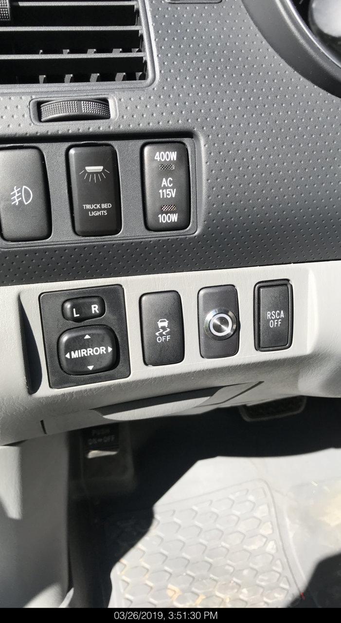

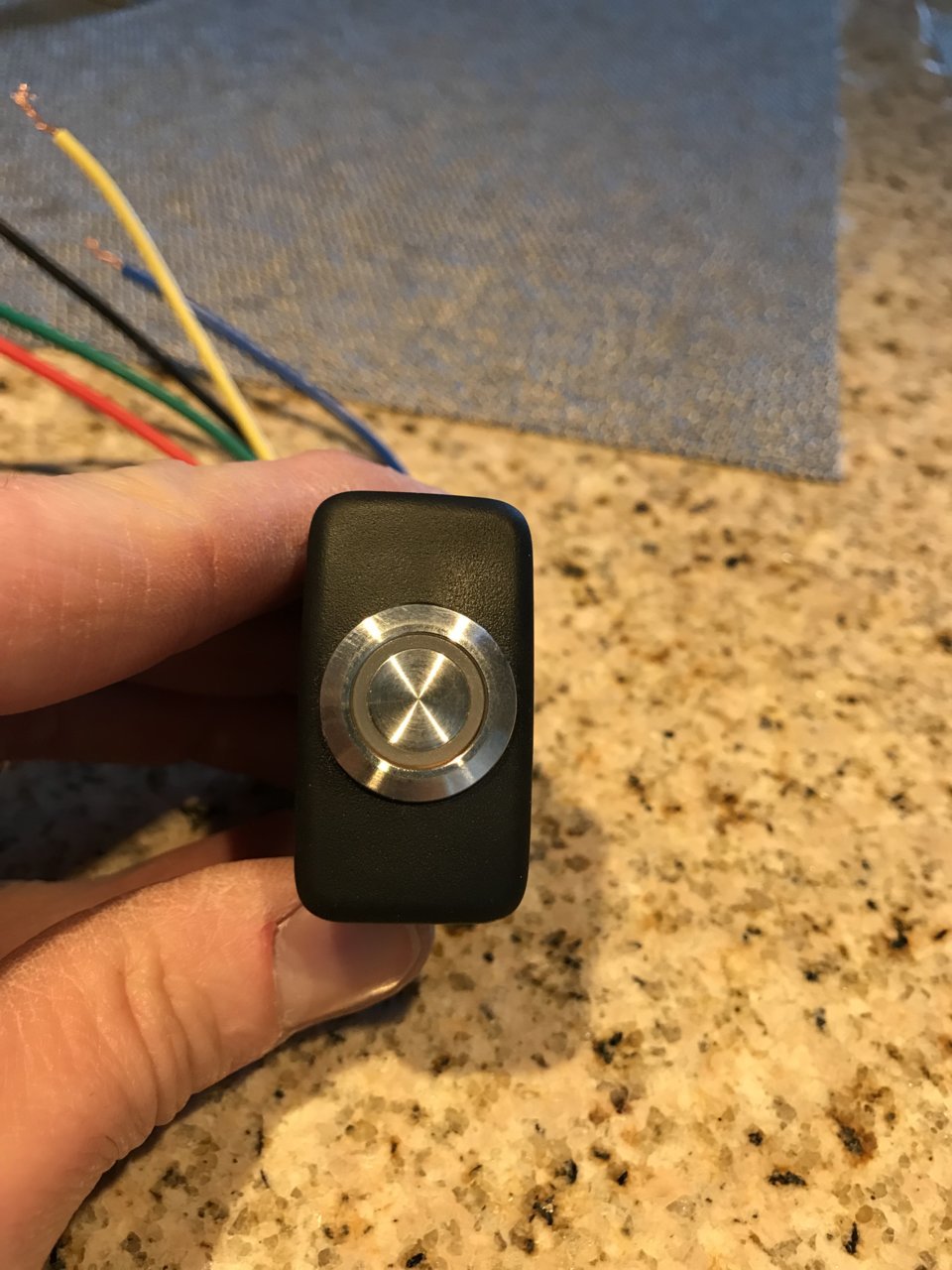

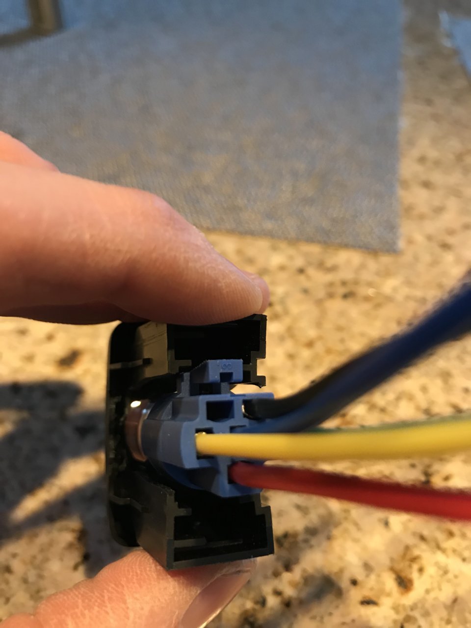

    D590F001-3489-4476-A5F0-367E40C061BA.jpg I finally got my switch installed and got the camera to come on anytime. Here’s a few pics of the switch I used. I just drilled out the blank
    586AE274-009A-4E1C-9728-DE753F96D993.jpg 3EC58E15-747E-440B-9DF7-B5F1E2FD7DFF.jpg

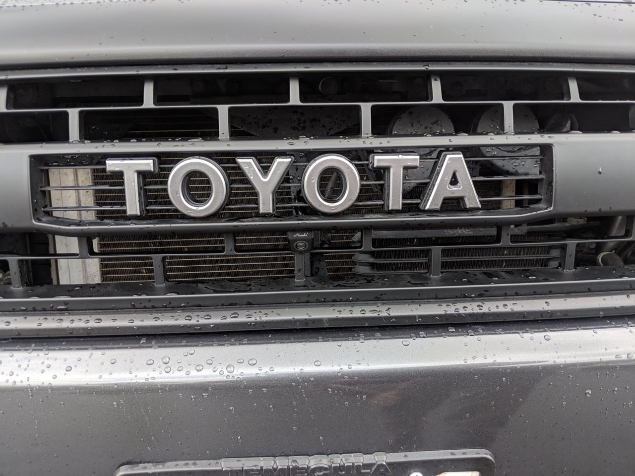

    Anybody mess with changing the lens for the front camera? I feel like 170 - 180ish degrees isn't really needed in the front, and I'm guessing the distortion makes things in front seem way too far away.

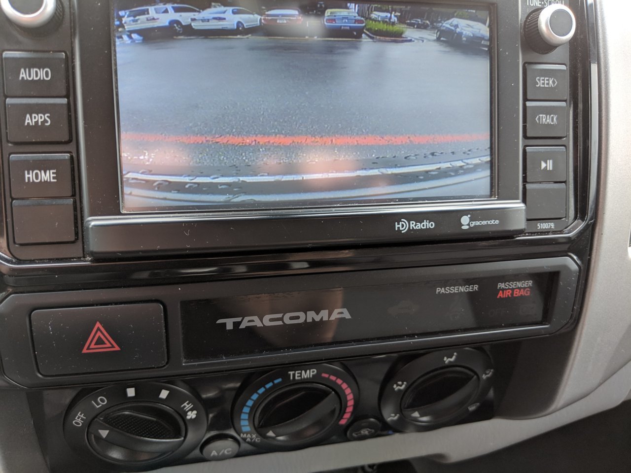

    I'm pretty happy with how this turned out on my 2015. Great mod!

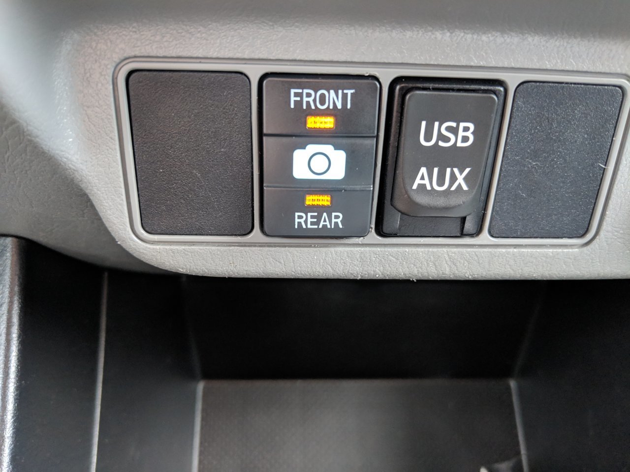

    I can toggle front and rear cameras through the dash screen. It's an entune model without navigation.
