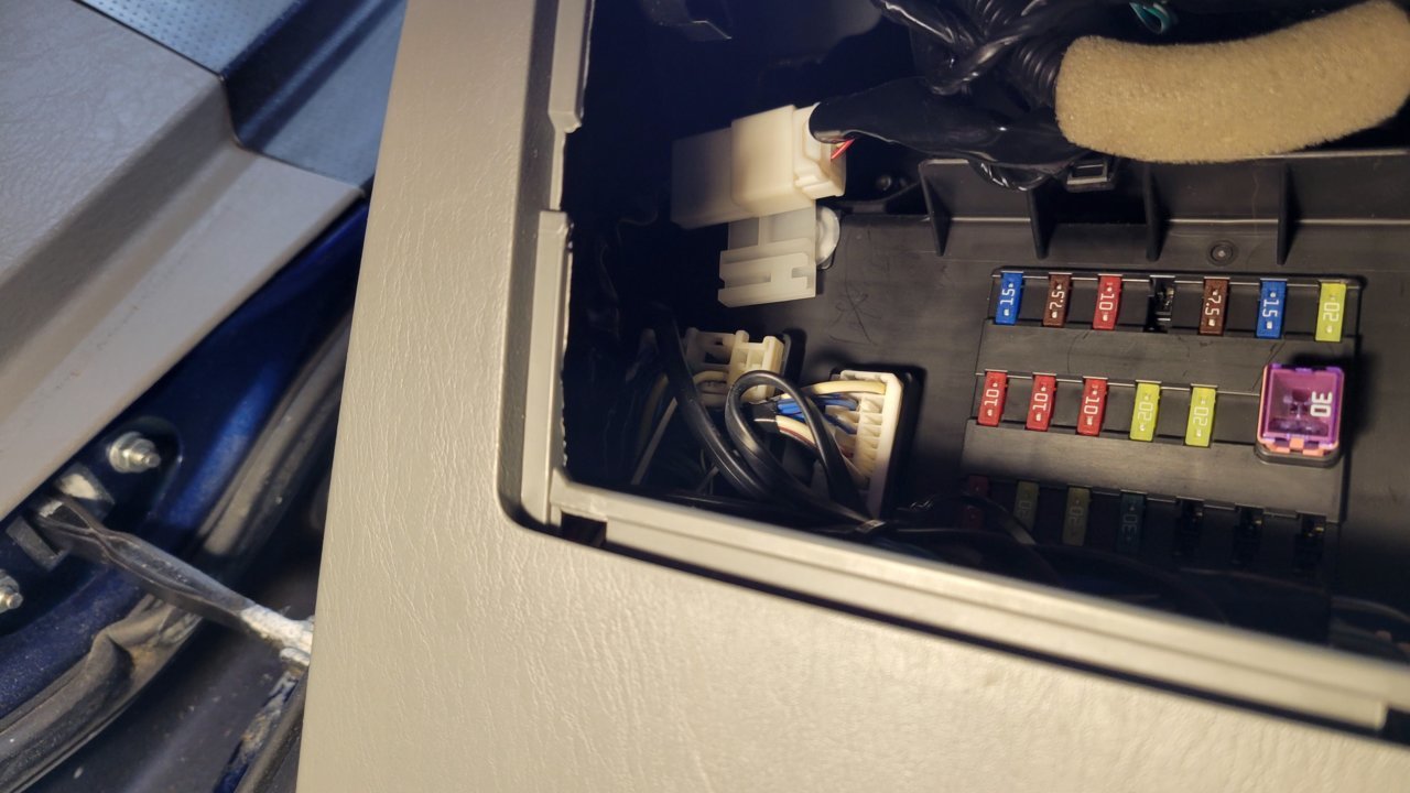

    I thought this as the IN1 plug... but now I'm stumped, disconnected the switch and put it in reverse, backup camera still comes on.
    Thoughts??

    You're year Taco doesn't have it.

    Connector slot numbers are opposite of wires side. (Looking into the removed connector)
