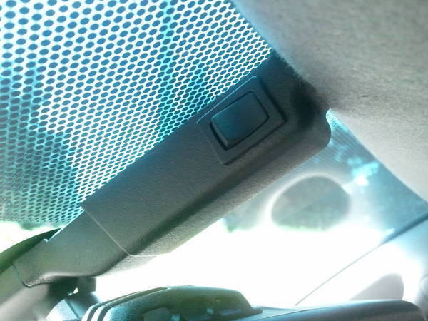

    Here's where I put my switch...clean and discreet.
    I use my camera when off-road. Useful to keep an eye on who's behind you and check clearance for obstacles. Useful when towing, or to see a hot chick stopped behind you at light or someone riding your ass.

    Very nice, I like it!! Quite discreet :spy:

    Downside to putting the switch there is if you put the rearview mirror extender in, this piece of plastic goes away and you need to find a new switch location. I'm dealing with that now as I don't feel like re-wiring it to the dash location.

    I don't need the extender.
    It seems like you would lose a few inches of visibility with extender as well, plus with my skewp I need all the visibility that I can get :p
    *Nevermind, I just realized the "Extender" is meant to raise the mirror up. The name is a little misleading

    Yeah, sorry 'bout that, I meant Immryo's mirror bracket.

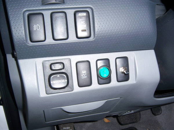

    Do you have any info on the switch you used? I like this location as well and that switch is perfect.

    Great write up and input from all. :thumbsup: I just did my '12 taco, no entune, used factory scion switch from eBay 19 bucks. It took me while, 45 min first time under the dash so I was checking stuff out. I also am thinking about a camera mount for the front, great for checking out clearance and just an overall better field of view. The drawback to the mirror switch mount is that people see you reaching for the mirror although it is clean and simple.:D stoked
