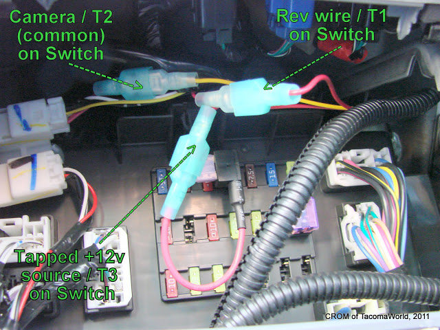

    Just don't be in Reverse when you toggle the switch. If you are,the camera won't actually lose power..it just goes from getting power from your switch to the factory supply since you are in Reverse. Hope that makes sense...

    my reverse lights come on, i just tried doing this with some rough wiring (shoving a hot into the back of the connector). i need to find out how to make it where they dont

    Dunno what to tell you other than obviously something is different. Mine do not :D

    yeah ill mess with it, it might have something to do with me just adding 12v into the back of the connector... i dunno :notsure:

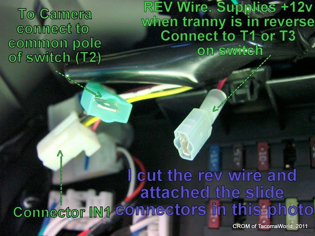

    It does, you have to cut the wire and use a SPDT switch. Make sure the common connection is the lead going to your screen or mirror then your 12v to the Normally open and the wire going to the plug to your normally closed terminal on the switch.

    I did this mod today, but skipped the switch and wired directly to key-on... you probably know where this is going.
    Has the 5 minute timeout for the monitor ever been figured? This thread implies it's a screen saver, but I can't find the discussion anywhere.
    I don't want to be reaching for a switch while driving every five minutes... Look: I don't care if my mirror catches fire, I want the damn camera on all the time.
    Any ideas?

    ^LOL. Not to my knowledge and in my opinion, probably not going to happen. If it's that important to you to have it on all the time, why not invest in a dedicated camera setup and leave the stock one alone?
