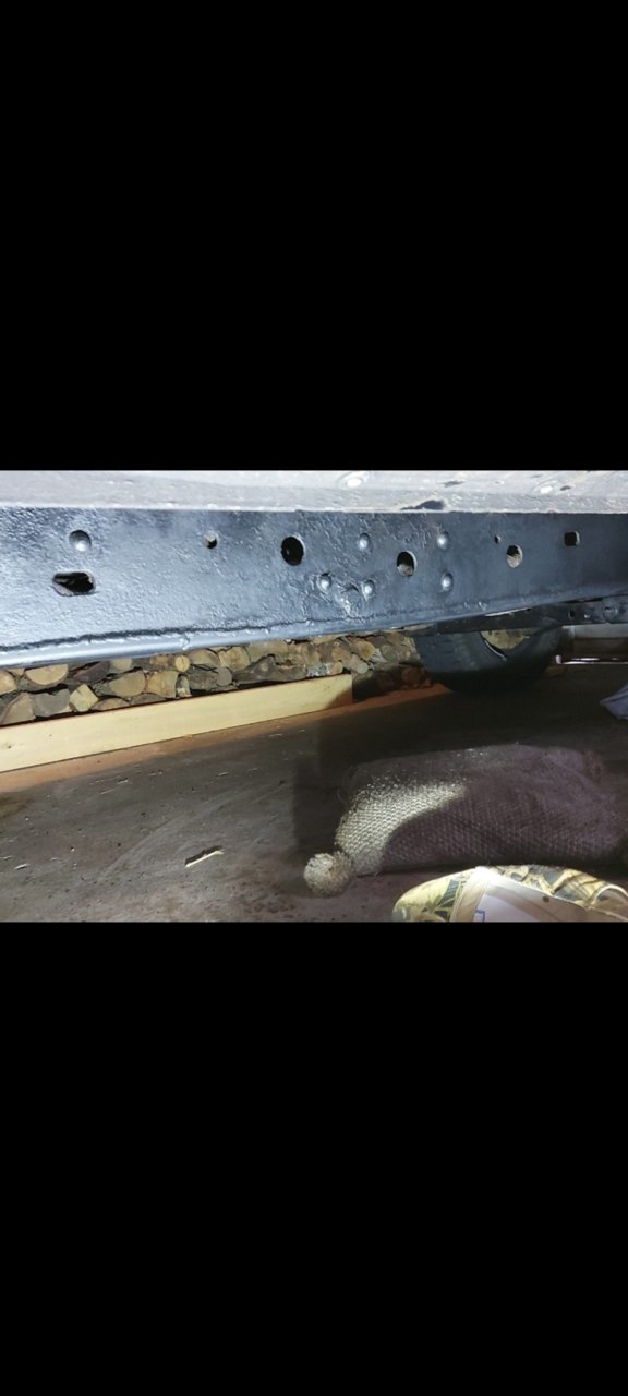

    Thanks guys found a patch on the rear passenger side which they didn't line up just perfect when welding. I presume this is the cause and ended up putting rubber spacers on that end of the bed to level it out. Seems alot better now. Got under it over the weekend and took a wire wheel to get the surface rust and old under coat off the frame and then painted it with rust check black looks a lot better and plan to get it under coated this week to try and preserve the frame the best I can
