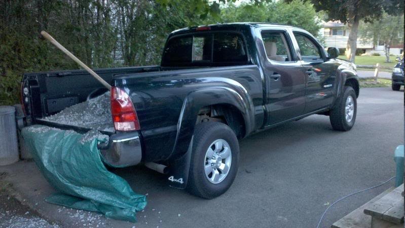

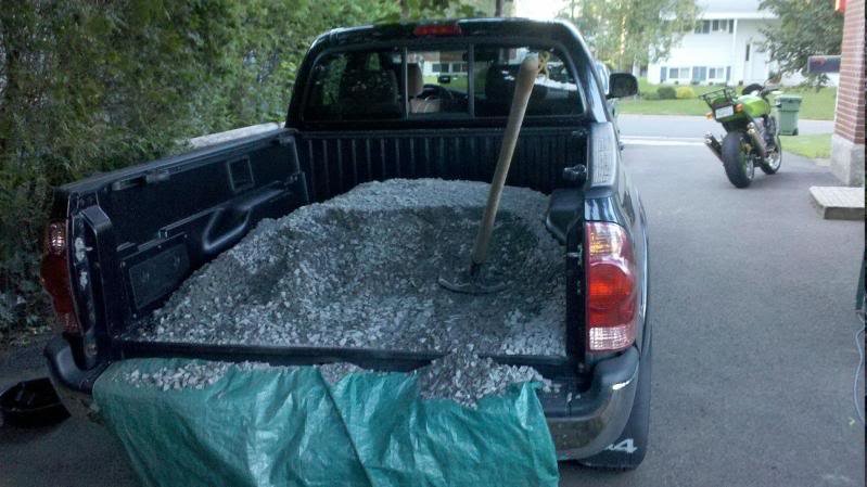

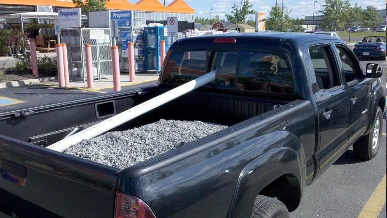

  18. Aug 13, 2012 at 6:30 AM
    #18
    Gregman
    Gregman Well-Known Member
    Jan 11, 2010
    #29166
    604
    Freddy Beach, NB
    05 DC LB 4x4 SR5
    Bumping an old topic, I know, but I just wanted to post up these pictures to show how effective the Firestone Ride-rite air bags are at supporting weight. Here I had a 1/2 yard of 0-3/4" crushed rock that is supposed to weigh somewhere around 1.35 to 1.4 tons per cubic yard so this would be something like 1400 lbs. I pumped up the air bags to 50 psi and the truck is riding at normal stock height with no sag. Driving down the road, the ride was quite nice as well.
