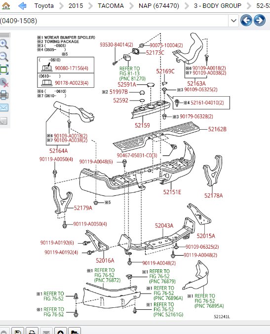

    Which bolt need to come off just remove the bumper, I see 4(2 ea side)that run thru the factory hitch it also the two in the middle of the bumper where you’d step. So those six?

    This might help. Looking at the picture, I think you're right.

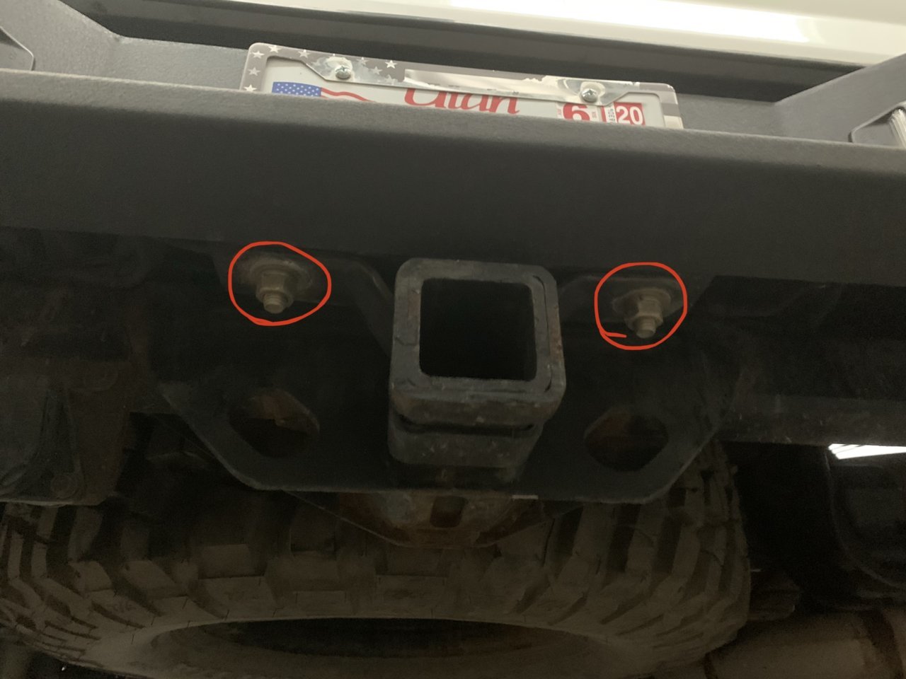

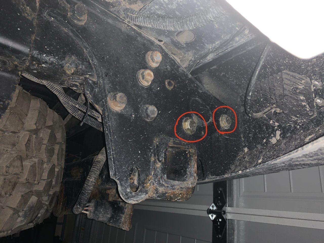

    Yep! Just the 6
