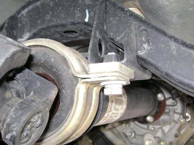

    This thread is old, is about carrier bearings and the cross members above it, and is no longer useful to me. It was in regards to the 2nd gen Taco's using 2 different style cross members. I made the thread asking if forum users could post up pics and year/model of the truck. I resolved the issue by making 2 different holes in the top tower piece on my carrier bearing drop bracket.
    The bracket drops the bearing to help with vibes, and drops more than the common washers or spacers sometimes found in lift kits. Dropping more than what those kits offer has been the 99% fix on the Tacoma. I designed this after seeing way too many setups that had bolt threads maxed out, or simply had a lot of slop in that area which is why I added the top tower, a 3rd attachment point.
    Out of about 40 of these now, I've only had 2 trucks it didn't help. I have one for first gen, one for second gen Taco's and one for Tundra. I offer them in 2 drops, 1.5" for rear lifts at or below 4.5", and a 2" drop for trucks above 4.5". They're available on my website by clicking my sig, going to the products page, searching carrier bearing, with easy PayPal checkout.

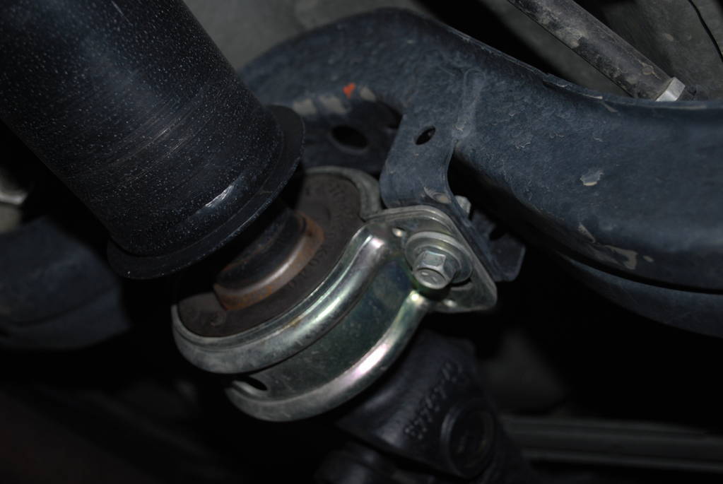

    My 2010 is offset of cross member, but has 4 mounting holes 2 directly under, 2 a little offset. Hope this helps

    My camera is pissing me off... pos. But my truck looks exactly like his ^ 05 4x4 AC V6

    09 Access cab 2.7 4x4 looks exactly like this ---^

    Seems like maybe the 2wd's are directly under the crossmember and the 4x4's are offset due to the transfer case :confused: ... cept for toyo freak, but atleast he has the mount with 4 holes?

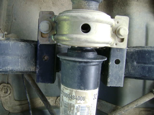

    Just reiterating for documentation purposes, my 2009 DC SB looks like this:
    This was actually the pic of my truck that I sent Beefed, not that it matters. CB bracket is offset compared to the crossmember above it.
