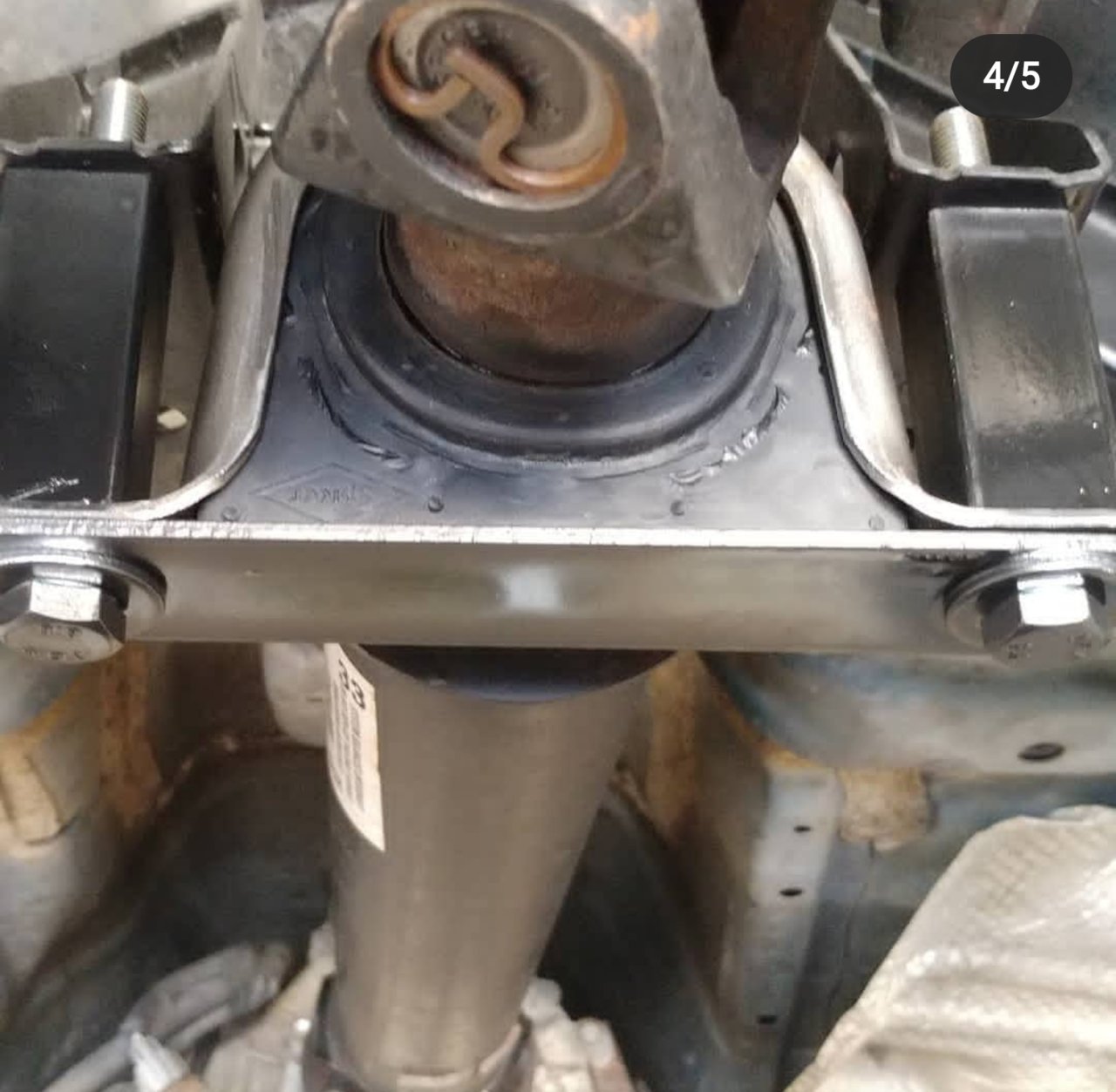

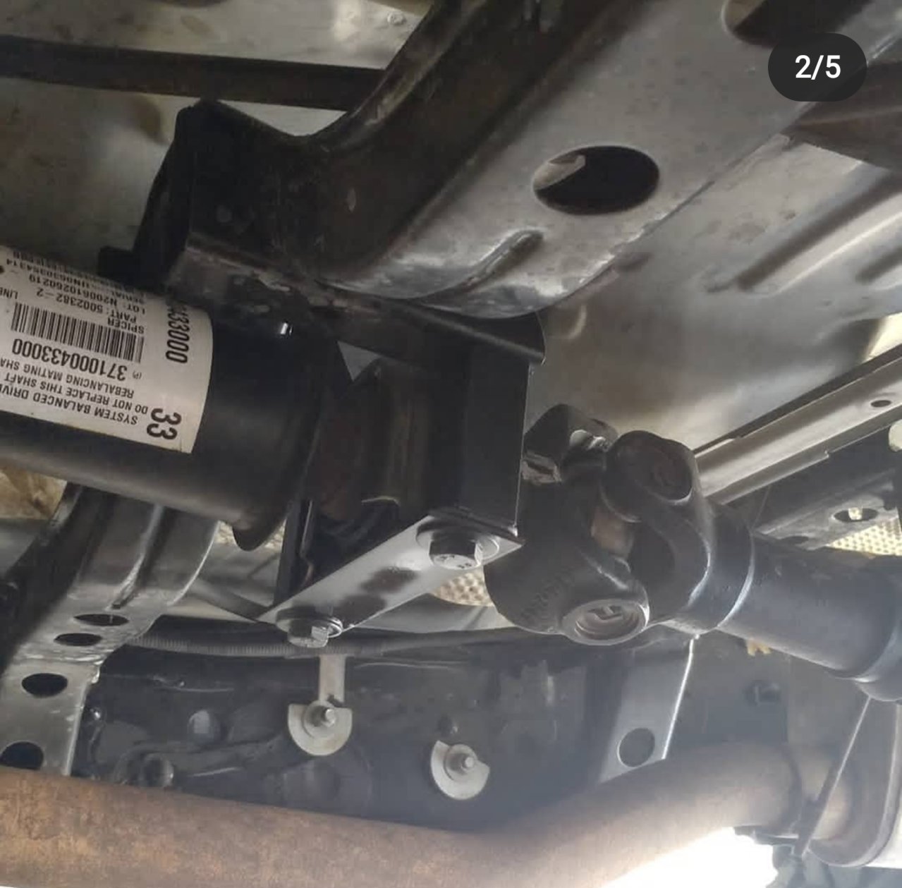

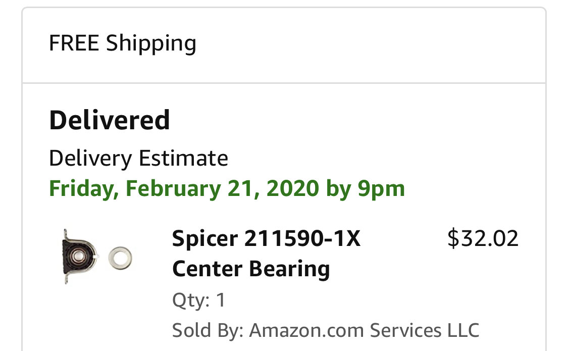

    That’s actually a Ford center bearing, but with some slight modifications will work on our rigs. I have one already though that I purchased on Amazon. I think I paid $32.

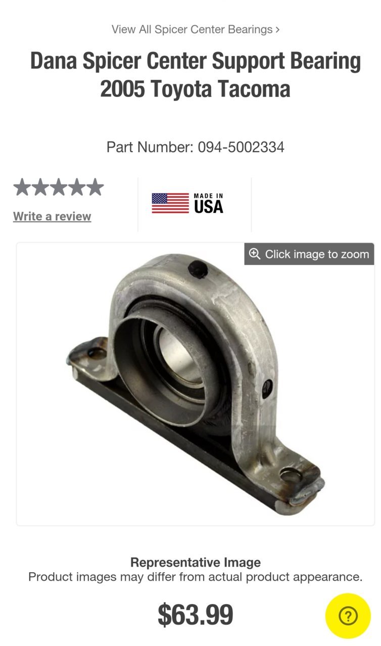

    Why are you posting a screenshot of a TW post, which happens to be mine at that? Lol. Did you pick the wrong screenshot?

    Haha. That’s the photo I originally saved on my phone so I’d know what to order.

    That screen shot picture "borrowed" from @12TRDTacoma is not what you ordered. The PN: 211590-1XS and the PN: 211590-1X are very different parts.

    Mainly Material and cost. I opted for the $32 spicer bearing part #211590-1x as you cant go wrong with that price over the iedls and the quality/price over the oem bearing. Had it on the truck for 20k miles with zero issues so far.

    Here's the Amazon link. Spicer part #215590-1x
    https://www.amazon.com/Spicer-211590-1X-Center-Bearing/dp/B00GAPFQRQ

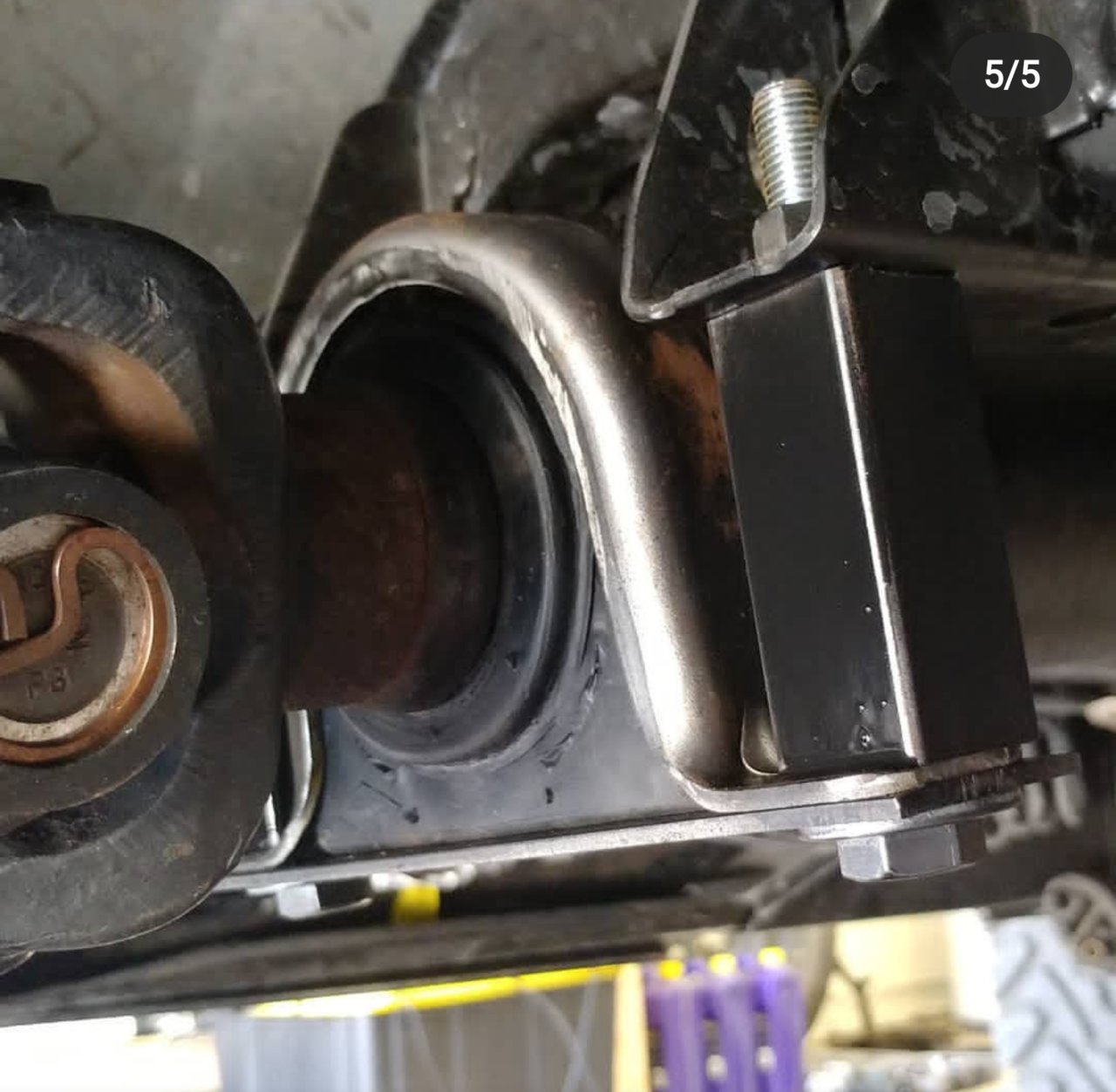

    Here's what comes in the box
    You will need to fab up some parts and new hardware to complete the swap. Super simple. As far as other OEM replacements i feel you cant beat the price and quality of this ford bearing. Haven't had any issues with mine.
