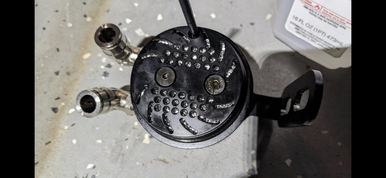

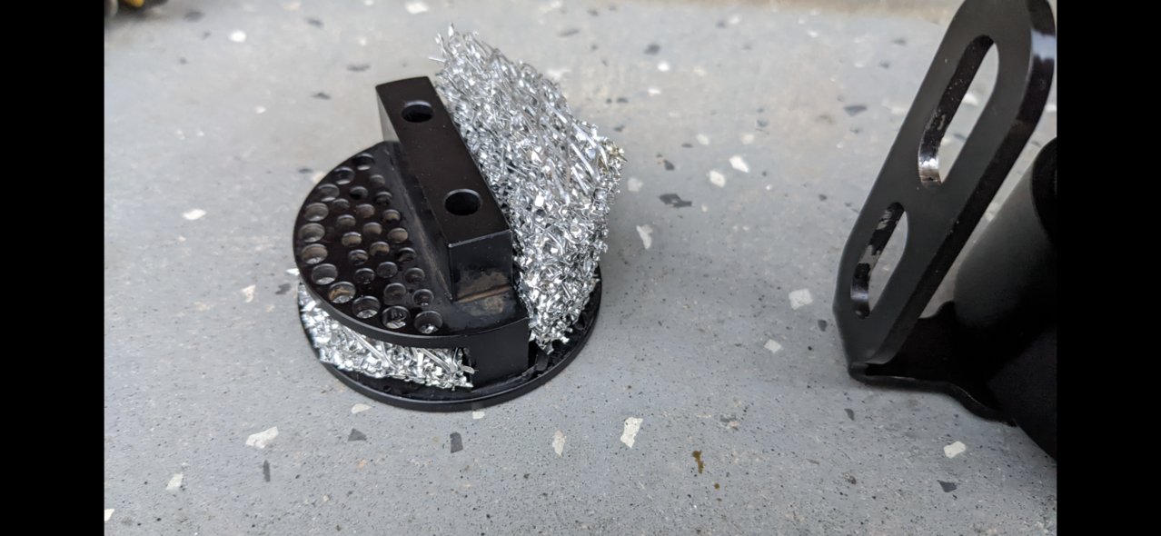

    I tried the sintered filters they're just too fine and the oil gets trapped and carbonises and becomes a complete blockage within about 600 miles.
    I got a baffled can but wanted more condensing media so I used some aluminum mesh and wool filter media tripped to fit into the exit baffle.
    Seems to work fairly well now without ever clogging, going on a few thousand miles with this configuration.
    I drain every time I get gas and usually get 5 tablespoons or so of milky watery sludge.
    I ran my ball valve line into the fender well and down to the frame (similar to the AC condensation drain line on the passenger side) for easy mess free collection.
