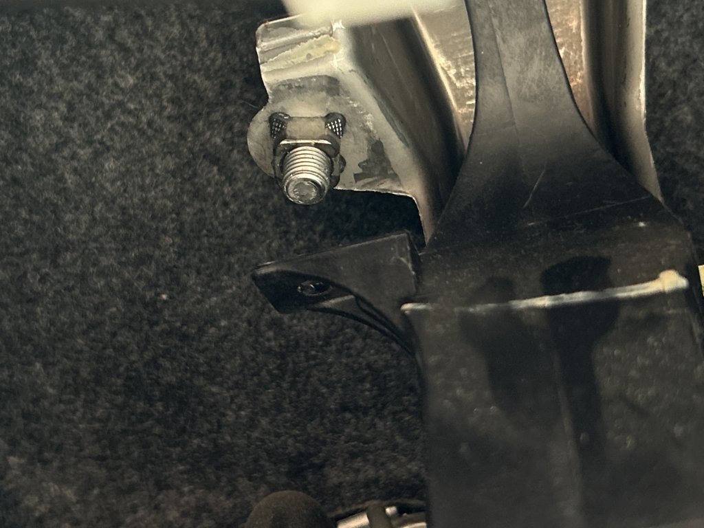

    I’m like 93% sure my clutch pedal isn’t supposed to do this. Is the clutch cylinder supposed to be attached to the pedal in some way?? The pedal travels a good 2 inches before it contacts with the cylinder. Also sits an inch higher than the brake pedal. Any advice would be appreciated, I’m tired of my sad floppy pedal.

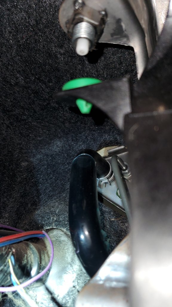

    Also, I think I’m missing a spacer here lol

    The rod is not attached to the clutch pedal, the pedal presses against it.
    It's normal for the clutch pedal to sit a couple inches higher than the brake pedal but there shouldn't be much more than about a half inch of free play.
    Yea there should be a rubber pad there, that's probably where your excess free play is coming from.

    Thanks for the help! I couldn’t find the correct Toyota part for sale anywhere without having the buy the whole subassembly, so I just made my own. Problem solved
