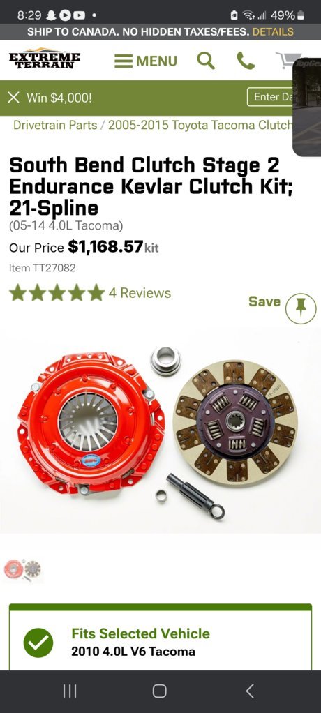

    Hello TW people! My 2010 TRD Off-Road is starting to feel like it'll need a clutch at some point in the not so far off future,
    Does anyone have any experience with the Southbend Endurance kevlar clutches? I don't have any crazy mods and the truck isn't making a bunch of extra horsepower. But I would like a mid more durability and longevity for when I'm working it offroad and in the deep snow.
    Any input on a more durable daily driving clutch would be appreciated!

    I have URD Stage 2. Despite claiming to be stronger which it very well may be, it is also a full face contact for driving the vehicle.
    semi/partial face puck clutches like what you posted are not for that. They are for Sunday cars.
    for example. I rode in a B5 S4 Frankenturbos 700hp with a puck clutch. The owner said the bite was stupid harsh and relegated to Sunday car. It was not his daily.
    The full face stage 2 is said to be stronger to be better. Better engagement. Better off road.
    Would I go beyond that for my use to a stage 3 semi face puck clutch? Probably not. Pretty sure any decent manufacturer of such parts even tells you so.
    Full face is probably designed to work with a bit of slippage on or off road.
    Semi face puck is not. And is designed for a quick on off go. Every time. Fine for a track car.
