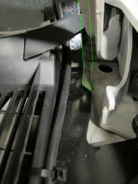

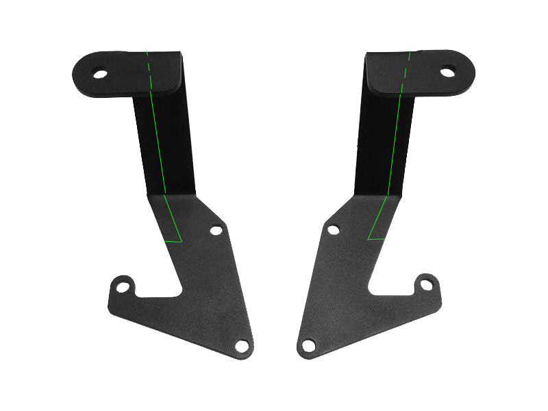

    I'm sorry, but I didn't think to snap a good photo before installing them. I basically trimmed around the space where the hood hinge wants to swing. With the hood open you don't notice but if you slowly close the hood while watching the hinges you may see that the way they travel will interfere with the bracket. I'm not sure why they work on some trucks and not on others, but as designed there was no way my hood was going to close easily.
    I tried to show where I cut the brackets and in the second photo showing the trimmed out area relative to the hinge. It was two long cuts, one along the whole length of the vertical, angled back length and a second on the mounting part. The top part, where the lights (or in my case antennas) mount wasn't modified.
    I did end up using the corner plastic pieces, they got a big fat 'U' cut out of the middle and worked OK. I might pick up new ones from Toyota and try to cut just a slot that fits over the brackets, although I don't know if that will work or that it's even worth it.

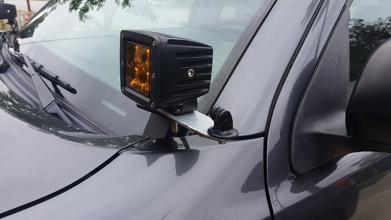

    I made a mount for my gopro on the mount and doesnt require any drilling, its bolt on and would work for an antenna. Ill take a picture in a few
  8. Jun 9, 2016 at 1:02 PM

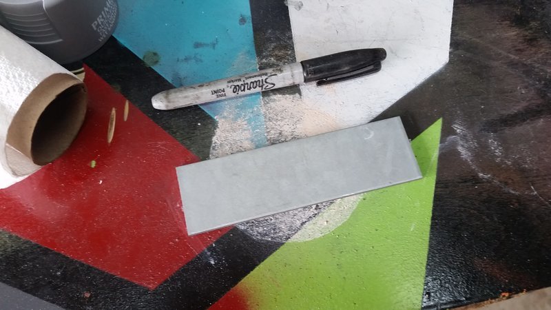

    I drilled 2 holes, 1 for the light itself and 1 for the tripod mount (or antenna). I grinded mine down to fit with the tripod mount. Just need to resand it and paint it due to rust. I believe you can get these metal tabs at home depot, just had a few layin around my house.

    Looks really good! I may need to order up a set now.
