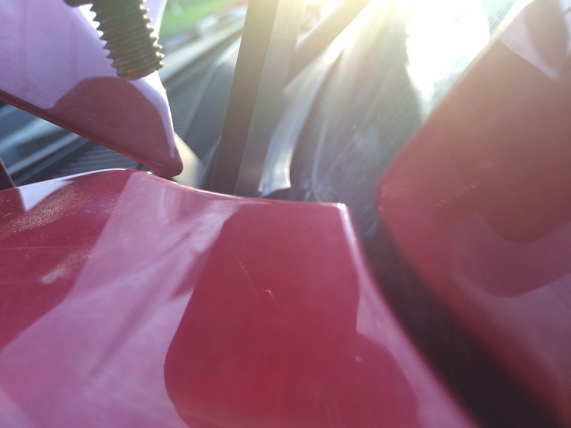

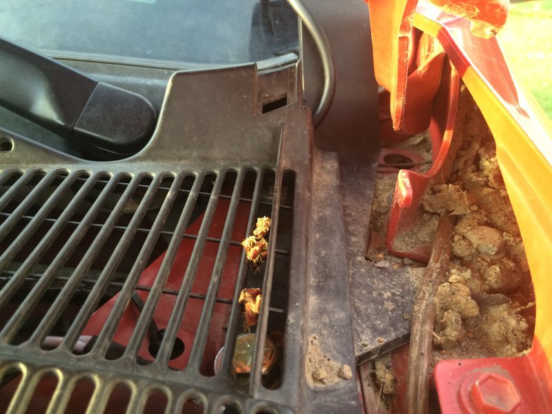

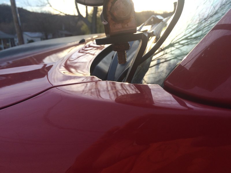

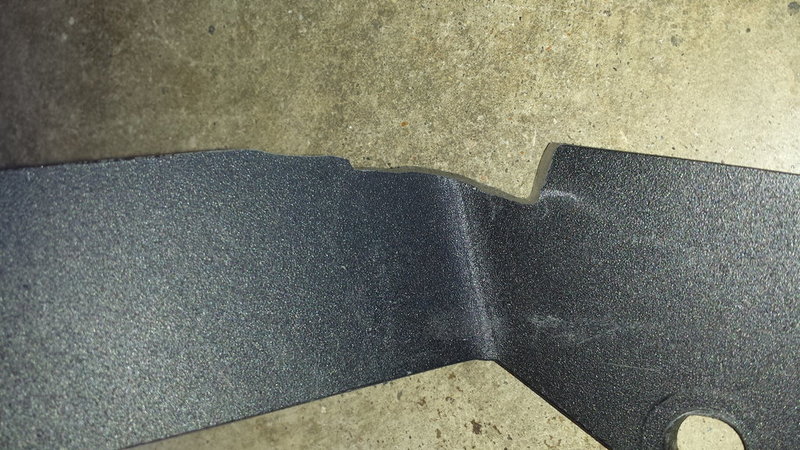

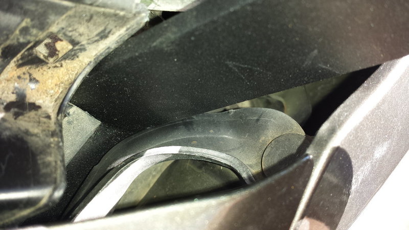

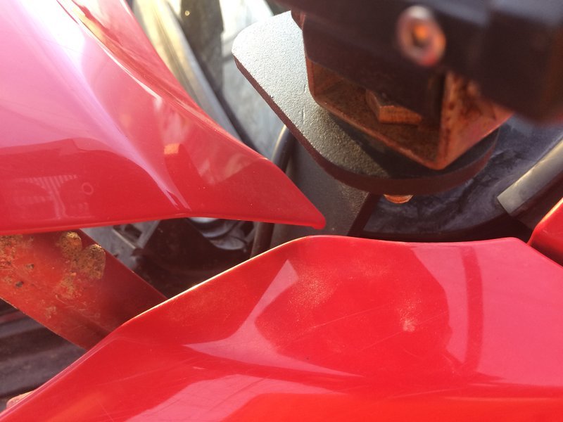

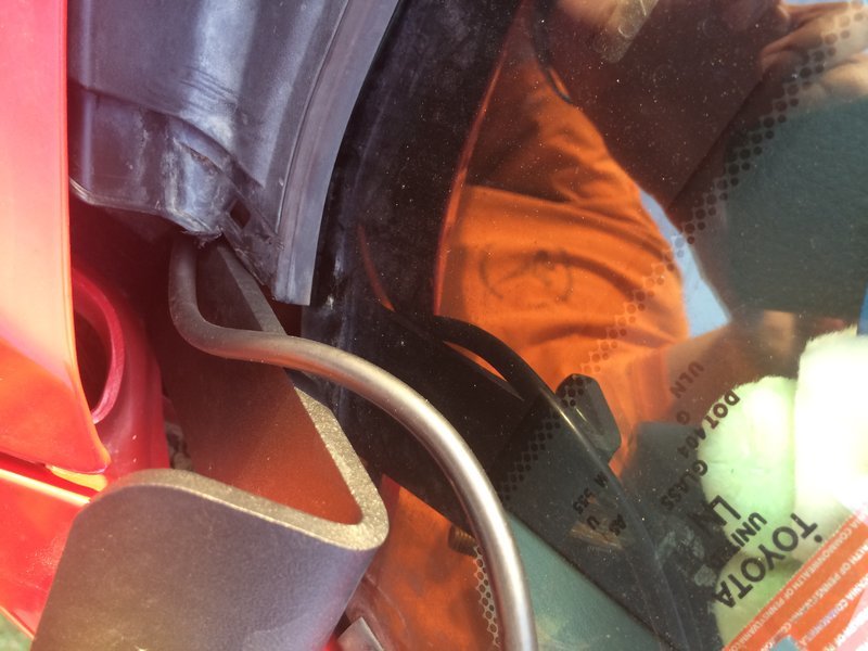

    Here's the cause of the hood alignment issue:
    Here's what I had to do to get rid of the hood alignment issue. Only put in the drivers side since I bought them to mount an antenna.
    I also had the misaligned hole which required enlarging the hole in the truck.
    Don't understand why they would give grade 8 SAE bolts instead of metric for mounting.
    Maybe there's some explanation, but these seem poorly thought out.
    Final result, don't think the gap that's left has anything to do with the ditch light bracket but wish I'd taken a before picture.
    I do like where the antenna mounts, it's pretty much hidden by the pillar, I did have to enlarge the hole to 1/2". I may go back and add a gusset to reduce the movement, the bracket is a little close to the windshield so when the antenna gets bent back from a tree I'm worried the bracket might come in contact. Will have to watch it tomorrow when I take it for a drive.

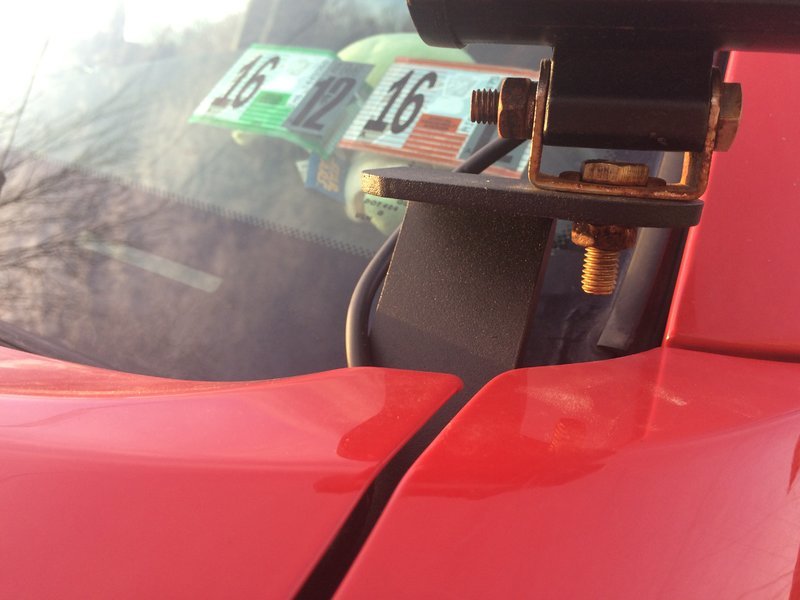

    Put mine on about 2 months ago fit like a glove. And the bolts worked. I got a free shirt too when I ordered mine. I don't have any closeup pics of them on the truck though.

    image.jpg image.jpg image.jpg image.jpg image.jpg image.jpg Here's mine. I can't tell you how much I had to cut. It's been a while since I did it.
