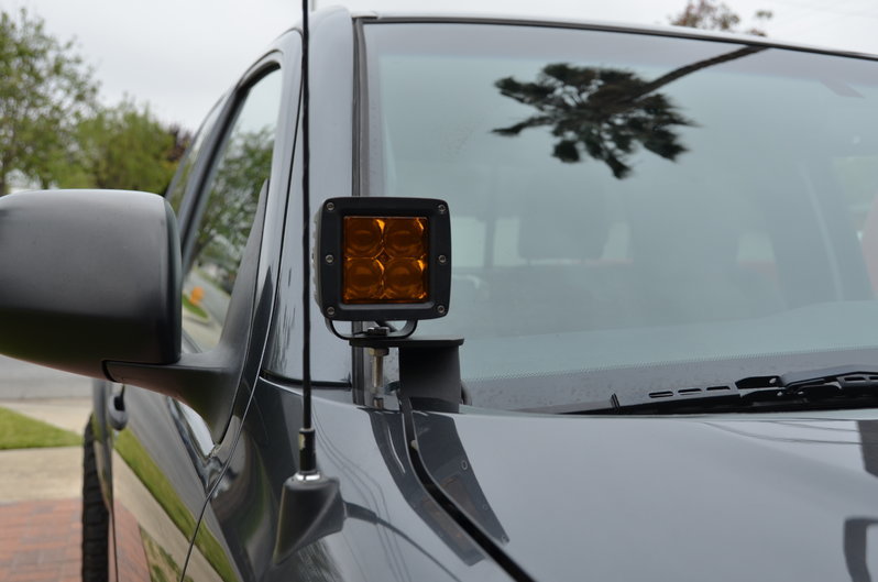

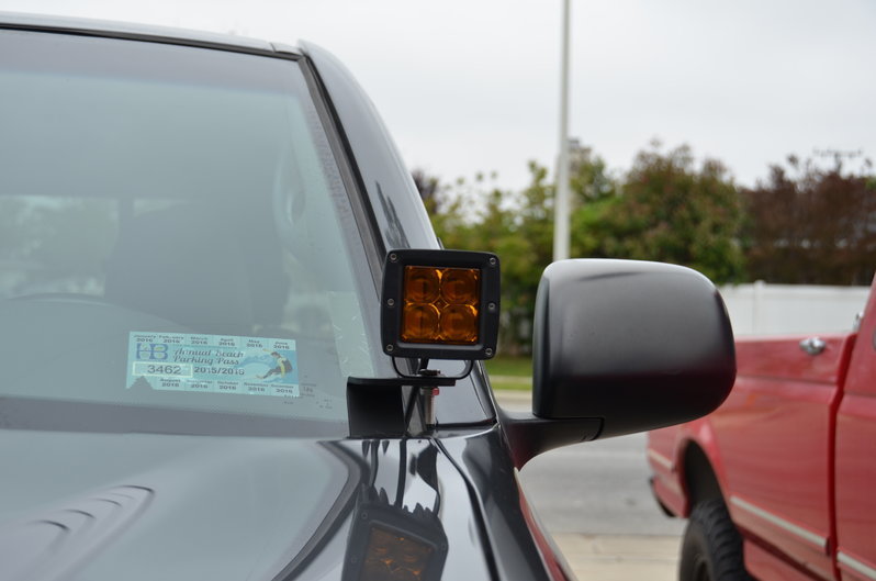

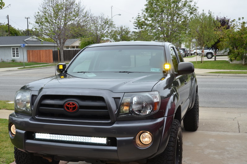

    bolted mine up yesterday in about 30 minutes! really easy to do, only thing that needed fixing was one of the holes on each side needed to be drilled out on my truck about 1cm. besides that everythings good and no hood issues!
