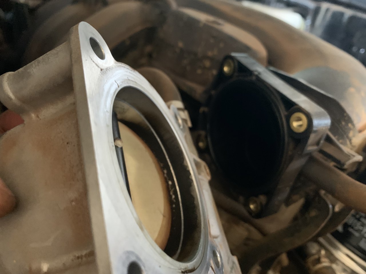

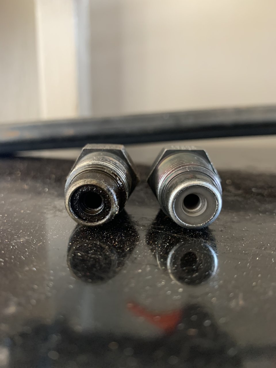

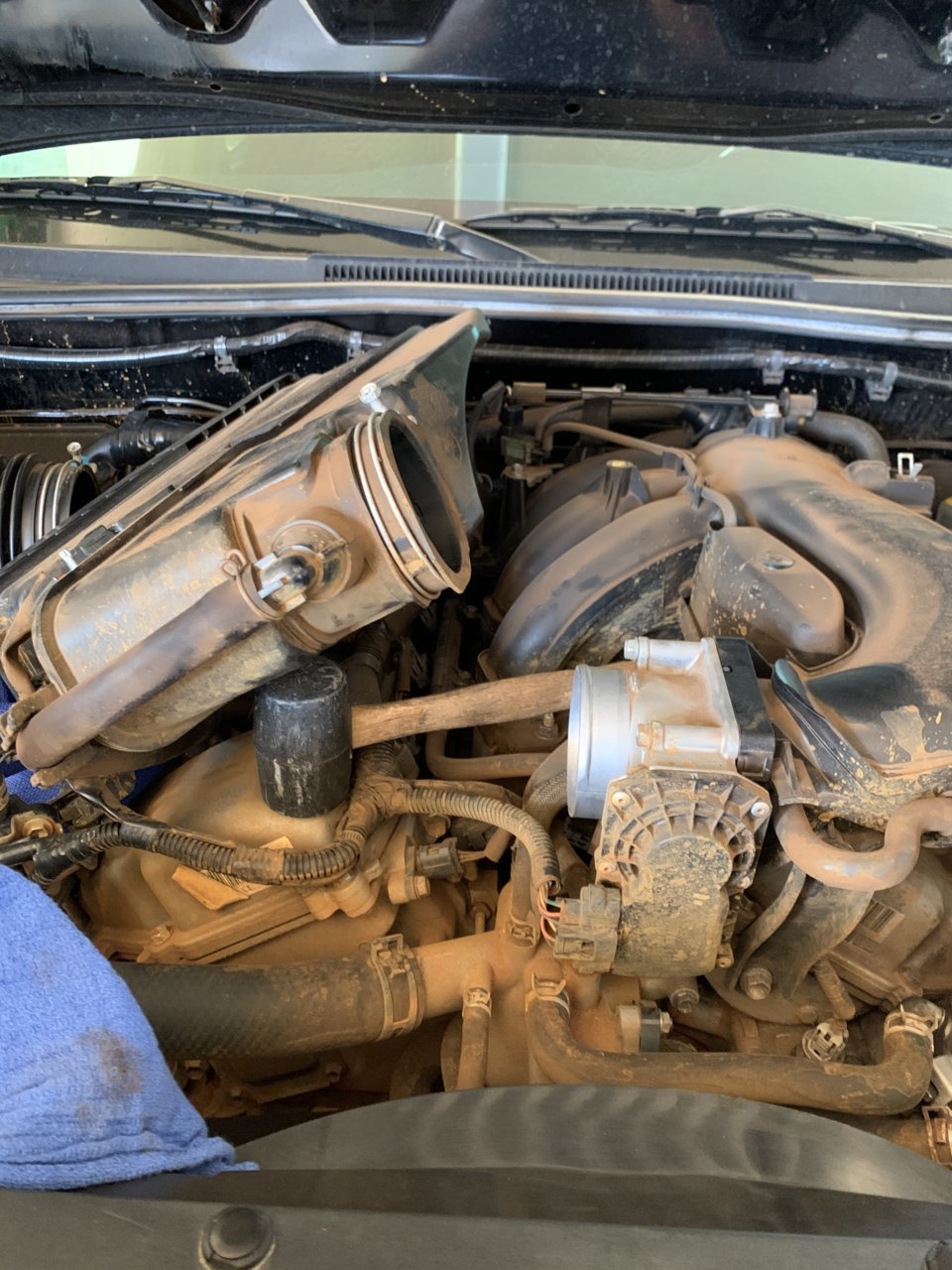

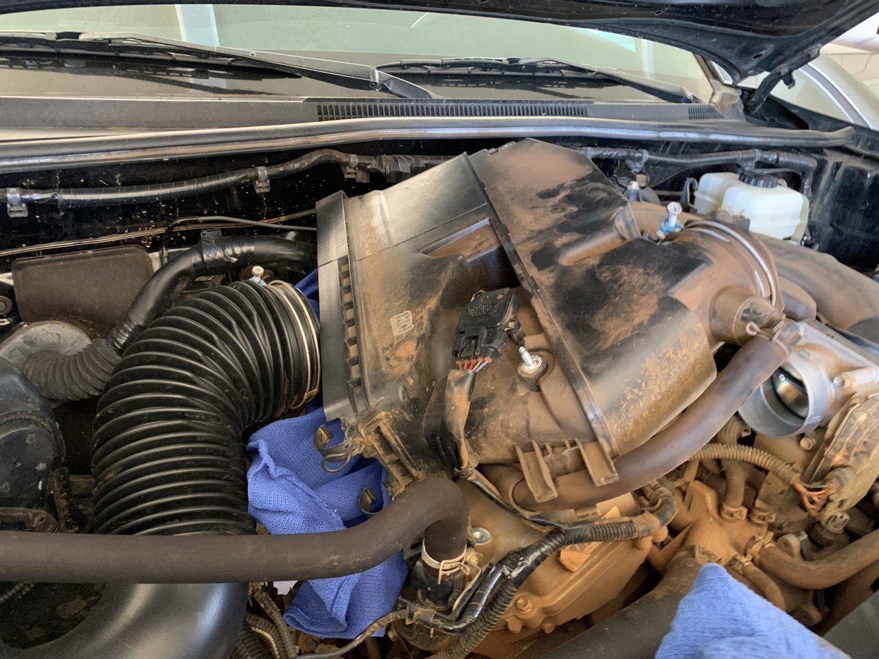

    Thank you for organizing this, OP! I finally decided to replace the PCV, cleaned the MAF Sensor and Throttle Body.
    PCV: Mine was on pretty fuckin good. I was in the arm wrestling position due to the awkward angle. I didn’t have a 6 point 19mm deep socket somehow, but I had a 3/4” which was just about identical in fitment. That link states that it is possible to just clean the PCV but easier to replace and it only costs $4.65 + shipping from McGeorge Toyota Parts. It also stated that if it rattles when shaken, it’s still good and may be re-used. My old one did so I might just clean it up and re-use it next time. “Might” though, I tend to like replacing with new parts lol.
    MAF Sensor: I didn’t see that my dealer cleaned this sensor during any services but then I have a tendency to skim lol. It didn’t look dirty to me but idk how bad it’s suppose to look. I sprayed it anyway and let it sit out while I cleaned the Throttle Body. Had an “Oh Shit” moment and dropped one of the small Philips screws upon plugging it back onto the housing. Thankfully it fell through everything and landed on my skid plate.
    Throttle Body: The front didn’t look bad, but holy shit, when I removed it from the black housing I saw all the gunk and grime on the backside of it. It took a lot of spraying and brushing/wiping with a rag.
    The link to the Throttle Body showed him tying the air intake and MAF housing to the antenna. I didn’t feel like doing that and instead removed the tubing from the intake since it was fairly simple, set the intake aside then used a mallet just to prop up the MAF housing. Felt more stable without stressing anything.
    I’ll go ahead and split my novel into those links accordingly
