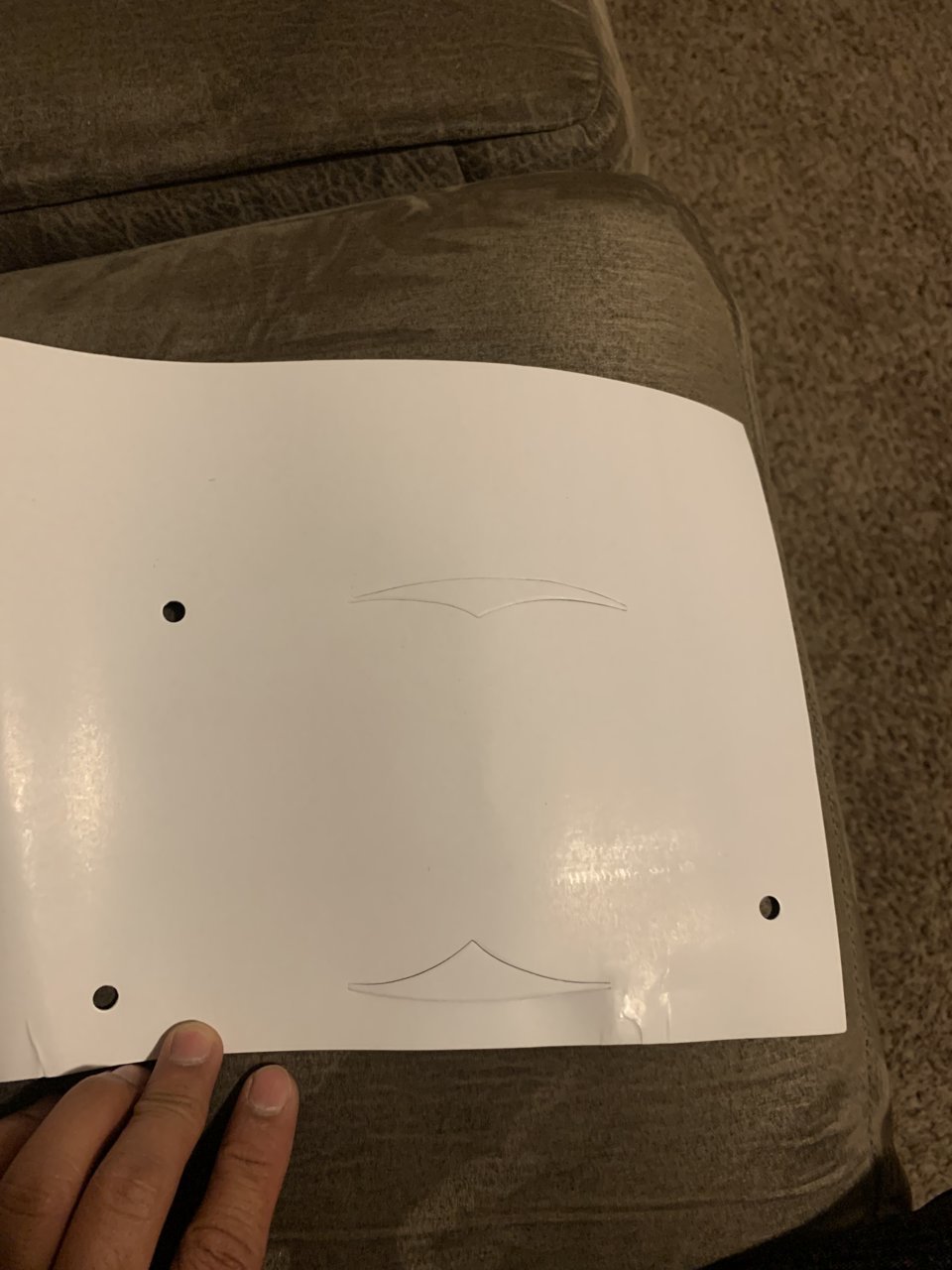

    Hello TW, just received my dobinson snorkel I ordered directly from them.
    I notice the template doesn’t have the marking for me to center my cut for the 4 1/2” hole I have to cut.
    For the owners that have done this mod, do you guys recall if the template has the markings for it?

    I just finished installing mine yesterday, same issue with the template.
    My template was not correct! Definitely call Dobinsons before drilling!
    I made a 2nd template using the snorkel and overlayed it onto the original template.
    My holes where off by 1/2-3/4" for the studs.

    Pretty disappointing! Emailed them about the marking for the center of the hole I’ll have to cut. But their response was not much help. I guess I’ll just center the hole saw on to the template and try to mark the center by doing some measurements.

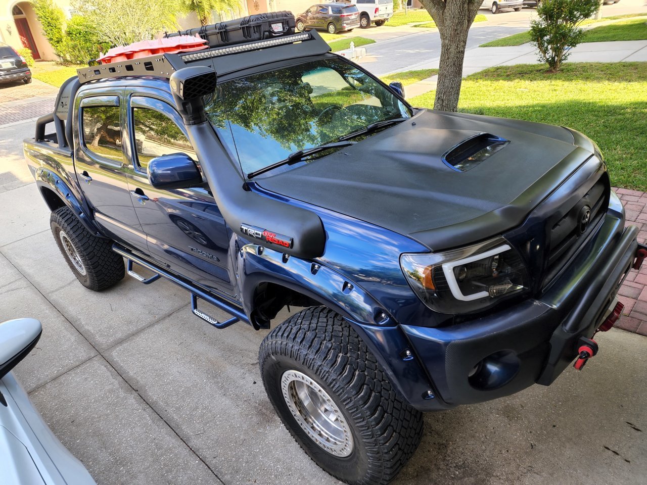

    Dobinson's should be ashamed of themselves that a cheapo aftermarket snorkel like this one I bought on ebay($130) had a very well laid out template. All of the holes on the template were dead on. I added the emblem to increase it's value :thumbsup:

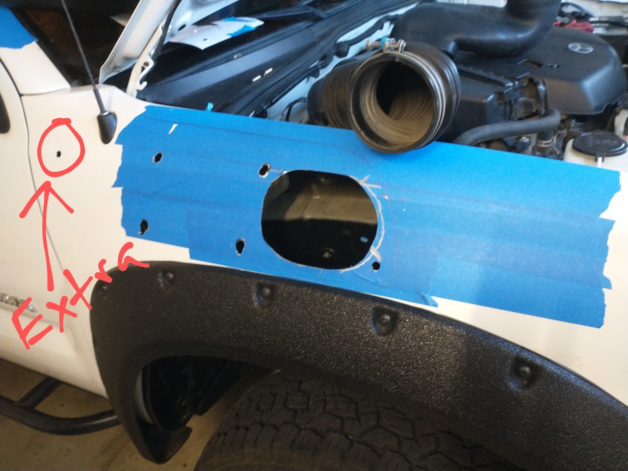

    This has been a problem since they hit the market. Me and and @Chase8059 bought and did ours together. The stencils back then were just as bad and didn't line up. Use the golden rule... measure twice cut once. If I were you I would tape the whole area, trace the stencil and put the holesaw up to the stencil, trace that, and mark the center holes through the where the arbor connects. Measure after to make sure your close to dead center. Hope this helps, good luck!

    What tires are those? Are those real beadlocks? Nice rig BTW

    Yea I would avoid using an angle grinder lol. Just measure a shit load and once you feel comfortable make the cuts. Make sure your stud holes line up though... My stencil was off a noticeable amount. The best thing to do is cover the fender in painters tape and trace everything out and hold the body of the snorkel up to it to be sure.

    Tires are Atturo Trailblade XT 35"(absolutely love these tires)and rims are real beadlocks. KMC km229 17"

    Lay the hole saw on the outlines with the arbor side against the template. Draw the arbor hole. Now find center.

    My advice would be to put painters tape on the fender and some wet paint on the studs of the snorkel. Press the snorkel where you want it to make the spots you need
    Idk if that helps…just a thought

    I also installed the dobinson snorkel, and my template was shit. Home marking were way off and I had to enlarge the holes to get it to fit. Stupid.
