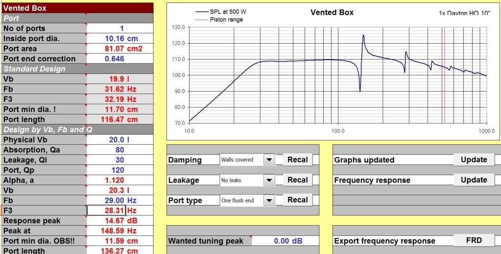

    Here's what I'm coming up with.
    0.7 cubes tuned to 29hz.
    Notes: It's only available in a single coil version and that's the 4ohm coil. 450 from that Nine.1 should be enough so I wouldn't worry about that. You wont run out of Xmax till about 25hz running full tilt with 450 watts. I would recommend a subsonic filter set there if you jam pretty hard but I doubt you'll need one.
    The ports will be your worst enemy. I think you can get away with less than a 4" port but 3" is cutting it close. The other thing is that even with a 3" port it needs to be roughly 28". That's doable but it takes planning since you'll have to essentially wrap it around the motor of the sub.

    Looks great, matches my stuff as well.
    I think Chad got away with a smaller port, but thats another subject.
    If you are putting this on the passenger side, you have about 32" to work with, so a port running the top of the box (shaped to the box, or round) would be long enough.
    If not enough space up there, wrapping it is the only option.

    That response curve looks great! If I can find a way to make a box work back there I will go with this. I've yet to actually take out the plastic behind the seats and measure anything so I guess that's my next step.
