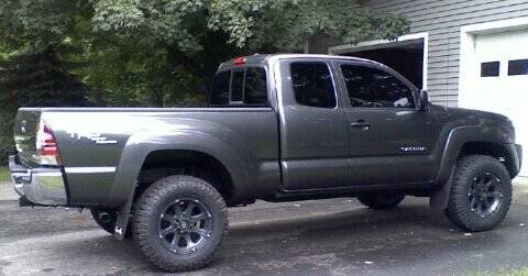

    Eibachs at 0 w/driver side lean spacer. 2 in. toytec aal, no tsb, 265/70/17 Duratracs on american racing atx ledge. This gave 1.75" lift front and 2.75" lift on rear over stock. Truck only has 2,500 miles and no heavy loads really. If could do it again, I would go with the 1.5" aal or a complete spring pack. Rides good but a little shutter at take off. The carrier bearing drop shims helped but didn't cure it.

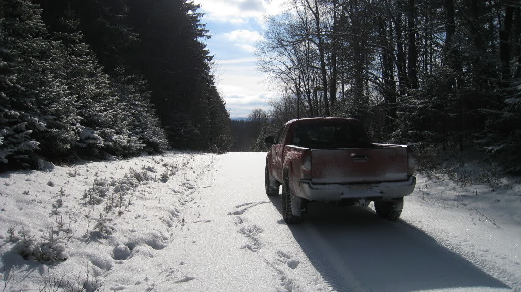

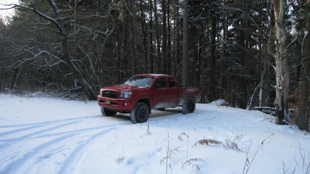

    Hard to tell from the pictures but I have the eibachs at .85 and a wheelers 3 leaf pack for 1.5 inches in the back. Right now Im running 265 70 17 but would like to go up to 285's. Dont know if they will fit.
    The lift is great. CV's are perfect. No vibes and drives beautiful.

    The shudder at take off is generally axle wrap, something an AAL is supposed to lessen. Who installed the AAL? I would make sure the u-bolt nuts are torqued down properly, 73 ft/lbs.

    A local shop did the install. I've checked the u bolts and they are tight. Not sure I can blame the lift completely though. When brand new and stock, it had an axle wrap thunk on take off. Now it shudders at a higher frequency and you can feel it in the shifter. I might make the long trek to the dealer and have the tsb springs put on it. Then again, I might just trade it off next year anyway cause I don't think this one is a keeper.

    Do you have the pinion angle shims on the spring pads? If not they might help, you can get them from Toytec.

    I have the pad shims from toytec, but haven't put them put on. They came with no directions and i'm not sure which way they need to go. Should the point of the wedge go to the front or the other way around? Good thought tho, maybe i'll try that. tx.

    The pointed edge to the front, fat end to the rear. If you already have them, its worth a shot installing them and see if it helps.
