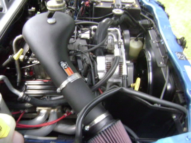

    Very old pic of mine. I haven't measured a tacoma radiator but the fan is larger in person than it looks in that pic. Maybe it's just my little screen from tablet.

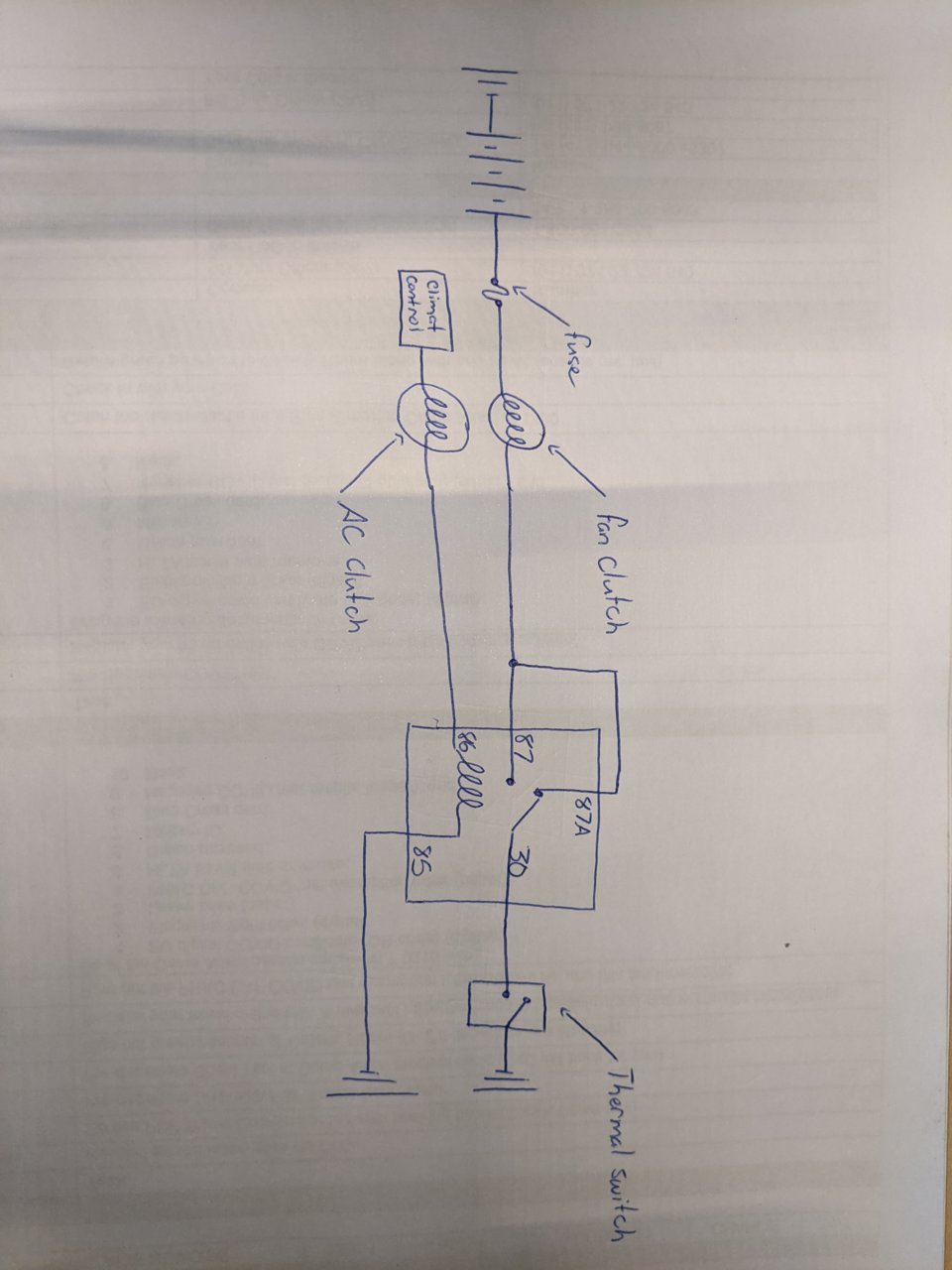

    I would think that the best of both worlds would be replacing the viscoupling fan clutch with a electromagnetic fan clutch. I have yet to find a replacement that would fit. Would work well too. AC clutch power to the 86 pin and ground 85 and 30. Then put the clutch on 87 and 87a. 30 would run through the thermal switch to ground. Now you'll have cold AC in traffic too.

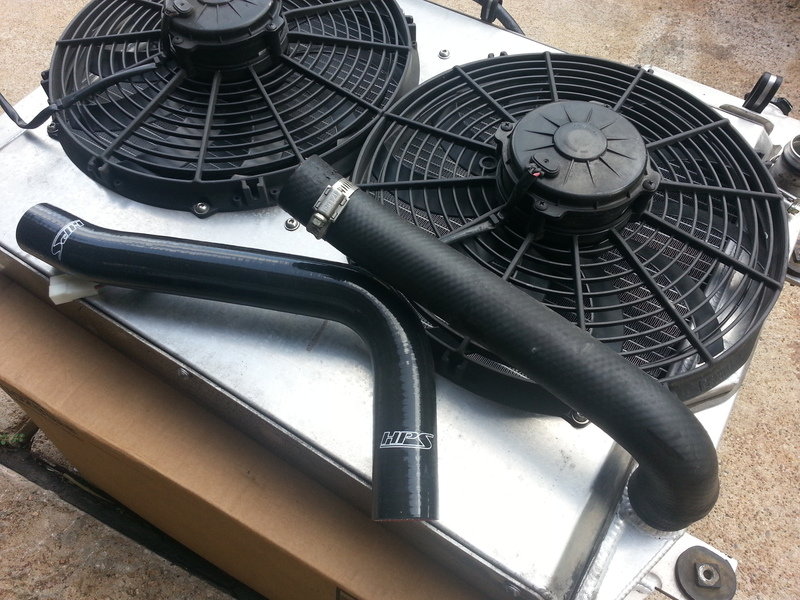

    Can you post a link to this double fan?

    MMVI 4.4L 4x4 Access Cab
