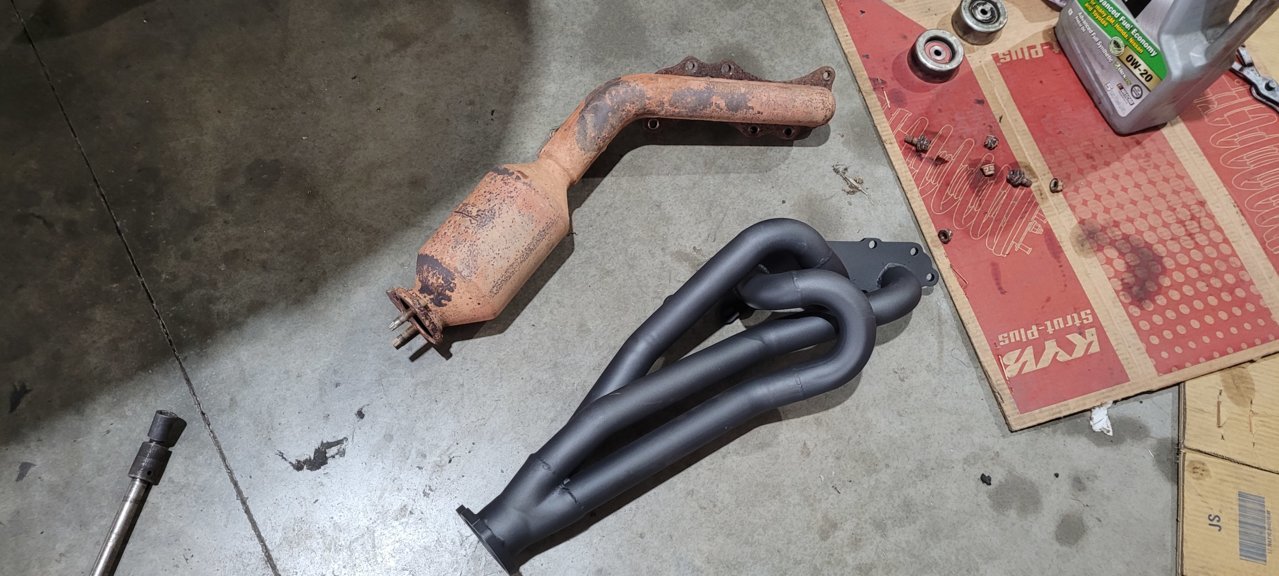

    OP i had the same needs. I ended up getting URD headers
    https://www.urdusa.com/product-cate...headers/?filtering=1&filter_product_brand=591
    Good results from these! Feels like more power everywhere but they're expensive. If I was gonna do it again, I'd just cut the primary cats out and weld in a straight section.
    I also got the Exhaust cam gears and they also perform great and feel like they make more power and better running. got them from @mightytacoman but URD sells them too.
    Next on my list would be hpTuners. Haven't tried it yet but it probably is the best bang for buck.

    It’s one thing to say the headers, cam gears, and a tune don’t do much of anything.. When you don’t have any of these parts installed.
    I bet you’d have a HARD time finding someone with them, especially all three to echo they don’t do much of anything.
    ..and before the “show me the dyno” posts come. What if I told you some of the biggest gains are at part throttle, in RPMs and loads that you use in your daily driving..Not just at WOT at peak load..

    URD Spec U headers and the Spec U catback will be the most solid exhaust system in terms of gains.

    I have personally ran the Spec-U exhaust with and without a tune, Spec-U headers and Spec-U exhaust with a tune, and just the Spec-U headers with the stock Ypipe and stock catback.
    Going from the FULL Spec-U system to just the headers, I lost 5g/sec of airflow at the rev limiter while picking up a ton of torque between 1600-2500RPM. The Spec-U exhaust has a really long secondary runner length which favors higher RPM operation that is outside the limits of a stock 1GR.
    On a naturally aspirated truck, the stock exhaust isn’t a restriction. The stock manifolds and cats are.
    I sold the Spec-U exhaust and kept the headers.

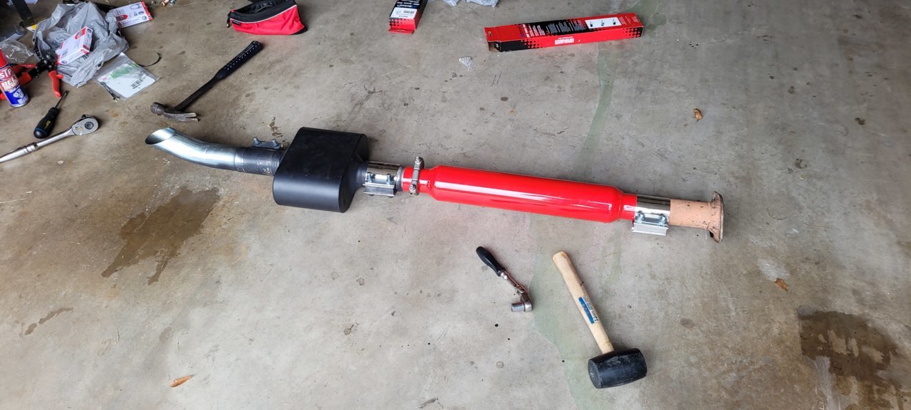

    I currently have the spec u headers/rear o2 sims + stock y pipe with 2.5" cherrybomb resonator/super 10. Also am running a volant with front ram and snorkel, 3* camshaft gears and urd maf tuner.
    It is uniquely fun to drive, all the weight installed is negligible after the additional power adding mods. I do agree the manifold and cats were the biggest bottleneck but without some way to adjust fuel trim, you dont get the full performance potential. Not to mention it smells insanely rich running the spec u headers and stock fuel trims.
    After reading ill probably just upgrade the y pipe and call it a day.
