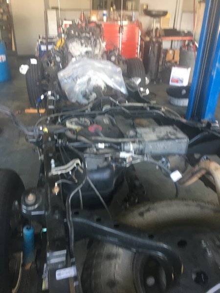

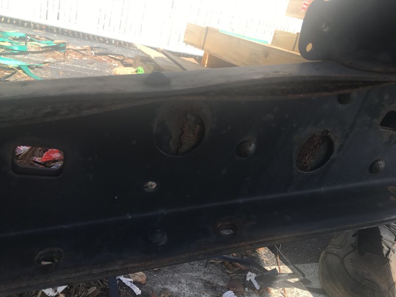

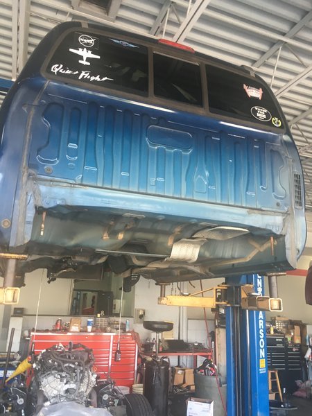

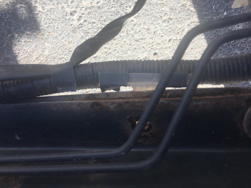

    My frame replacement is in work. Pretty amazed at the damage and perforations in my original frame.

    3,115
    Just curious, did your frame fail because of the expansion of the frame layers in your pictures or did you also have holes/perforations (10mm) too?

    There were 4 spots where there was a physical holes in the frame, and the swollen areas.
