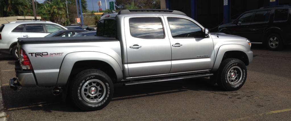

    So I've been wanting to level the truck. After reading quite a bit, I went ahead with Fox 2.0, part number 985-02-002, which comes with Eibach 600lbs/in springs. Basically I wanted to level it without sacrificing too much ride comfort. I was quite surprise the ride is better than the stock TRD suspension (I expected it to be a bit harsher), drove through pot holes, speed bumps etc and its absorbs everything quite nicely, it doesn't jar the truck and its not bouncy, its overall a very nice ride. Installation went smooth; with help from a friend we installed pretty much the same way as most have posted in the forums (Thanks to those who have posted installation instructions.). I went ahead and had it aligned, but I may take it to a different place soon as they were not able to get the caster to around 2.5 which from what I've read in the forums it should be possible with a 2" lift. Right now its at 1.5 with toe and camber at pretty much 0. I drove around and took it up to speed in the highway and it felt fine, straight and no wandering, so not sure if I should have another shop give it a shot or not.

    Just installed the same kit and I have aftermarket tires but I was able to get in alignment spec on one of them it was very close.

    Did you adjust the shocks to compensate for the bumper? What were your final numbers for the alignment?

    No I Put them on how they came out of the box, and still got 2" of lift upfront.
    front left
    .8
    1.7
    .03
    11.4
    12.1
    front right
    .8
    1.3
    .03
    11.2
    12.0
    Front
    -.1
    .4
    .2
    .07
