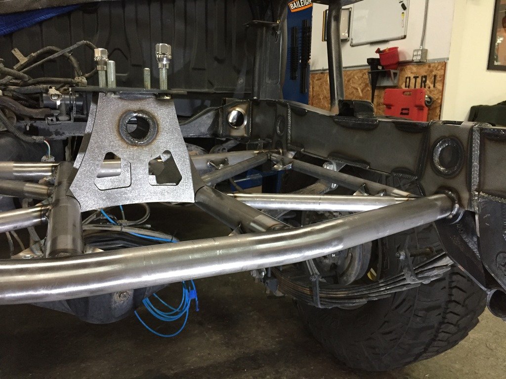

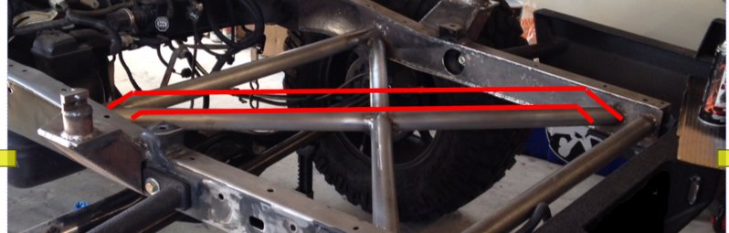

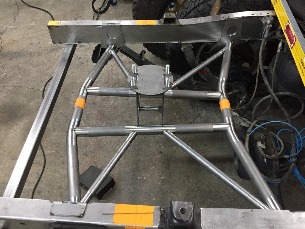

    You could easily transfer that OE spare winch mech over to any cross member you build. You would just want to tuck you tubes up high and tight to the bottom of the bed to maintain ground clearance vs. how we used straight tubes on mine. IE: bend your tubes like this :

    You know anyone with a shop that has a lift ? You just need to be able to anchor to the floor and winch to something sturdy up above...raised lift arm maybe ? I bet if you stripped the bed off and went to a good body shop they would only have to charge you an hour of labor to pull that one frame rail ?

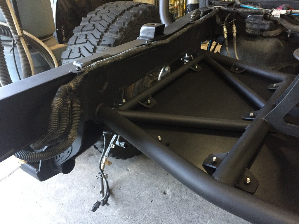

    Some Stuff
    :thumbsup:
    Texoma and stairgod[QUOTED] like this.
  13. Jun 2, 2017 at 5:03 PM
    #413
    Texoma
    Texoma IG: Triple C Chop Shop
    Feb 1, 2011
    #50374
    18,966
    Chris(Topher)
    Lago Vista, TX
    10 Taco 4x4
    A bunch a cool stickers, a bada ass MetalMiller Tx Longhorns grill emblem painted Hemi Orange, JBA long tube headers with o2 sims, Diff breather mod, Red LED interior lights, Fancy head unit that plays ipod n movies, Also DIY install factory stuff like, factory cruise control, factory intermittent wipers, OME nitro struts with 886x springs and toy tec top plate, JBA high caster UCA's for better alignmnet and dey beefier too, Old Man Emu Dakar leaf springs in da rear with the gear, U bolt flipper, Ivan Stewart TRD rims with 33" K Bro 2's, some bad ass weather tech floor liners so I don't muck up my interior, an ATO shackle flipper for mo travel in da rear wit the gear, also super shiny Fox 2.0 shocks back there too, all sorts of steal armor for bouncing off of the rocks like demello sliders, AP front skid, trans skid, n transfer skid, demello gas tank skid, and a tough as nails ARB bumper with warn 8k winch, I'm sure there's more

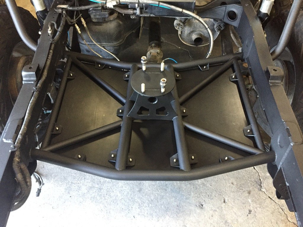

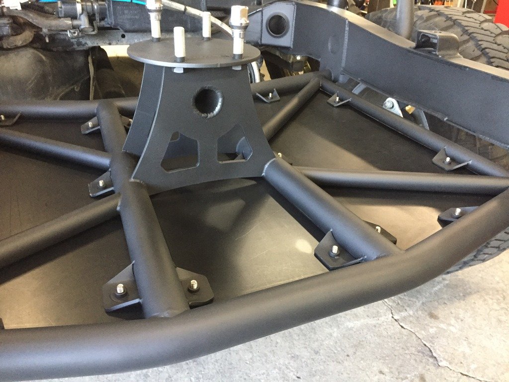

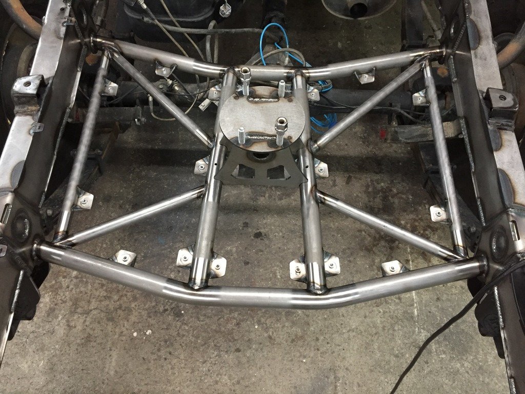

    I really like what you did there.
  14. Jun 2, 2017 at 6:13 PM
    #414
    HolyHandGrenade
    HolyHandGrenade NOOB
    Mar 25, 2013
    #100579
    11,801
    Tim
    Garage Most Likely
    DCFB (RIP)
    Some Stuff
    My buddy made the crossmember and a guy at work welded it all in. I do really like the way it all came together though.

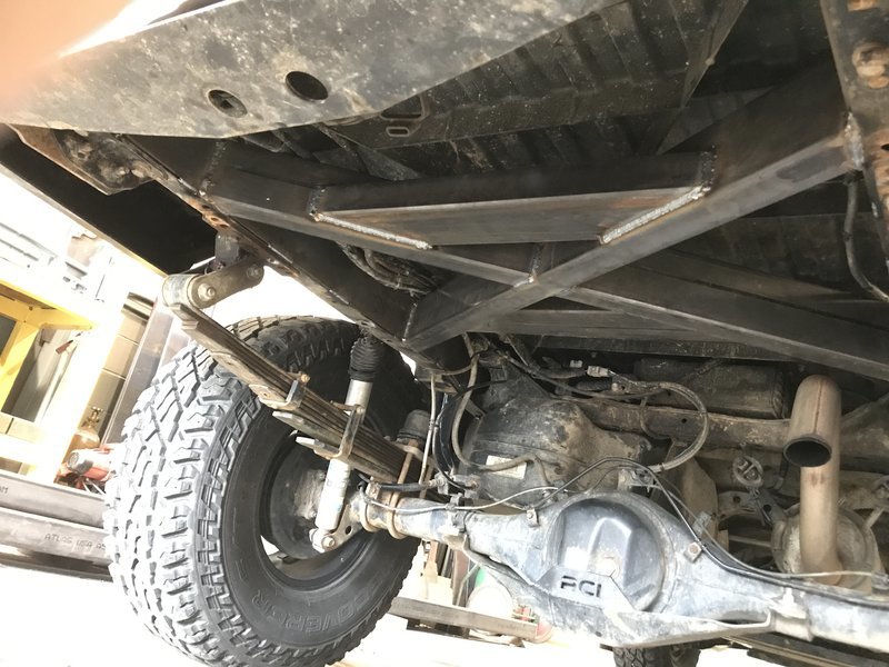

    My fabricator was pretty impressed with the fitment of this kit. FYI, he did found some stress cracks in my frame prior to boxing them up.
