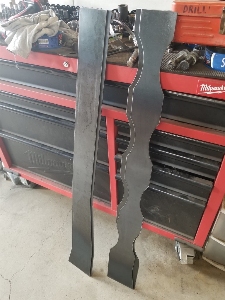

    I have a few sets extra I cut out if your interest it period Fridays are my shipping days now so if you order before Friday good chance is I'll have it shipped by that Friday.

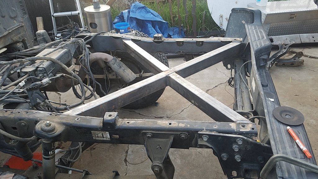

    I'm interested in a set of these plates, but it might be a month or two before I have the funds to order. I have a bolt on camburg SUA setup on the way. I was curious about doing cutouts to access the bolt locations. In the picture, it looks like that was done with that Archive Garage kit. Is it better to do single cutouts for each fastener as in the picture, or would a single long cutout be okay? Also, I read here or on the LT forum that the rear rails get out of whack easily when the spare tire crossmember is taken out. Is the best solution to weld a bar or two across the top of the frame rails to hold everything in place before removing the crossmember? Thanks.

    You could leave on the rear bumper. it is acting as a cross member of sorts and keeps everything square while you cut out And replace your rear spare tire crossmember.
