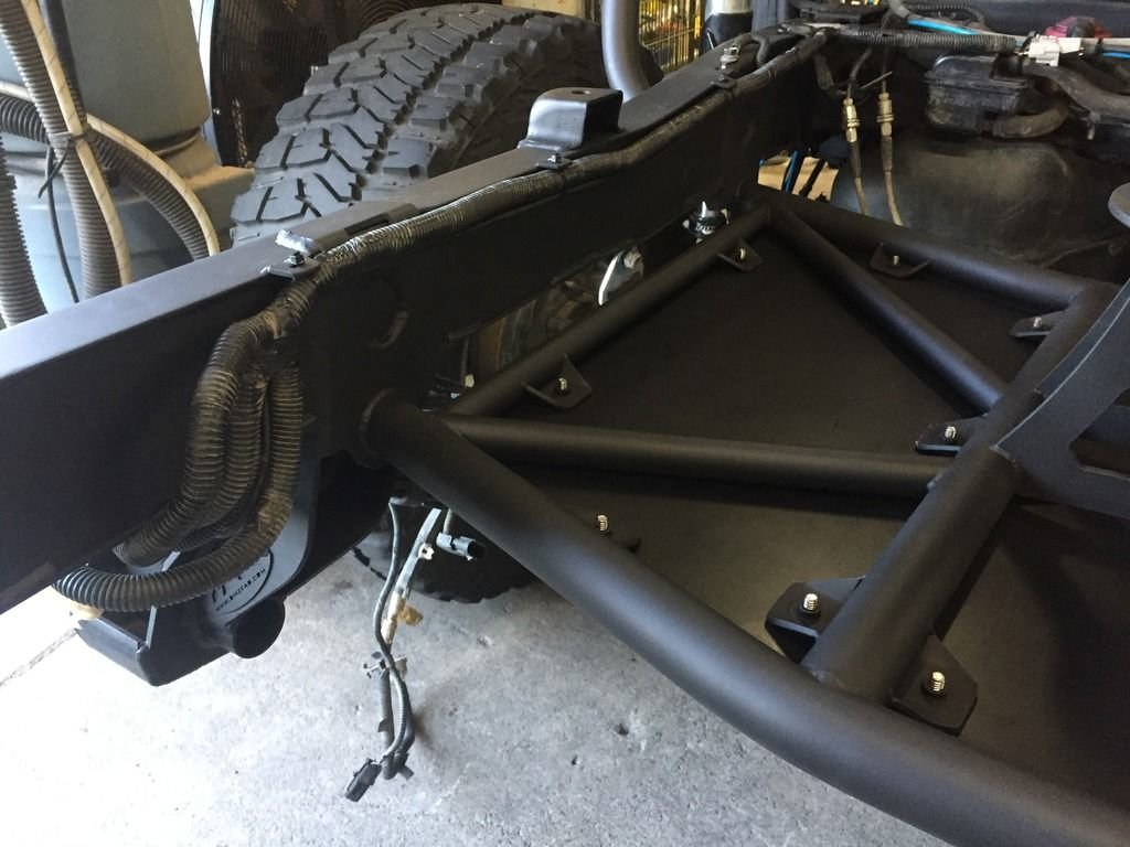

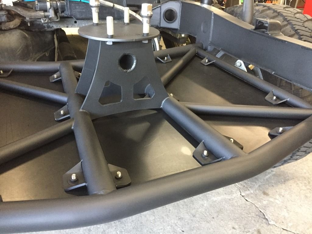

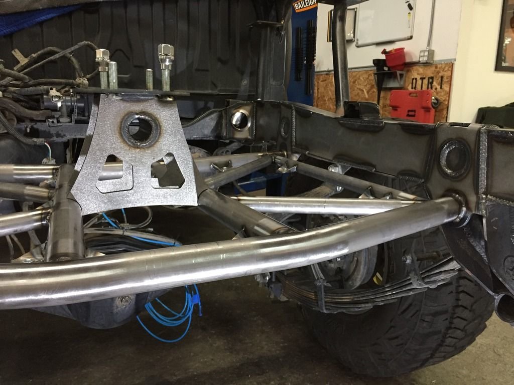

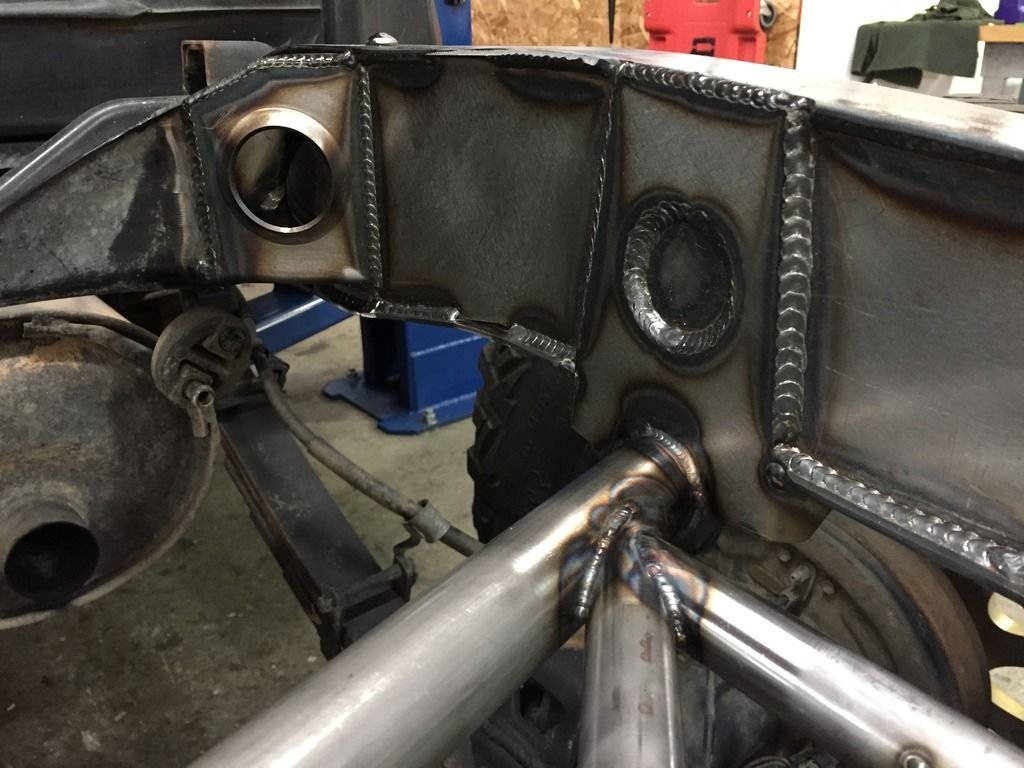

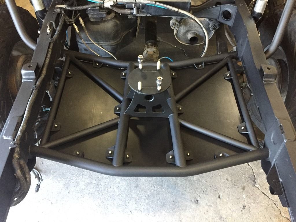

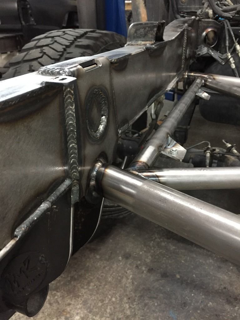

    Buy the precut plates if they are available. I purchased the ones from the OP and my welder said they fit perfectly and saved him a lot of time. He could have made the same plates, but it would have cost a lot more for his time. Even if you can cut your own plates, buying precuts ones is a no brainer especially from a shop like DMZ.
