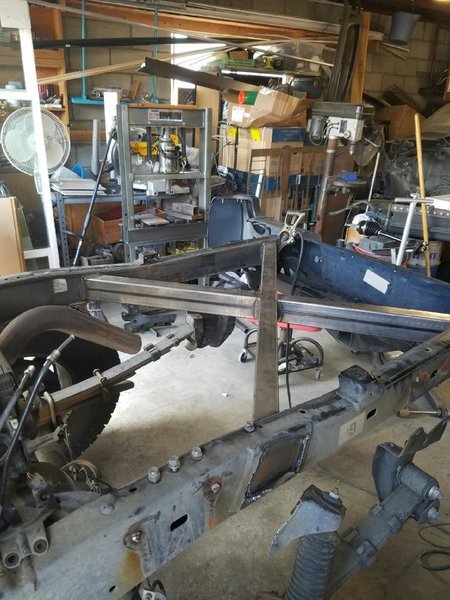

    Get the solid ones and cut the Windows you need before welding them in.

    Yea I'm getting solid. Idk what I would need Windows for honestly.

    You can cut some in so you can service your rear bump hardware since those nuts would be concealed with it solid.

    I believe @iJonny used windowed plates to help with rust prevention as well.

    Even though PHX is such a dry place and rust is less likely i went with plates with drain holes. I just didnt want standing water inside the frame. These plates add so much strength to the frame in the rear its worth the cash regardless. Jeffs got a sweet product and anyone who bombs whoops or has a lot of weight plus a swingout should do this.

    Are any of the 10 sets windowed, @jeffz0rz? I'd be interested if so. If not, I can wait, I'm not in a rush.

    A window set is only a couple Mouse clicks away.

    I didn't go through the whole thread so this might have been asked.. but is this portion of the frame the same on DCLB and the shorter DCSB/ACLB?

    Yup. Same section

    Wow, that is some heavy duty cross bracing.

    Thats called the Jeffz0r no-breaking-your-frame crossbrace :rofl:

    Cool. Looks like you're doing a shock relocate at the same time! That's kinda what I was thinking... I want to set my truck up with some longer shocks and 63" leafs, figured I could do the frame plating while I was in there. Currently sourcing parts and saving nickels for that project...

    I now have a set that is designed to go around the factory rear cross member. Three pieces each side. removal of the factory rear crossmember no longer necessary.
