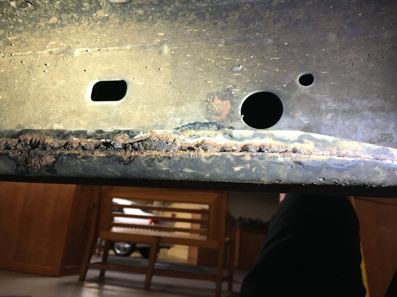

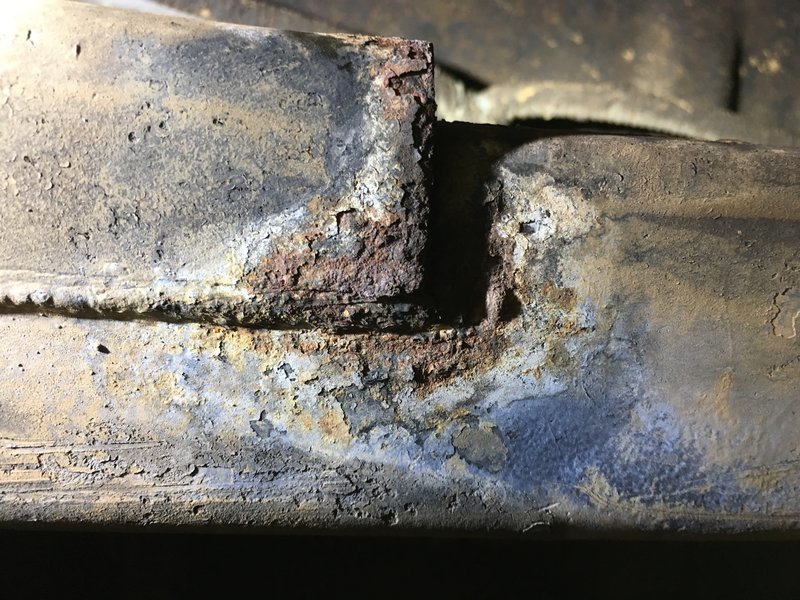

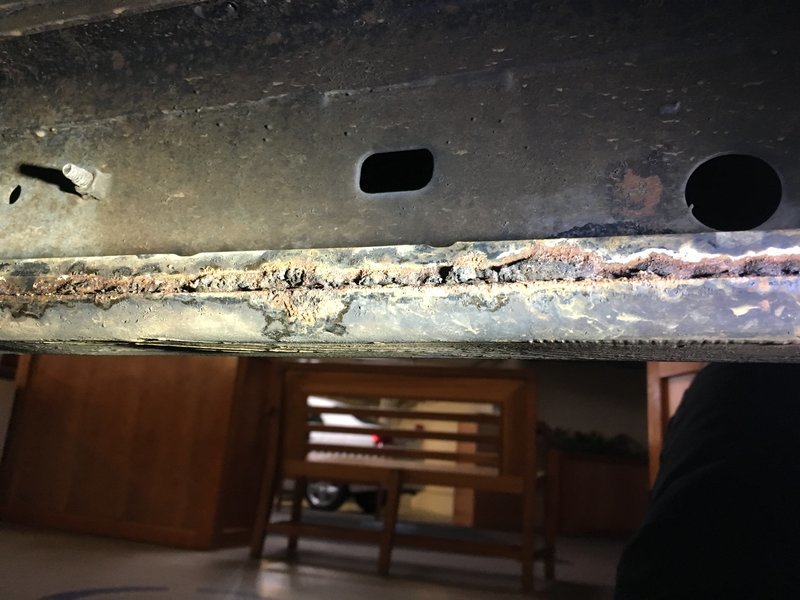

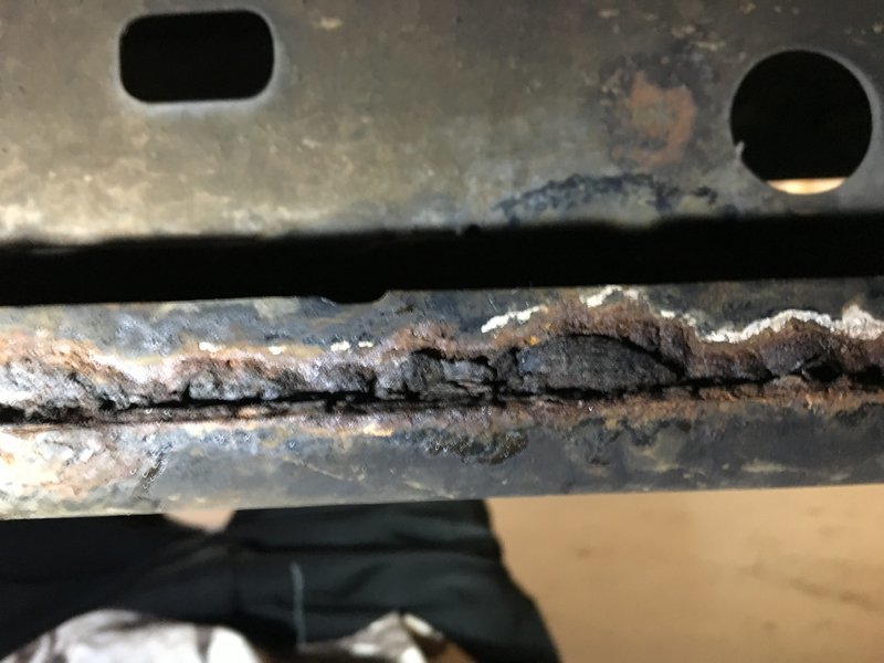

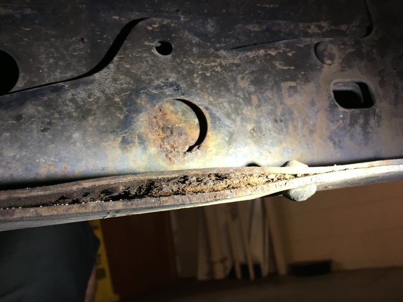

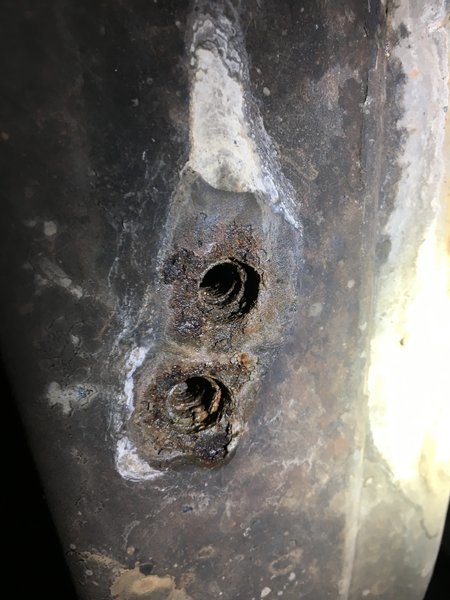

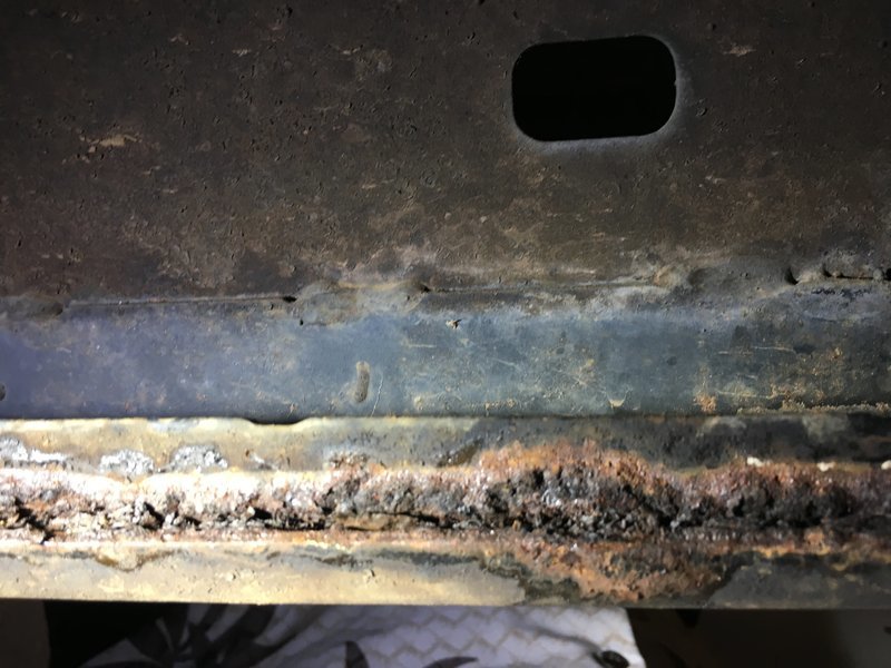

    Hey guys, doing my first post & was hoping I can get some help/info regarding frame rust repairs. Did a bunch of research already, & yes I did use the search bar A LOT, but I figured I'd ask with all the knowledge floating around the forums! I apologize in advance for the length, just trying to be thorough!
    First things first, I have a 06 6-speed 4x4 access cab with just under 62,000 miles on it. My truck passed the frame recall in February 2016, but I asked the local dealership if they could re-inspect it since I'm getting my rear leafs checked anyway. I've checked my frame occasionally, but really noticed a lot of scaling/bubbling lately, specifically in the area where the a/c condensation drips & in the area underneath my passenger doors (see pictures). I know it's probably caused from the a/c drip (attaching a hose/tube soon) & im pretty sure it won't fail since it doesn't meet the criteria of having at least a 10mm hole & I want to get rid of the rust before it gets worse.
    IMG_2120.jpg IMG_2121.jpg IMG_2122.jpg IMG_2132.jpg IMG_2133.jpg IMG_2136.jpg IMG_2137.jpg IMG_2138.jpg
    I plan on using a wire wheel brush to take off as much rust as possible followed by Eastwood rust encapsulator & some por-15. Or I may possibly take it to a local shop that does the rust-proofing for the Toyota dealership on our island, in place of applying the por-15.
    Im certain there will be areas I cant remove rust since I won't be able to reach it & I am wondering if it would still spread, even while treating it . It's gonna be my first time trying to do something like this & I need some tips on how to do the job well. Any help is welcome since I will definitely need it! Mahalo in advance guys

    Assuming you bought it before December 2, 2016 I would do nothing until the current '05 to '10 class action suit settlement is final. It is expected to be ordered on June 26, 2017. Once the final order is entered you can have Toyota inspect it as often as you like until June 26 of 2018 or 12 years after your truck's original date of service--whichever is "longer". If perforations of > 10 mm are found the frame will be replaced. If there are no perforations > 10 mm use whatever artistic ability you have to make some...

    Looks like your frame got the CRC treatment. Mine got the CRC crap. The bubbles are rust growing under the coating. I've been picking the scabs and coating the wounds. May have screwed myself by not leaving it to its own demise. Not sure if I should keep doing it or remove coating and pack it with corrosives.

    That last picture looks pretty bad .I just cleaned up my 2008 with a drill and wire cup brush . Sprayed with Rustoleum rust reformer . Couldn't reach behind muffler or gas tank . My frame isn't too bad because I cleaned and painted every year because of all the salt on the roads in the north east . I plan on por-15 this summer . I will post some pictures later after the rain stops.

    Only way to get rid of rust is to sand blast or use a needle gun. Wire brushing will only get top surface off . If you needle gun it you will see a lot of pitting and also how deep the rust can penentrate the metal.
    Kind of surprised to have that much rust in Hawaii . Go to beach a lot .
    Might want to wait for class action suit to be settled like cliffyk suggested .
