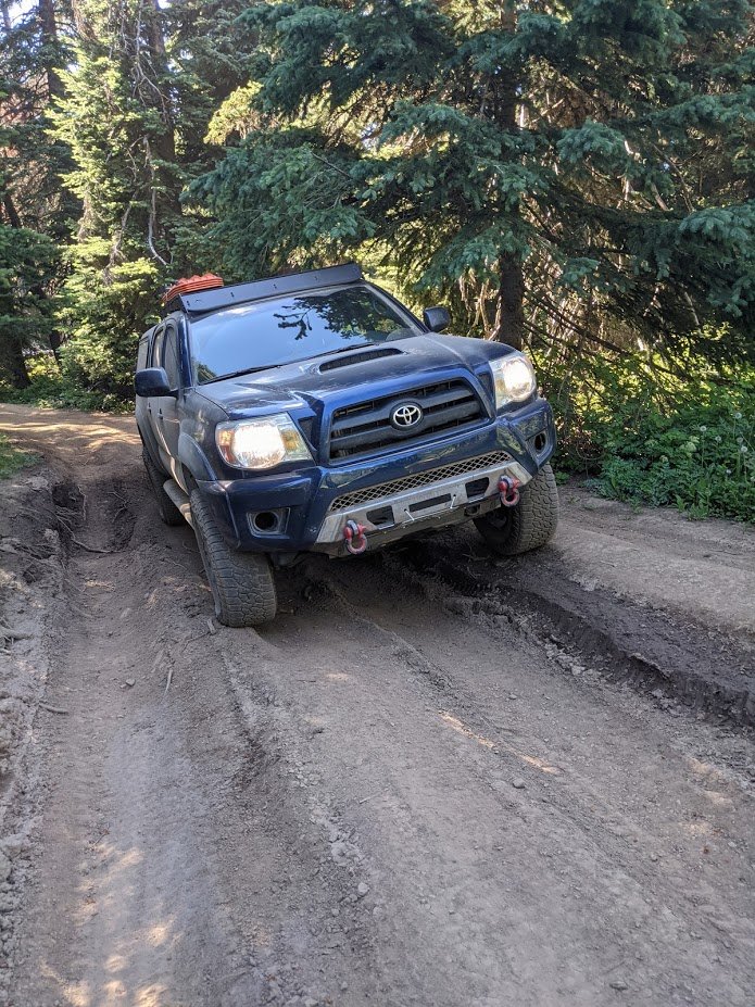

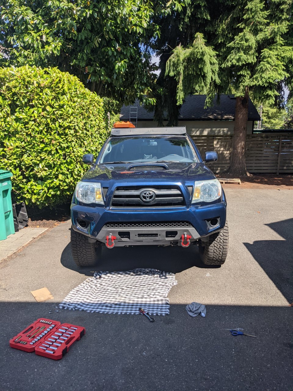

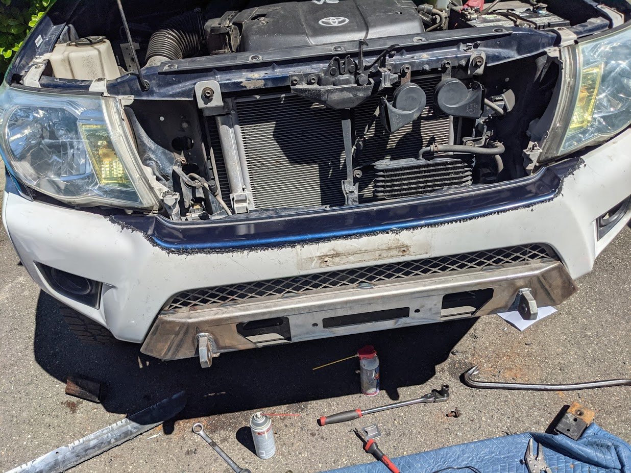

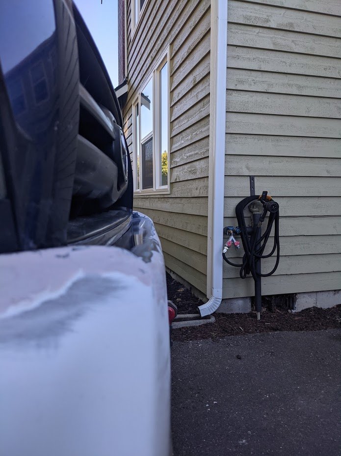

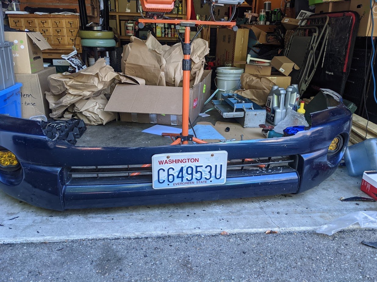

    57k1gSD68tdTZnTa27g5NW6QqQ9wCxzShy80Ki-y_3c37fbd6ef3e057d2b1745538bf374442b8d6292.jpgFW8q0xV9-KCw5DqIJ-7fFYWcbUD9Jc6ncfQ8U3of_c62c1b8128c6b616df1950a389620101e8f783cd.jpgTnc-rMgS83DD-P4ZHF5nIcgTOXC8HpR5b-szEFgW_d143b8f869fd085c3bea3ce06284db04a69a4ce8.jpgzujGZRNWM09GS2azXPHfpFOUlojs1cJHMXiVTaTk_a43d23d04f2b65984e887f92d6f03f0029f6739d.jpg
    i took a soldering iron and melted the top of the 2nd gen to the bottom of the 2.5 gen so i could fit the stingray bumper. with the soldering iron i did lots of tack welds then melted zipties to fill in the extra, after that i did steel wool on the backside to reinforce it more and melted that in with it and then bondo on the front to smooth it out

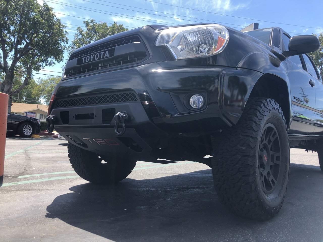

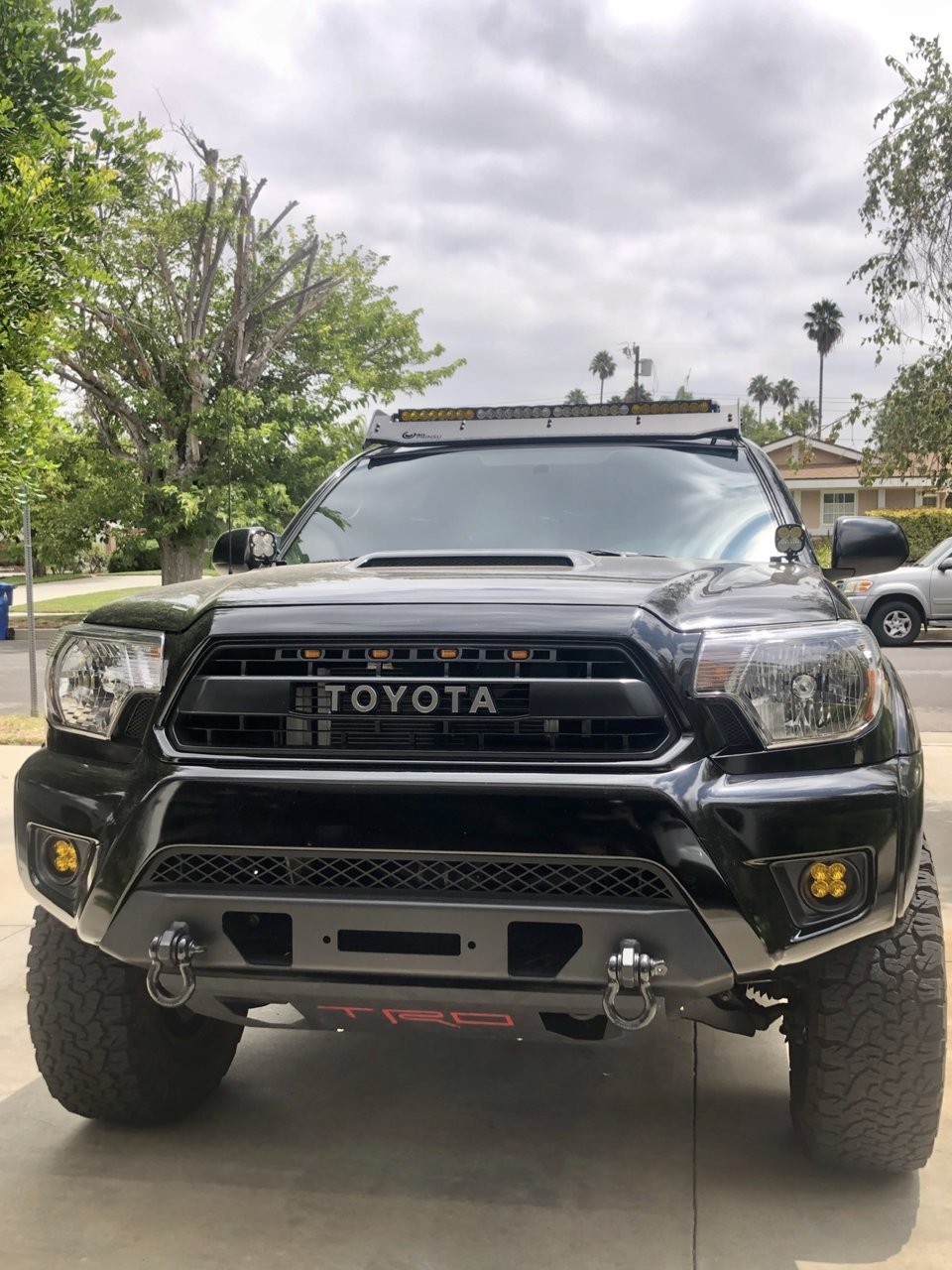

    Heres a 12+ bumper on a 2010. @inesshell
    Kolter45 and inesshell like this.

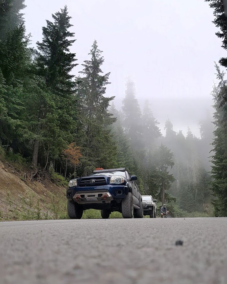

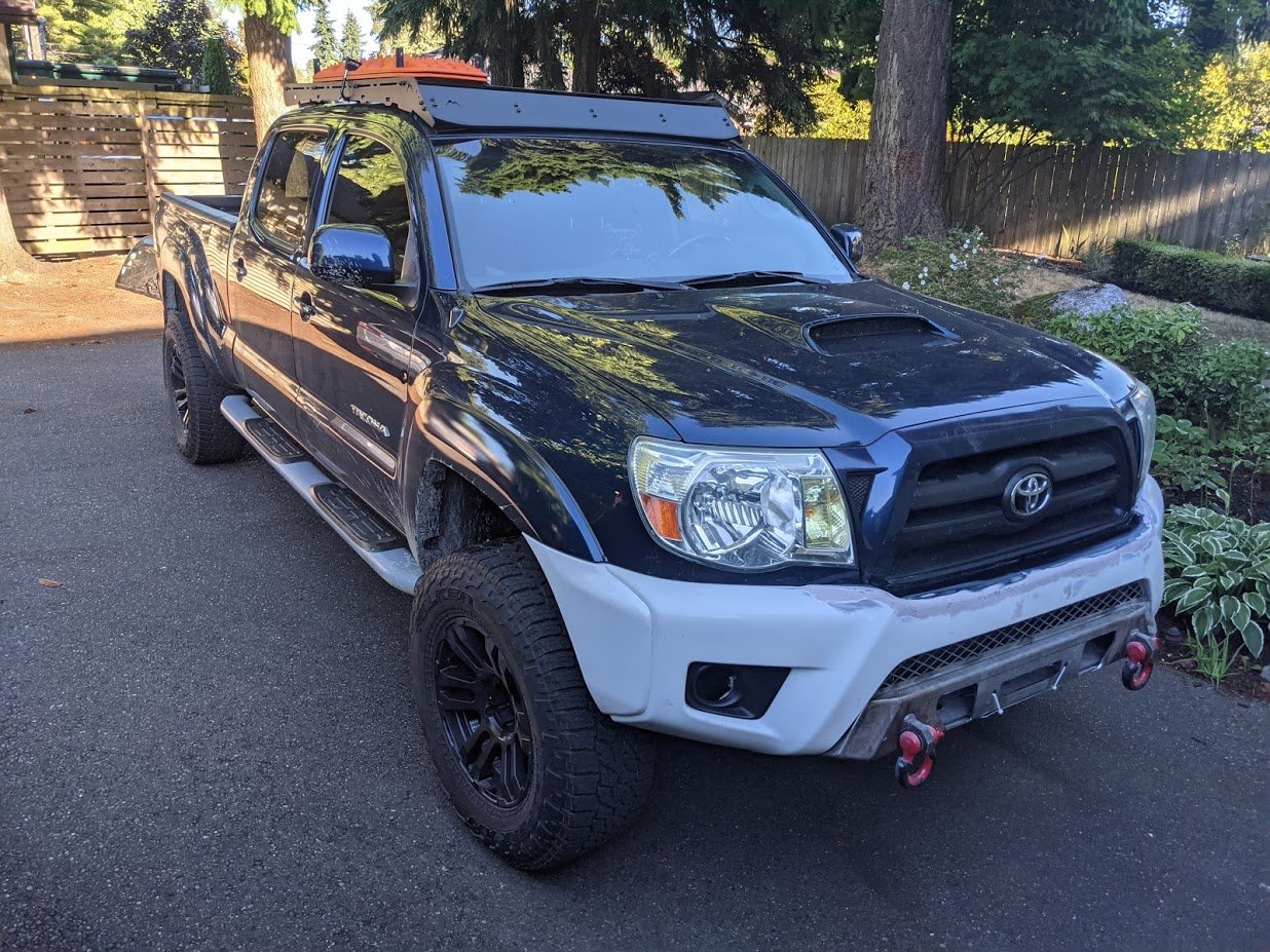

    IAdjxHmdjyDX3BqQ-crzONLBWDqBwgzHhDx5zrHr_40331a2e9623f0ab1f3ca6ba1a0a26eae011d8c5.jpgmFyMU2u0V4uIFpWkfa6xp1YZbMJXx-EiPuP06rNH_af9b1e07e25147c49f24ce818f3ddac41a5f07a5.jpg
    waiting on foglight brackets and still have to get the stingray bumper painted but turned out good
