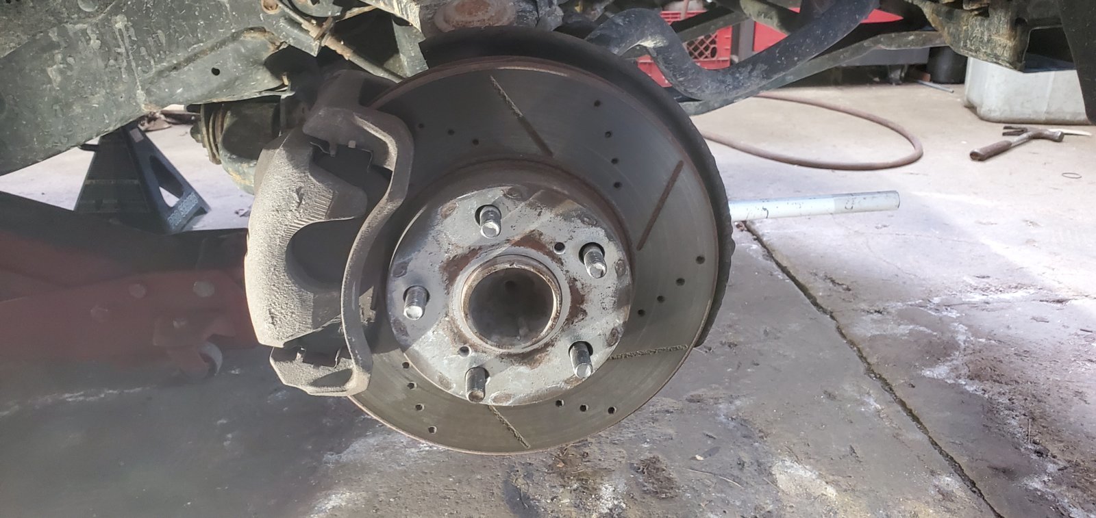

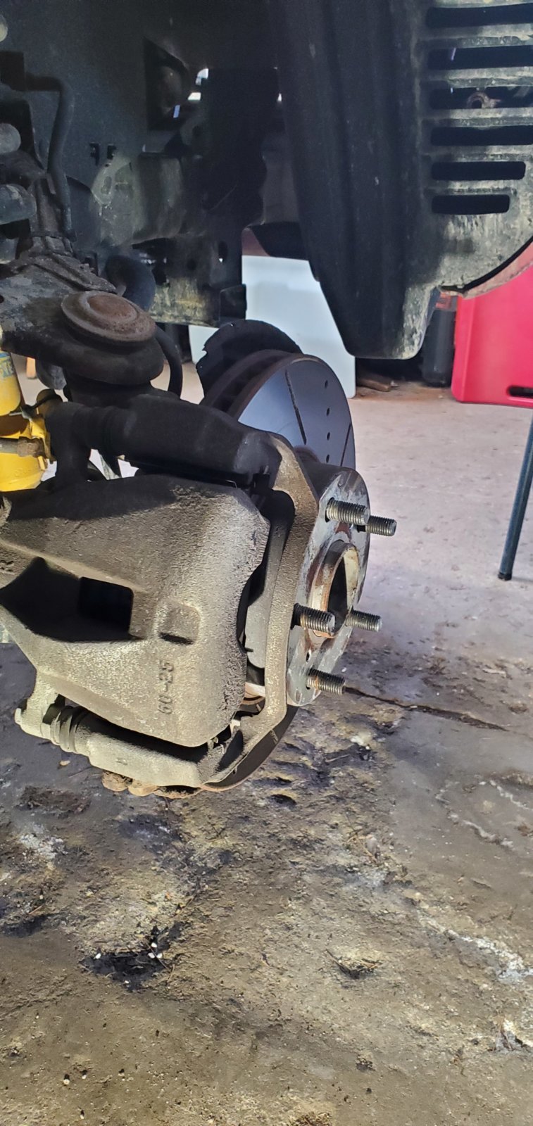

    Anyone have any experience with swapping the front disc calipers on a 2009 5lug auto to some thing other than the stock ones? I'm mostly interested in it for increased clearance for aftermarket wheels that have a broad mounting surface.
    Here a couple of pics:

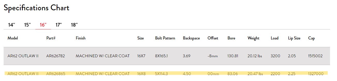

    these: https://www.americanracing.com/american-racing-outlaw-ii
    specs (highlighted yellow):

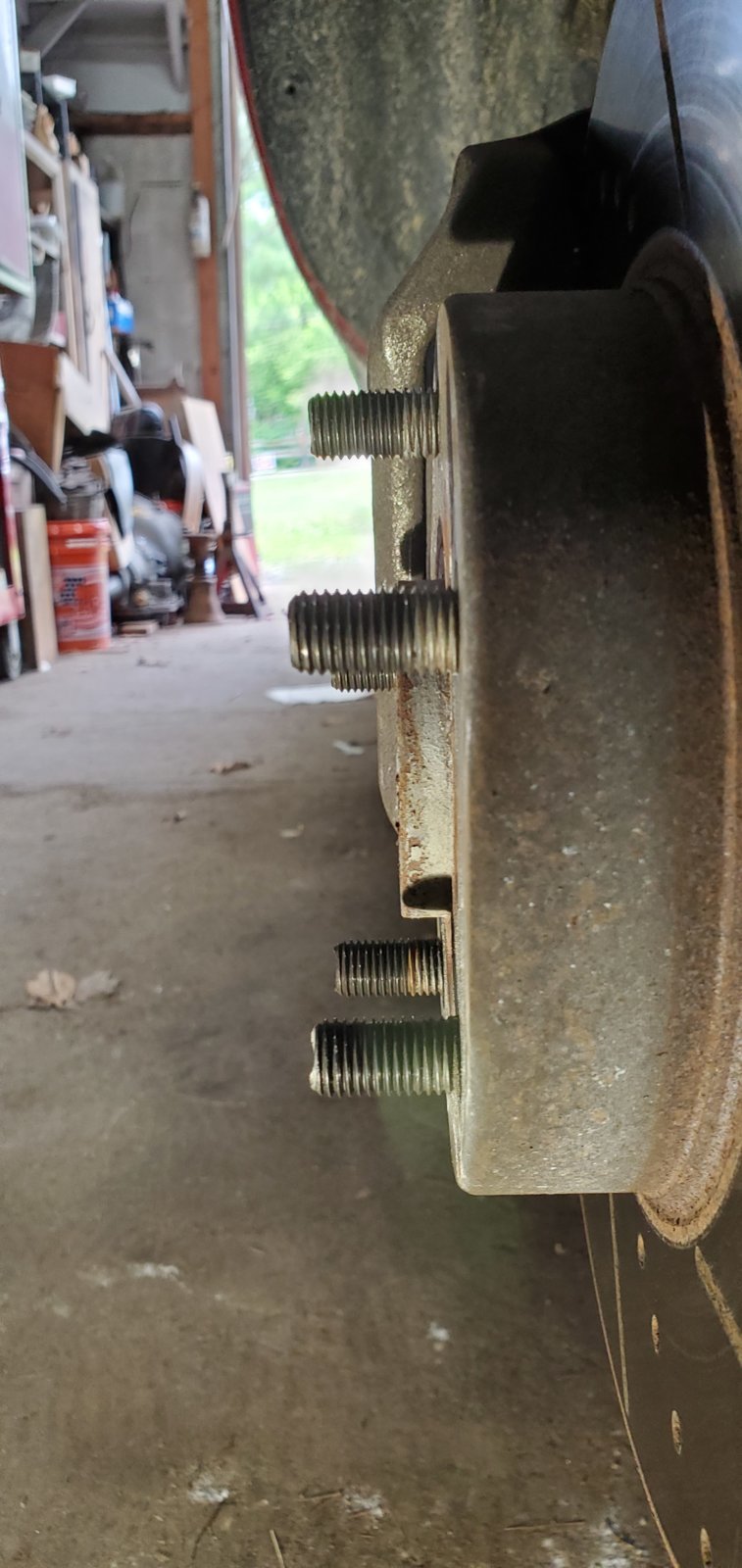

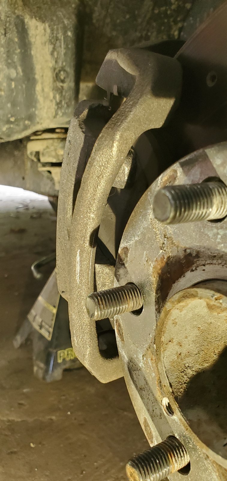

    I got them to fit with 265/75R16s, with no suspension mods but in the front I had to use a .5" spacer and take a little off that bridge you see in the photos. It's 85-90% of it's original thickness.
    Anyways, I'm not safety wise concerned, but would prefer just having the rims mount up. Thought someone might have done a front caliper swap on the 2nd gen 5 lug, have you heard of anyone doing this? I like the look of the calipers on the 6 lug, figure this weekend I'll pull a template of the mounting holes, go to a part store and see how they line up.
    What are your thoughts? Any advice? Nice truck you've got yourself; looking forward to checking out your build in greater depth!

    Unfortunately, most of the front brake swaps are for the larger LS460 calipers and IS-F rotors and require at least 18" wheels. What you are running into is with the design of the wheel, the mounting seat is not much further back than the disc of the wheel.
    Nevermind, just saw your other post and saw that it's the seat that actually hitting the caliper. Wheels designed for cars tend to fit the 5-lug setup better as they are built with the smaller clearances in mind.
