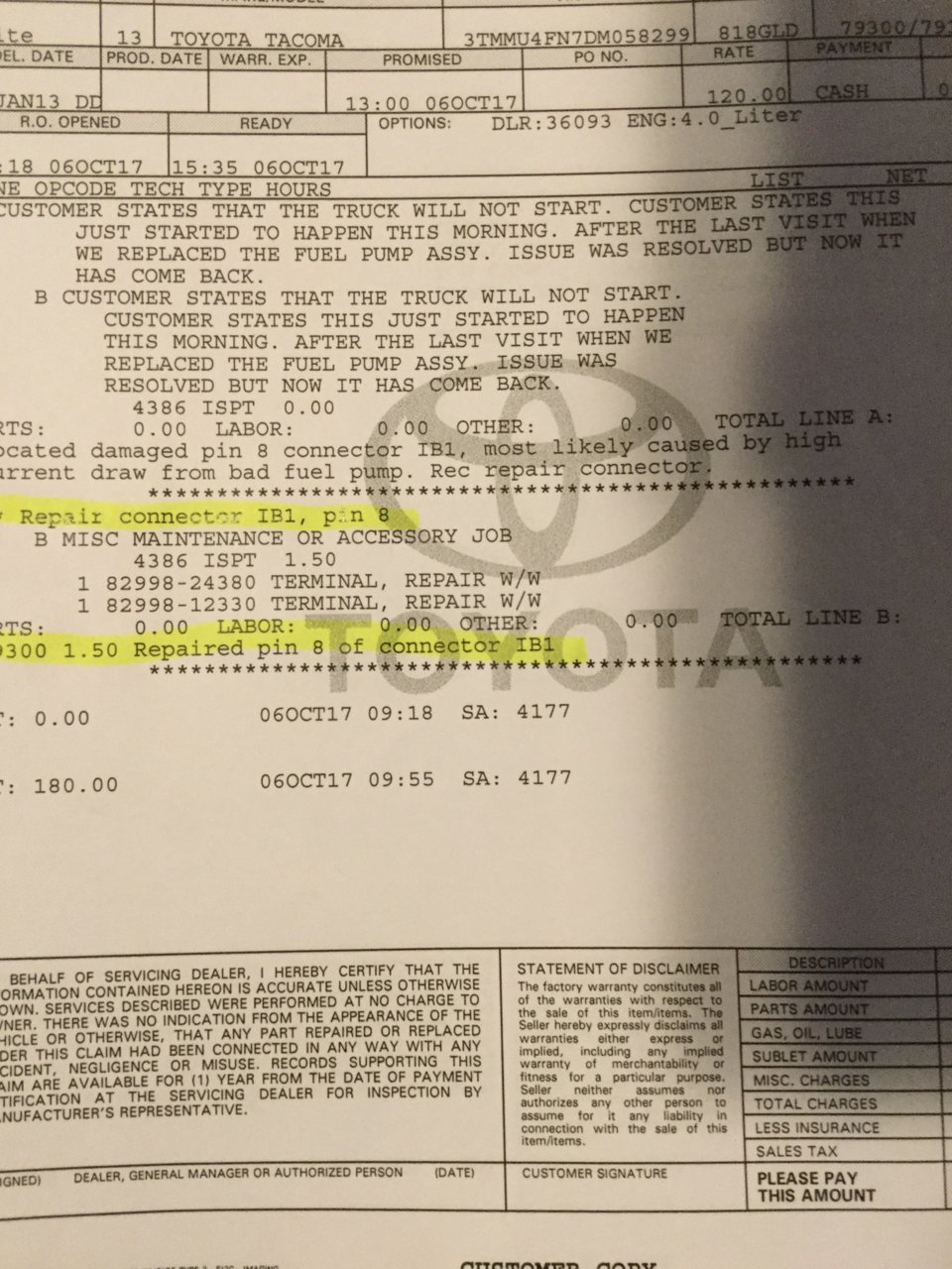

    Turbo-Taco
    Turbo-Taco Well-Known Member
    Aug 22, 2013
    #110941
    464
    Randy
    Portland, Oregon
    2024 Toyota Tacoma SR5
    So I had something very similar happen to my truck. Went to the store shut it off came back out and nothing, turned over but no start. Tried again in about 10 mins fired right up. Happened again a week later, went to the store and came out and nothing, had to have it towed in. Bad fuel pump was determined to be the cause replaced under warranty and all was good. Two weeks later went to start up first thing and nothing, would not start. Tried hitting the gas tank with rubber mallet and all, nothing. Another tow back to the dealer. This time took them a couple days but the found a burnt pin 8 in IB1 connector in the wiring harness to the fuel pump. Heres a pic of the invoice maybe it will help. Good luck.ED4B8A66-B3E6-444D-832F-AA7168C3AD7F.jpg

    2012 PreRunner Double Cab
    They just called and said I have a burnt wire. 300 to splice it or 2500 to replace the whole harness. I guess it’s burnt out under the dash.
    I’m just glad I’ll have my truck back soon. Something under the dash is something I would have never thought to check.
