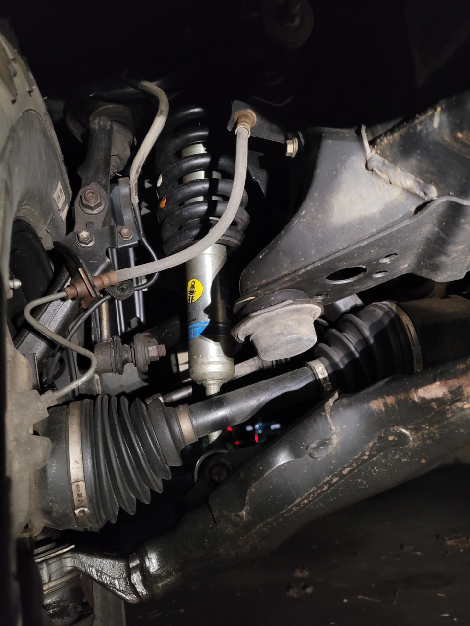

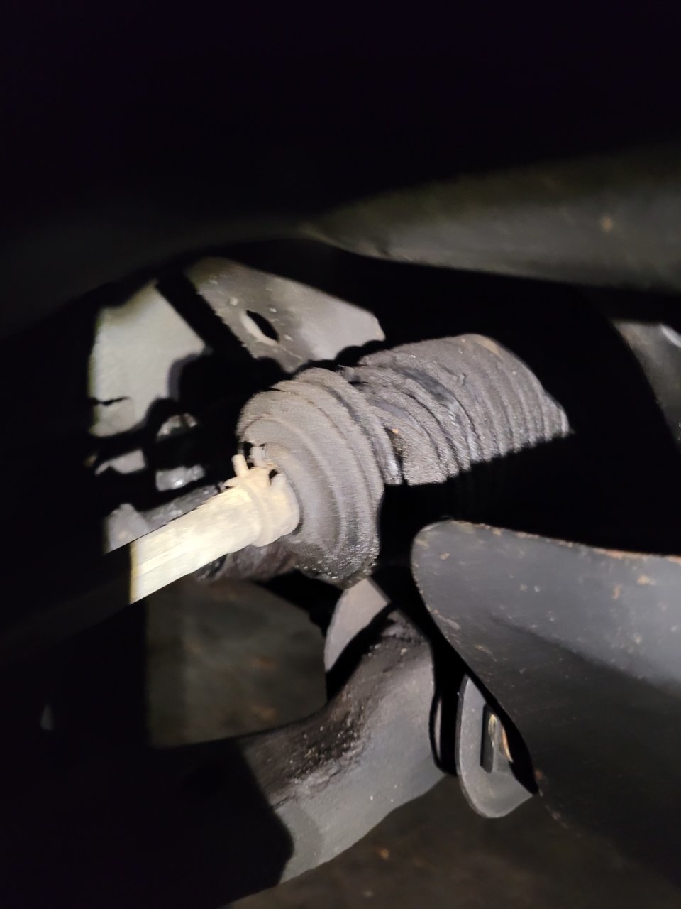

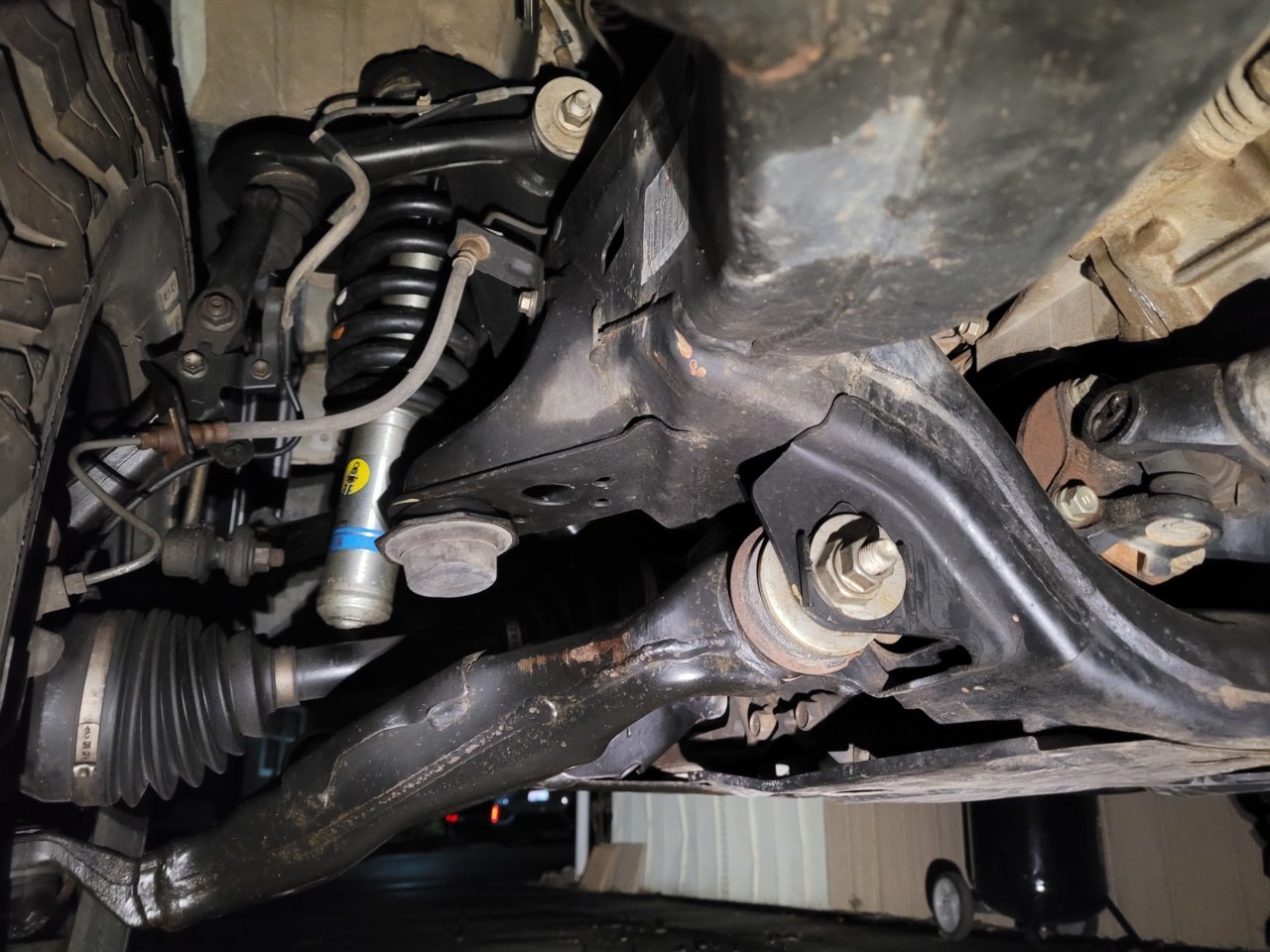

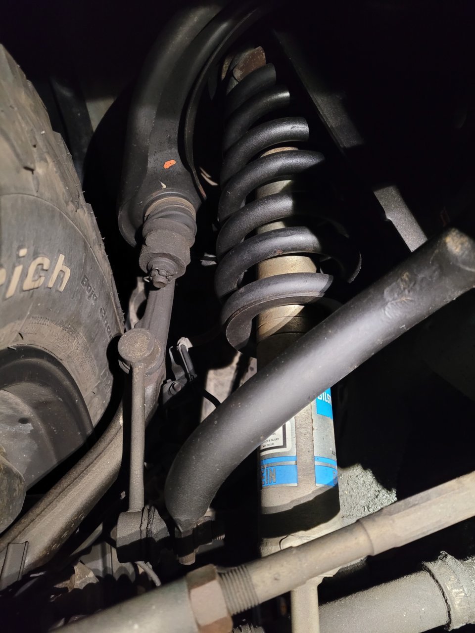

    The front end needs a major overhaul in most of the suspension components and a few others. Current fixes to pursue are as follows:
    20221104_203541.jpg 20221104_203549.jpg 20221104_203556.jpg 20221104_203615.jpg 20221104_203629.jpg
    1. Existing suspension is far too stiff and bushings are deformed. - Needs new suspension.
    2. Rack and pinion has failed. Power steering system will not hold fluid. - Replace rack.
    3. Upper and lower control arm bushings, ball joins, etc. are questionable at best - Replace or rebuild.
    4. Clutch is slipping. - Needs replacement
    5. CV axle boot on passenger side is torn/gone. - Needs new CV axle / CV Reboot.
    6. Sway bar bushings are deformed. - Replace bushings/Remove sway bar completely.
    7. I am bored. - Needing something to take apart and rebuild.

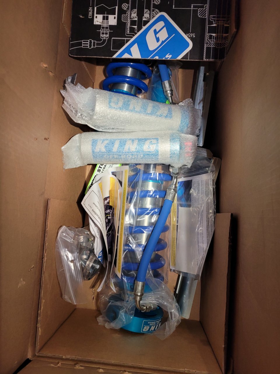

    1. I have decided to get a suspension system that not only can take a severe level of abuse, AND be rebuilt and serviced, but also comes with a little bit of... how do the French say? "FUCK YEAH". Between Fox and King, I have always preferred the later, and their HQ is a 45 minute drive for me when I need these things serviced. The spring rate on these King units are a bit stiff for the 4 cyl regular cab I have, so I may have to purchase another set of softer springs.

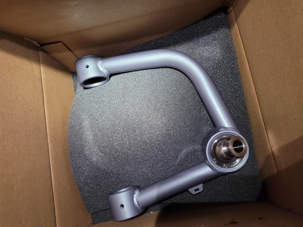

    2. For the upper control arms I am using Total Chaos stock length uppers with poly bushings and uniballs. These are necessary for the King suspension, and I purchased the suspension and the uppers direct from Total Chaos. Total Chaos is also about 45 minutes from me.
