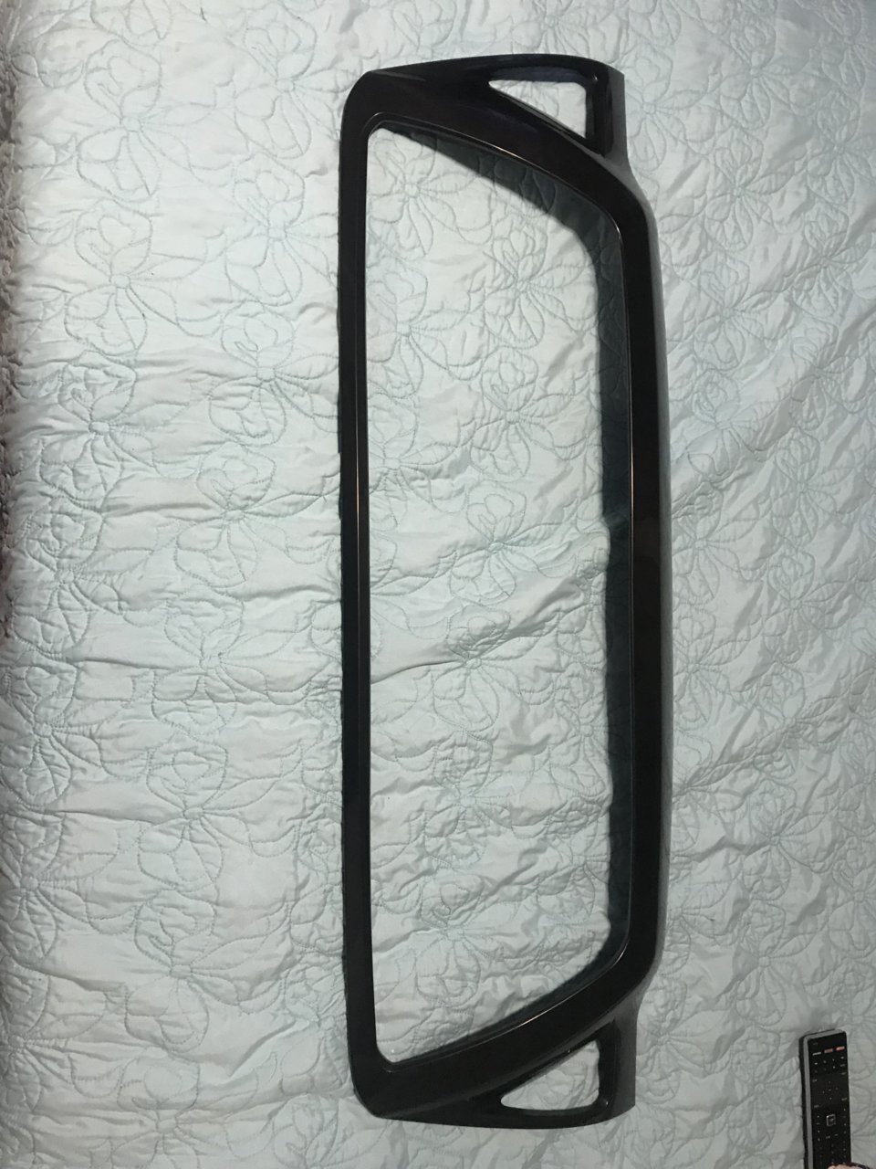

    Sure here is the “front” pice.. Excuse the bedding, lol the old lady won that war...

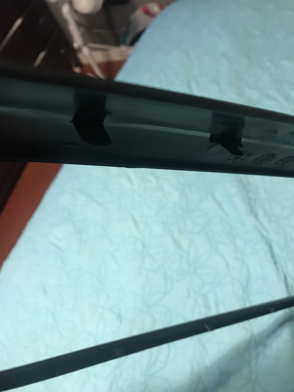

    Here are the tabs...

    I can't understand what you're trying to say, but I can tell you the '05-'11 grills are not made to come apart. The tabs are melted over.

    interesting. I was planning on finding a 2nd gen grill to take the middle grill piece out and just put it in my grill.
    Not possible?

    You could possibly grind away the melted tabs and then put the 2 pieces together with panel bond adhesive or epoxy.

    yeah OP if this grill wasn’t meant to take apart like this.. then you have a broken grill. You’ll have to start bonding things to keep it together.

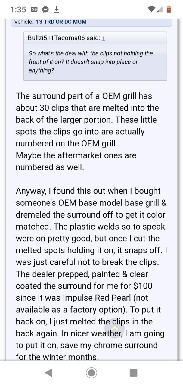

    Yes I can attest to that. I took one apart & put it back together to color match my impulse red 2006. Toyota didn't sell one in that color. So cut tabs & used soldering gun to melt tabs back on.
    I never saw one come in two pieces OP. Did you buy it from a dealer?

    No it looked factory. I took the surround to Toyota to color match the paint. It was all in the back of the grill and stayed together fine. No issue just took my time.

    This is from when I explained it back in the day ...

    OP I think you need to melt the tabs back together for the main grill and surround. Then clip the surround back in, if I’m reading this right
