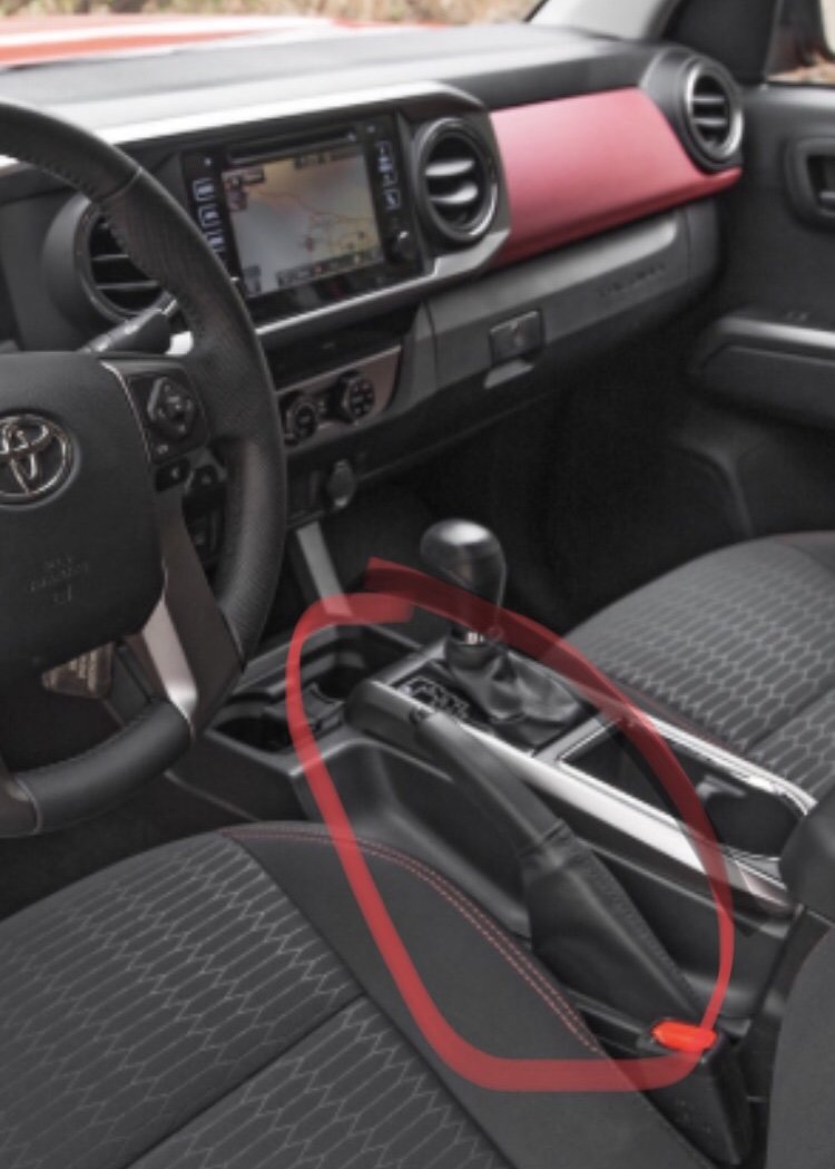

    I guess I should have been more specific, but the hand lever between the seats like 3rd Gens. I've seen those pull type hand brakes.
    I have yet to see any. Do you know if they have the hand brakes like new tacos?
    That is on a 3rd Gen. I'm curious, if that was available, would anyone be interested in doing the swap?

    The Gen 2 trucks with handbrake have the pull-out lever under the ignition switch. The funky little cubby on footbrake trucks is where the Gen 2 handbrake lives. It’s like previous generations of Toyota trucks have had before it, including Gen 1 Tacomas.
    It’s not a pull-up handbrake like the Gen 3 trucks and so many other vehicles.
    (But it’s probably a lot easier to imagine a conversion to the pull-lever kind of handbrake!)

    The cable for the e-brake on all 2nd gens get routed to under the center console so I’m sure someone could fab up a mount and lever to relocate it from the pedal to the center console area pretty easily.
