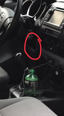

    Be sure to cut a little at a time. Smaller hole for less road noise. Also, if you do the twin stick FJ case at the same time, take caution when cutting for that too. On my first truck I cut the hole too big and eliminated one of the mounting holes for the factory parking brake cable mounts and left the foot parking brake feeling soft. On the second truck I was able to cut a lot less and kept both holes
    First truck.
    before being cut

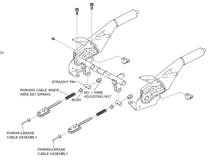

    Doodle....

    That looks GOOD! That’s basically what I did. Hard part was making it all bolt on and to fit under the center console. Lots of stuff had to be removed/moved. Plus all the other sticks that are in the way.

    Which hand brakes are those? Did you edit/reverse the right one? That was the most involved with cutting and rewelding the brackets to be reversed.

    FJ ones...it's just a drawing I made...
