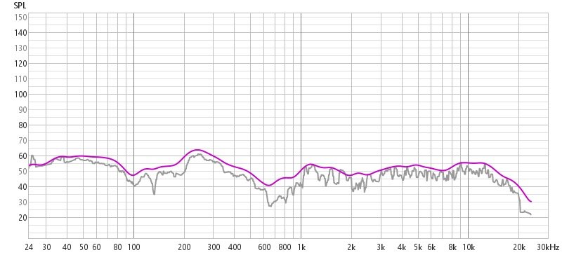

  18. Feb 8, 2024 at 1:46 PM
    #38
    ac2ndGenTacoma
    ac2ndGenTacoma Well-Known Member
    Feb 28, 2021
    #357773
    67
    Turns out RF woofers take a nose dive at 625HZ, I still like them tho, if I had a DSP when I brought the Infinity comps I may have kept them. Purple line is after adjusting the crossovers. If you're going to get new speakers DSP is required for any access cab where your head is between a tweeter and the rear glass - just makes for a bright truck.
