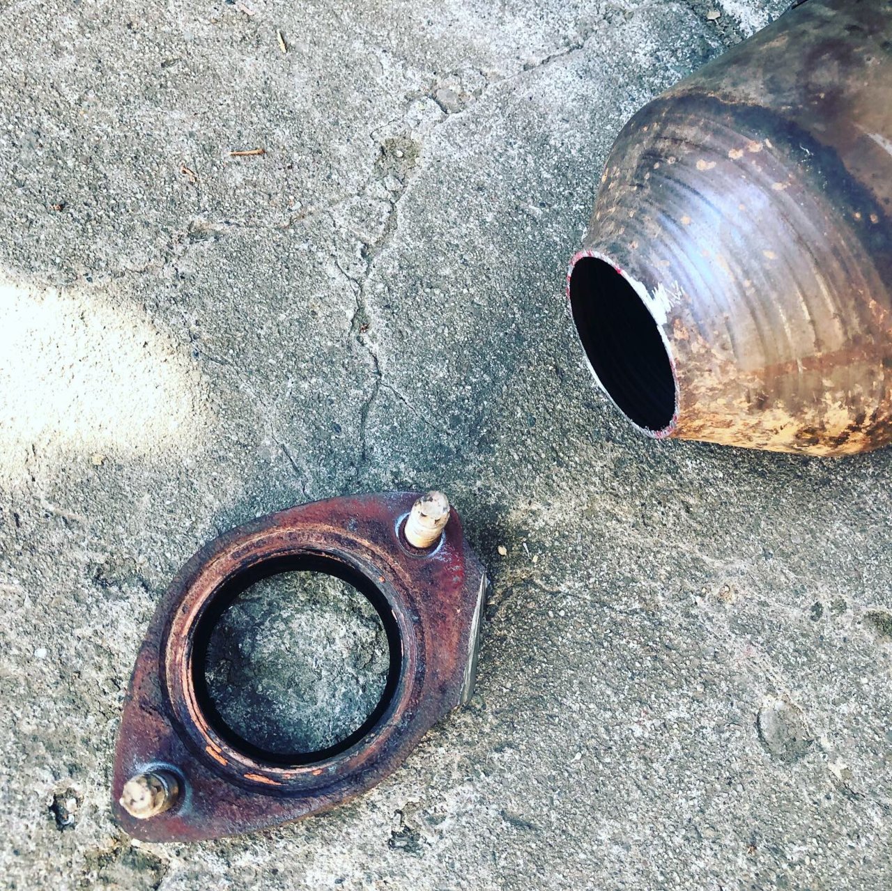

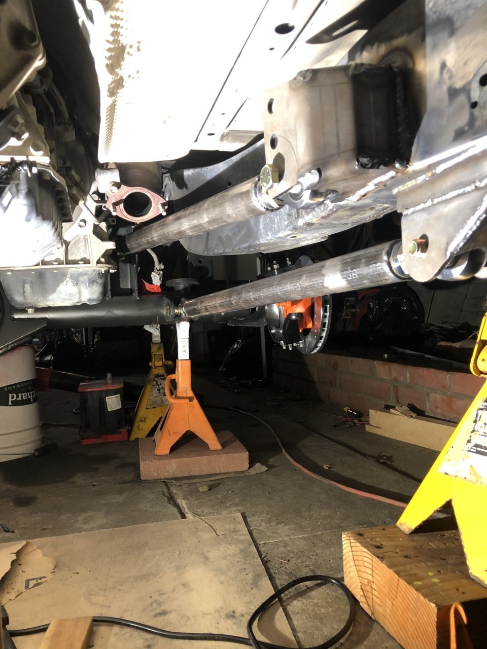

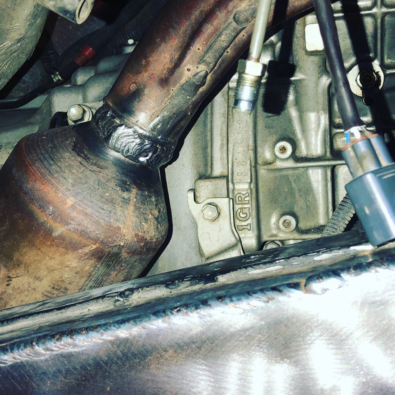

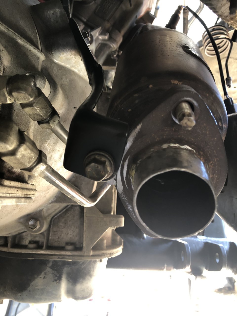

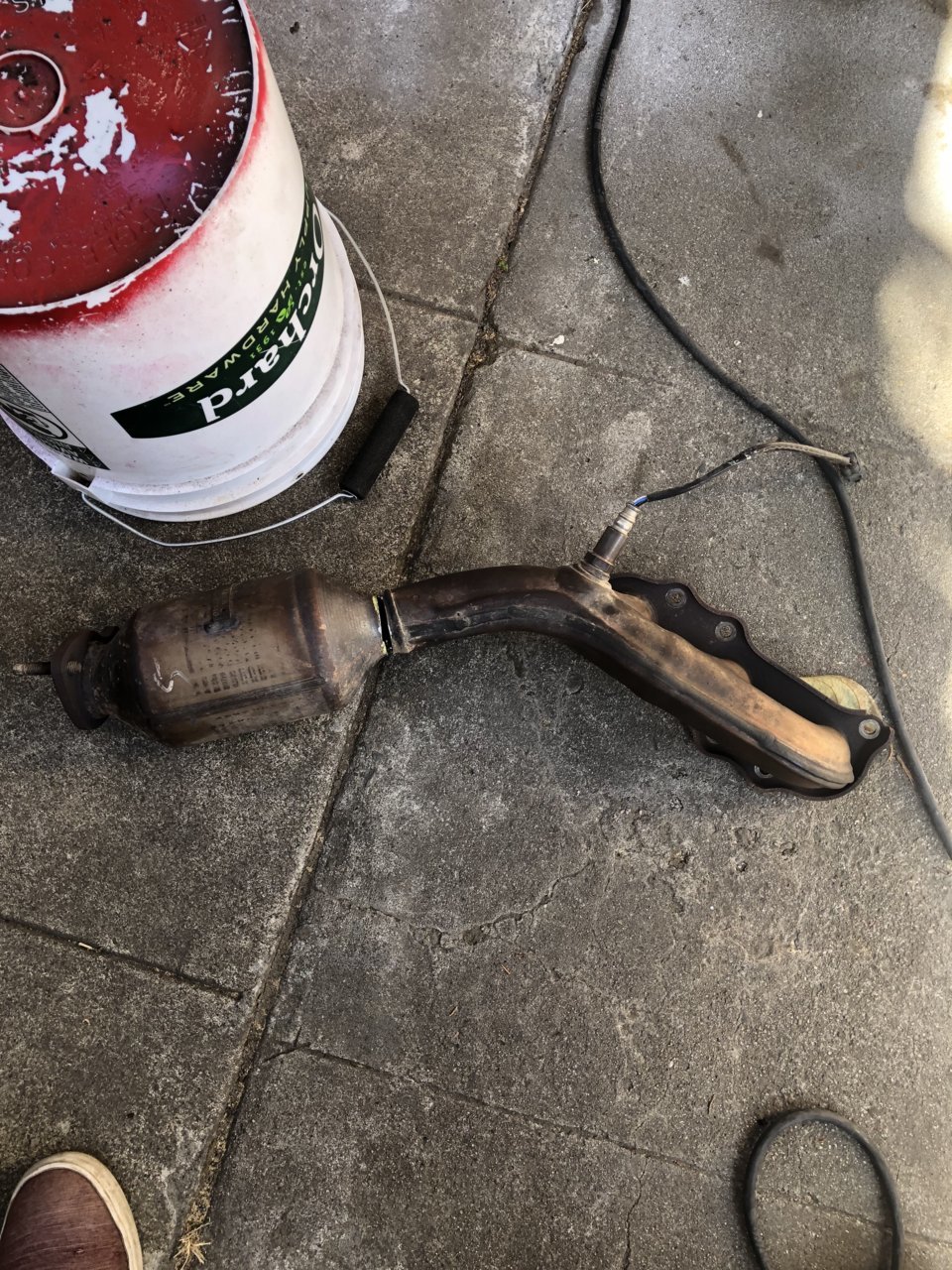

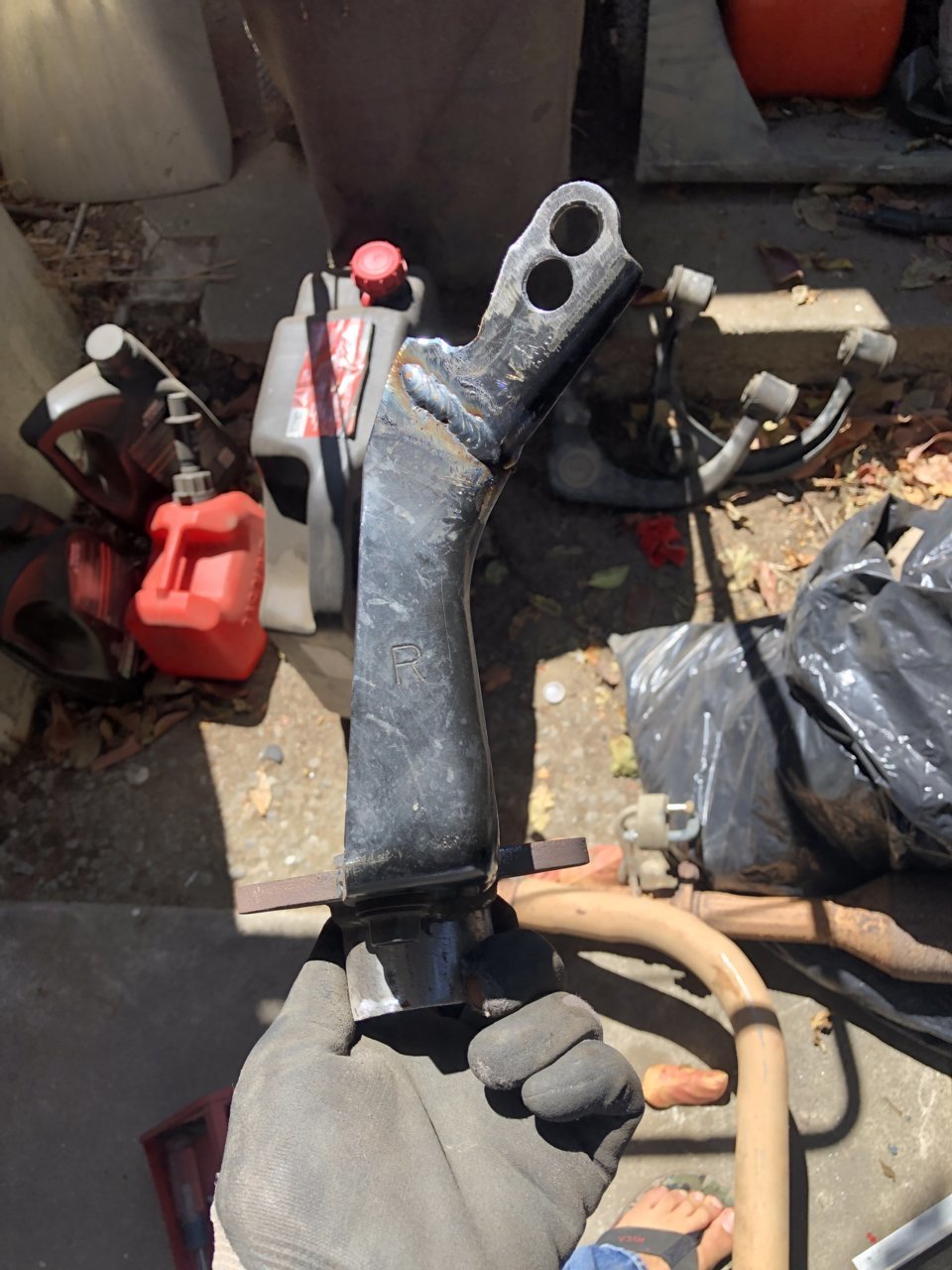

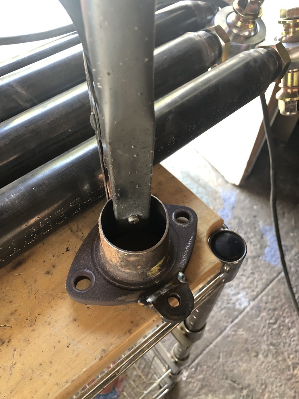

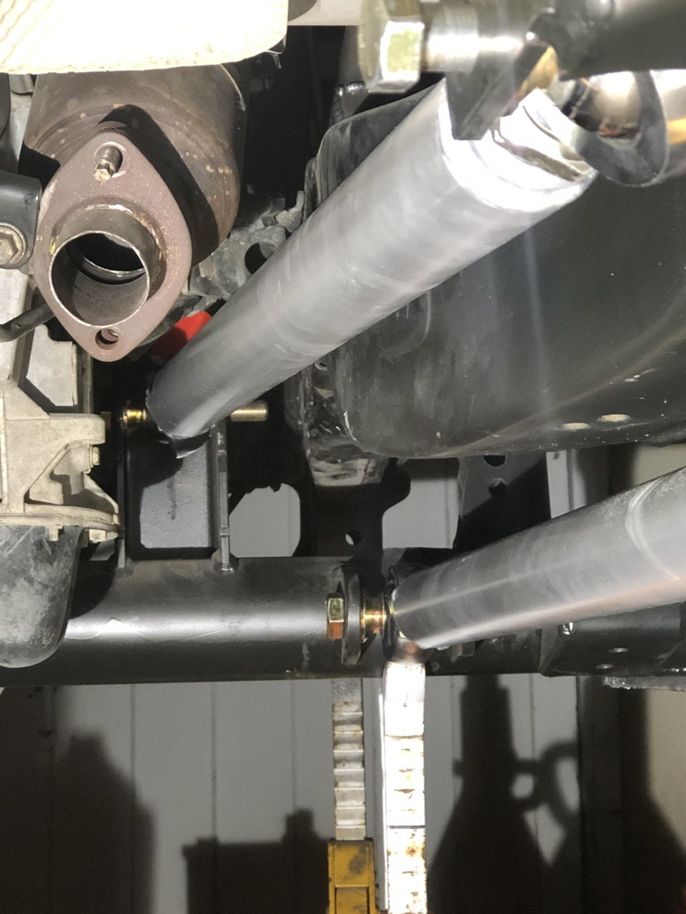

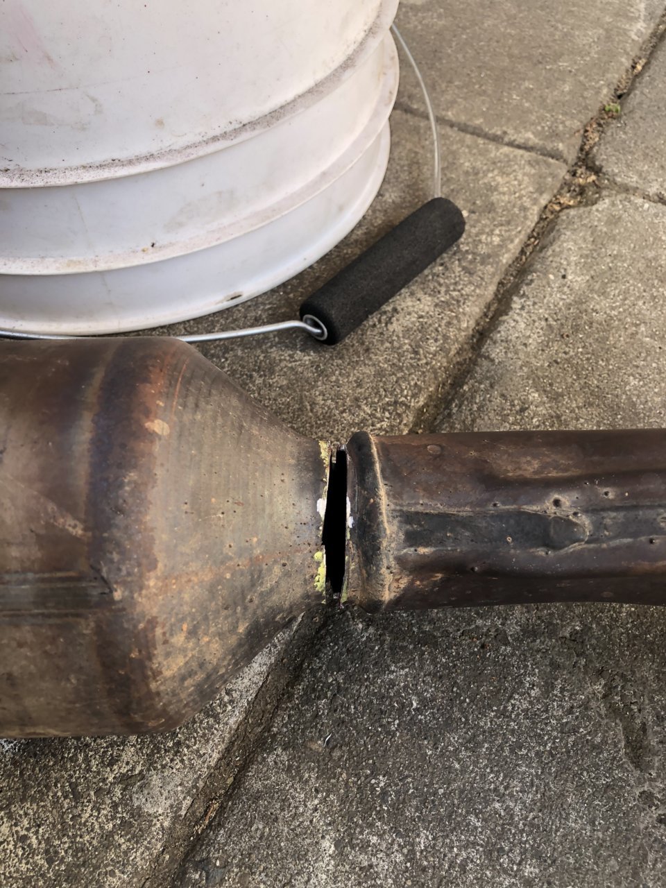

    I thought I would make a little thread for this mod I did when clearancing for my upper link. This will definitely give 1-2” of clearance for uptravel/full bump depending on what axle housing is being used.
    -the header flange sits horizontal before modification.
    -make a mark while the header is still attached to make sure the cut will bend the header in the right direction. Cut 2/3 through.
    Cut the flange off below the cat and cut off the 14mm bolt mounting bolt tab (save for rewelding)
    -bridge weld the expanded gap in the neck above the header
    -mock up the header back in place and mark where the flange will face and locate where the 14mm mounting tab will be welded
    -modify the header bracket by cutting and then bending the bracket to the right angle and drill a new hole at the proper location. Only one bolt will fit unless you decide to lengthen the bracket. I opted not to. Not worried about strength issue.
    821F5FC7-D48F-4B14-AF5D-59299D140C43.jpg 83D1A7EB-657A-4A43-AE7F-AAB015603483.jpg
    Hope this helps some peeps keep their ride height lower.

    Lots of clearance afterwards

    Out of curiosity when you did your build did you consider running the link on the drivers side? Assuming there is more in the way with the t-case and driveshaft.
  5. Nov 5, 2019 at 10:38 AM
    Pdugan6
    Pdugan6 [OP] Well-Known Member
    Aug 11, 2013
    #110271
    1,489
    Patrick
    Sunnyvale California
    3 link solid axle 2011 Tacoma 4x4
    No room on diff side to do it.
