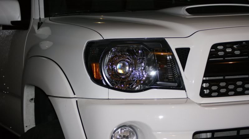

  9. Mar 24, 2011 at 2:44 PM
    #49
    TastyTaco
    TastyTaco Well-Known Member
    Mar 4, 2011
    #52312
    258
    Nick
    Vancouver, WA
    2003 Taco 3.4 DC TRD
    3" Lift, BFG K02 285/70/17, Pro Comp 45 Series 17x9 -6, ACME D2S Retrofit
    I have it post in another thread but here it is.

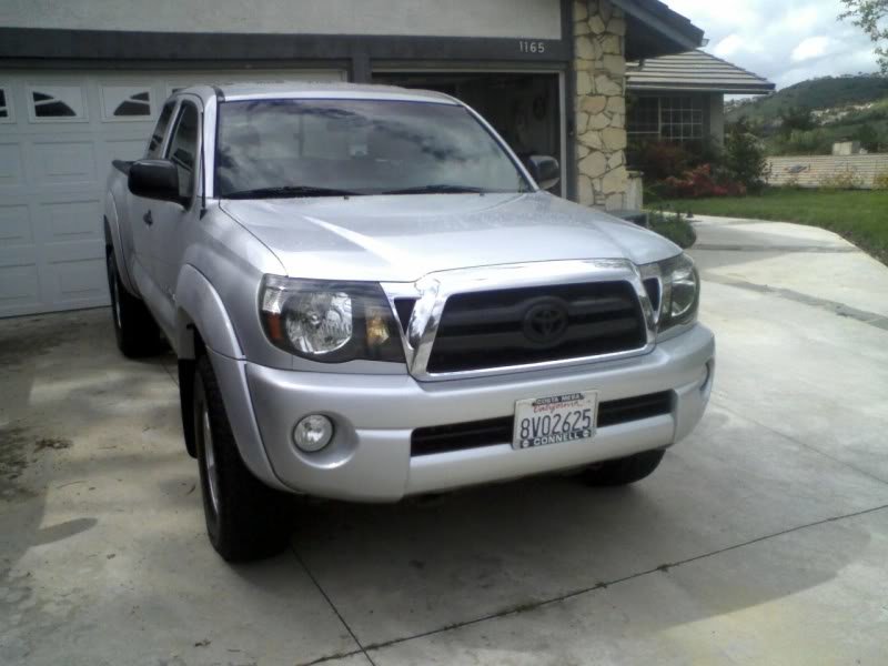

    Thanks for the help. I dont know if I would have ever found that 4th hard to get screw. Anyways this is how it turned out.
