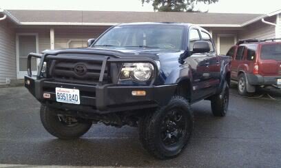

    Looks nice!
    I've been very happy with mine since I did it a few months back. I noticed you blacked out your parabolic reflectors for your turn signal/parking lights... are they still bright enough?

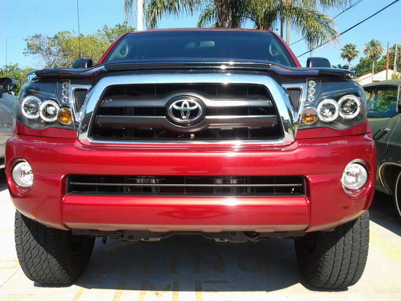

    nice right up and pictures.. I was going to do the same thing.. since my taco is a 06 my running lights are always on.... my lens for my running lights were getting burned ... so, after checking prices for one lens and then have to heat them up... take them apart.... paints... etc..... I decided to change the whole look..... I should have taken pictures but, it was only about 20 min. to do both lights.... btw...you can see my 2 stage 4 liter each HHO

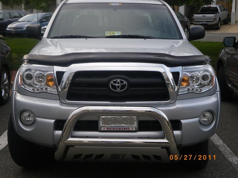

    Good pic Anthony!!
