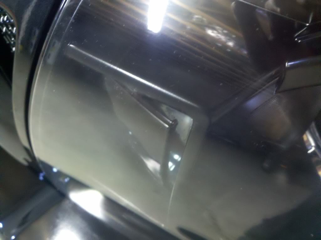

    I hate washing my truck! All I find is new scratcheIMG_20120424_124142_d9591bfe4473c43f6ef36127fa4131a8a0e52832.jpgs and new problems.
    What do I have to do? Open it up pop it back on maybe use some glue? Then just reheat and put back together? Buttle should be good and plentifull

    Help? Its been about 3 weeks and this just now happened.

    Do you want to save the lense thats loose? Or remove it?

    i want to save it. where it aped the reflector off behind it. it pulled some of the chrome off. so i definetly need to save the piece

    with saving it, i'm not the guy to input on that, but i have a killer technique for removing it without taking apart the whole assembly. Sorry i cant be of more help to you. Good luck though.

    You will need to open it back up to put the lens back in place.
    One of those things that you just need to suck it up and do it.
    When you pu tthe lens back in you might want to use a dab of clear silicon caulk to secure the lens. I sort of wish that I did after reading the posts about the lens falling out after reassembly.
