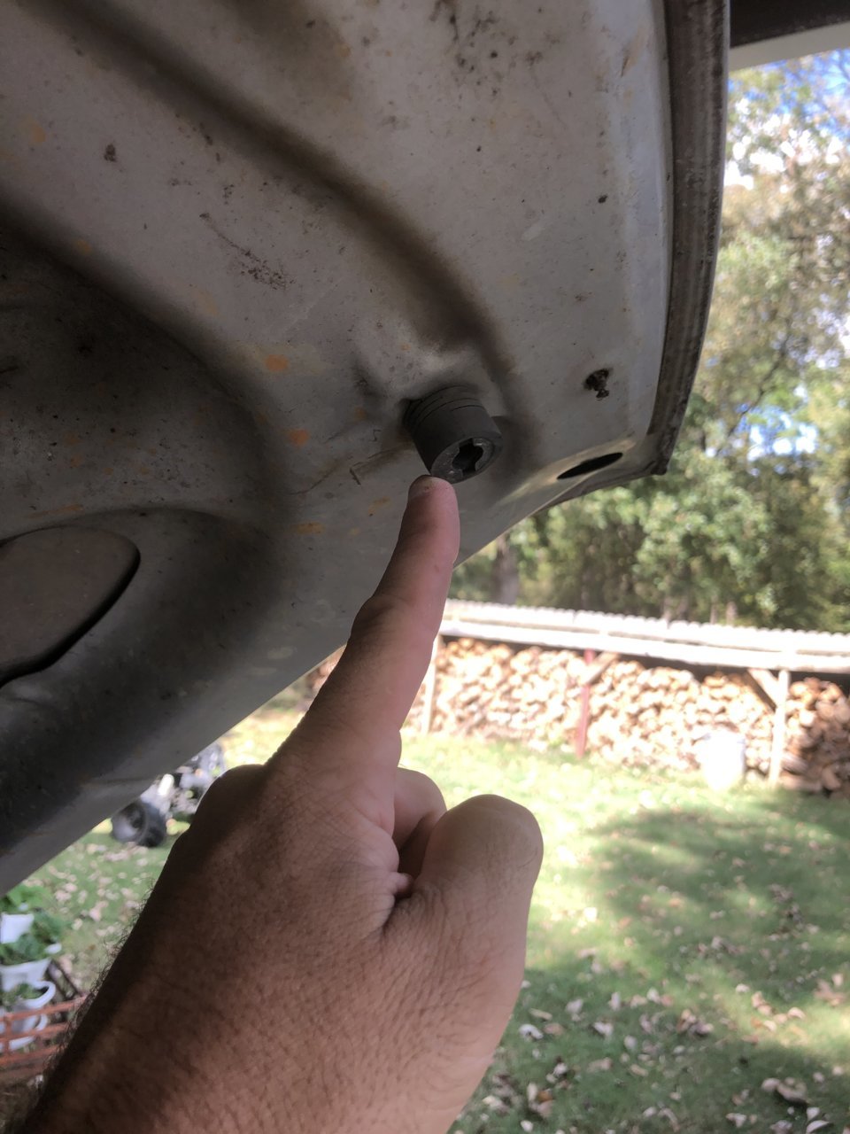

    There will be a little vibration in your hood. You may try adjusting the rubber hood “bumpers”. You can screw them up and down to adjust the tightness of the hood.

    my unskewpt hood danced too until tightening up the bumpers........
